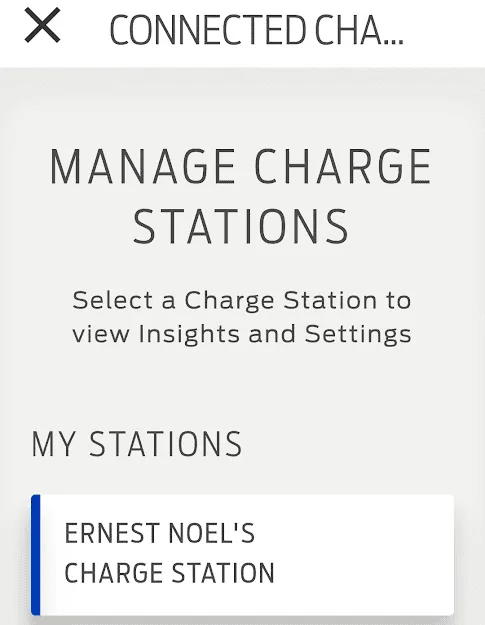

Today I needed to restart my FCSP (breaker off/on), it had not been reporting up to the mothership since last Friday afternoons charge session had completed. No charging was done over the weekend since we used the Mrs. car.
This is an image of my station while it's connected to the network and sending data to the Ford, the Ford Pass app retrieves and reports our stat's in the app, when it is not connected, a red instead of blue bar shows on the left the account name.
Ford F-150 Lightning Charge Station Pro Problems 1667853778420
There were no changes to the firm/software, must have just needed a reboot..

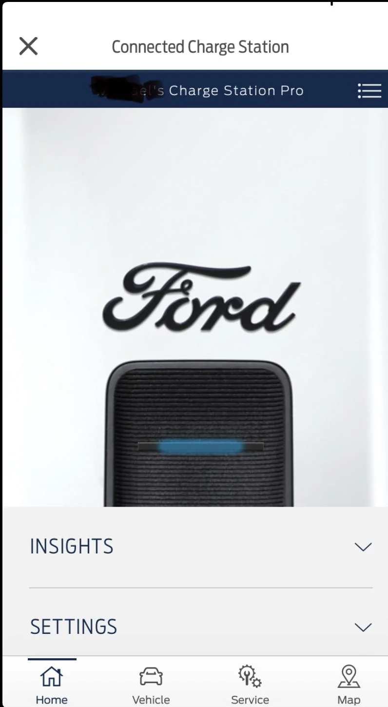

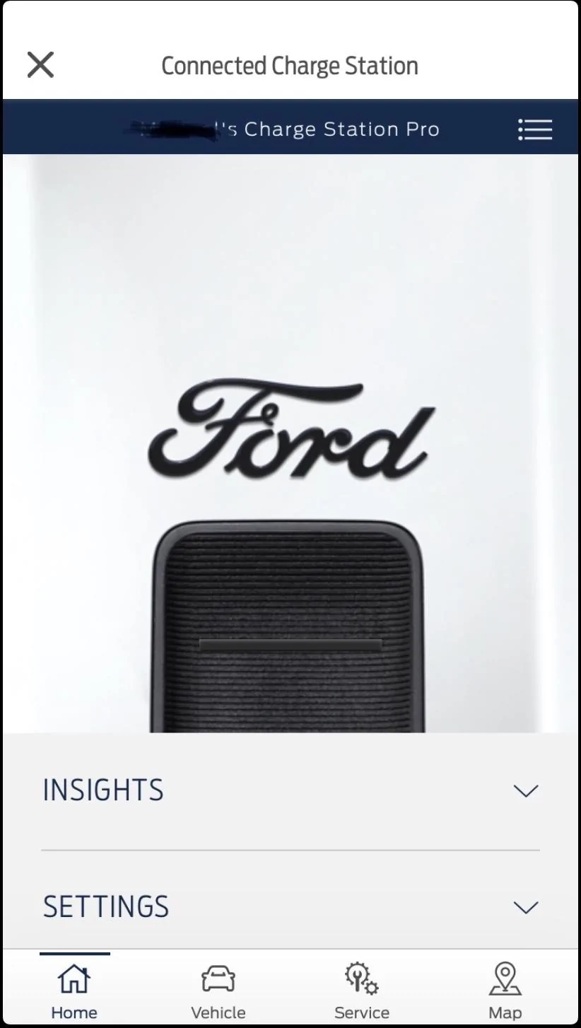

Same with mine….thanks for the heads-up!
BTW, I was also able to tell my FCSP was offline by looking at this screen (photo below)….the usually is a blue bar like on the charger itself…although the indicator light on my charger is BLUE, my iApp is now showing BLACK before the “power breaker” reset…..
Ford F-150 Lightning Charge Station Pro Problems D5A08628-C505-4EE0-91B8-87F94C09119F
After the power reset……it took about 5 min. to show the below change in the app…….
Ford F-150 Lightning Charge Station Pro Problems AC9C8803-D79D-42E8-B31A-2C3233416483
Yup, that was my first clue something was amiss.
