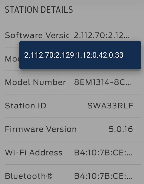

OK. I finished wiring up my Charge Station yesterday. My software version was 2.112.64. My connected charge station screen in FordPass still shows this software. If I go into the Charge Station Pro app, it says my software revision is 2.112.70. I tried using the charger this morning at the 80a setting and it stopped twice, saying it couldn't charge.
What is the latest up-to-date software revision, and at what revision does the full charge rate work without interruption? I don't plan on leaving it at 80A, but I'd like to know it's there if I need it.
This is the current version which you must see via the FCSP setup utility "ABOUT" section.

This was what I had on day 1 (9/30/22) of operation, but it updated to the current version overnight, if it's been a few days since yours has been up, and not showing the update, disconnect truck, turn FCSP circuit breaker off for a 15 minutes, then power up, and leave it be for the day, at some point, (possibly that evening) it should update.

Well, that seems to be what I have too. I'll try charging at full rate and hope that it doesn't fault again.
