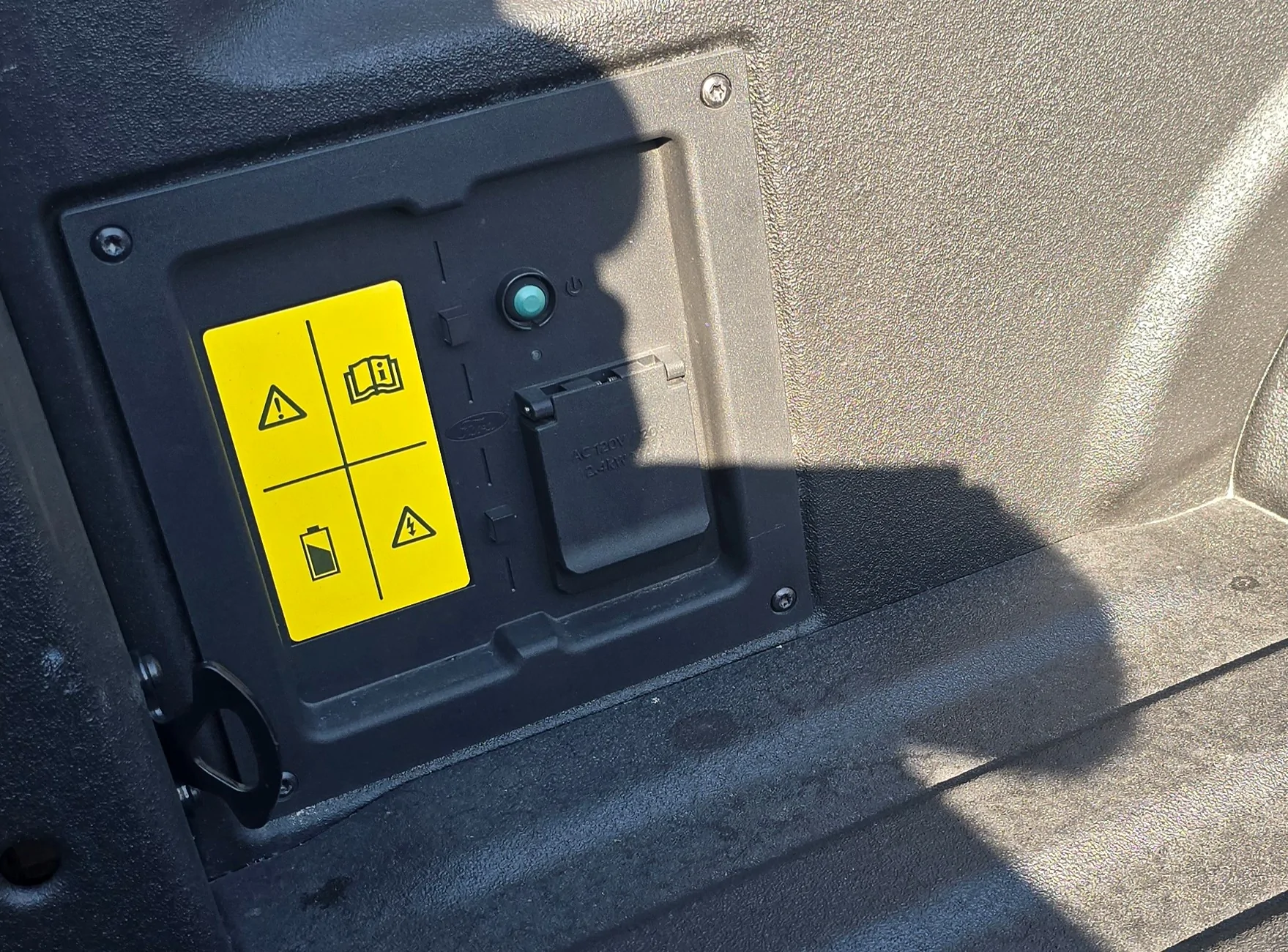

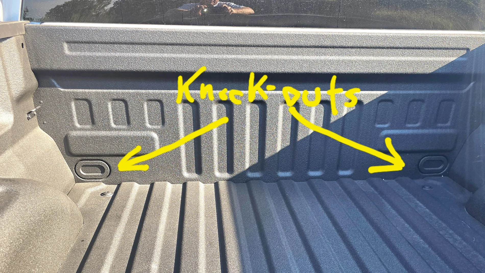

One option for the charging receptacle in the bed may be to use the hole created by removing the knock-out port in the bed between the cab and the bed, and running a corded receptacle so the bed doesn't have to be cut. A lot of people don't want to cut a hole in the bed for something that may not live up to their expectations. Also an adapter plate could be made to accommodate a receptacle. Or, the receptacle could extend up and over and be placed in a receptacle box that attaches to the inside of the bed where the bed anchor point resides. All of these options could be removed and the truck restored to original condition. See pictures for possible receptacle mounting locations.
Also an insulated flexible pipe could be carefully routed between the cab and bed through the knock-out port.
Ford F-150 Lightning Charging While Driving Works w/ Gas Generator in Bed (Range Extending for F-150 Lightning) - Testing 20250915_085533
Ford F-150 Lightning Charging While Driving Works w/ Gas Generator in Bed (Range Extending for F-150 Lightning) - Testing 20250915_085600
