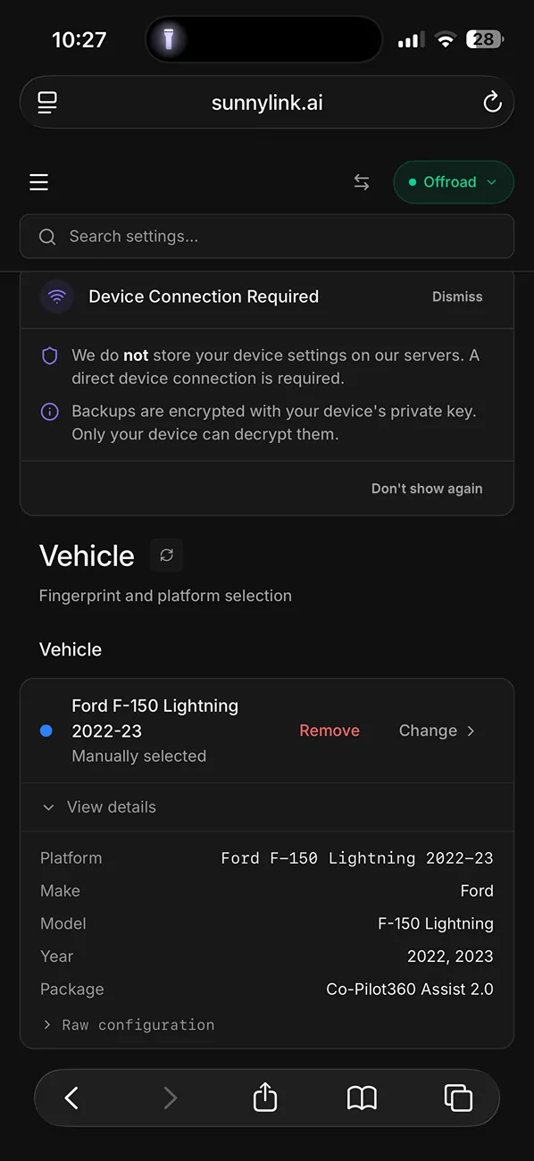

When you have the "start car" message, can you access the settings menu?
If you can access the settings menu, manually choose the Lightning as your vehicle.
Yes I can. I was able to select the vehicle through sunnylink as well.

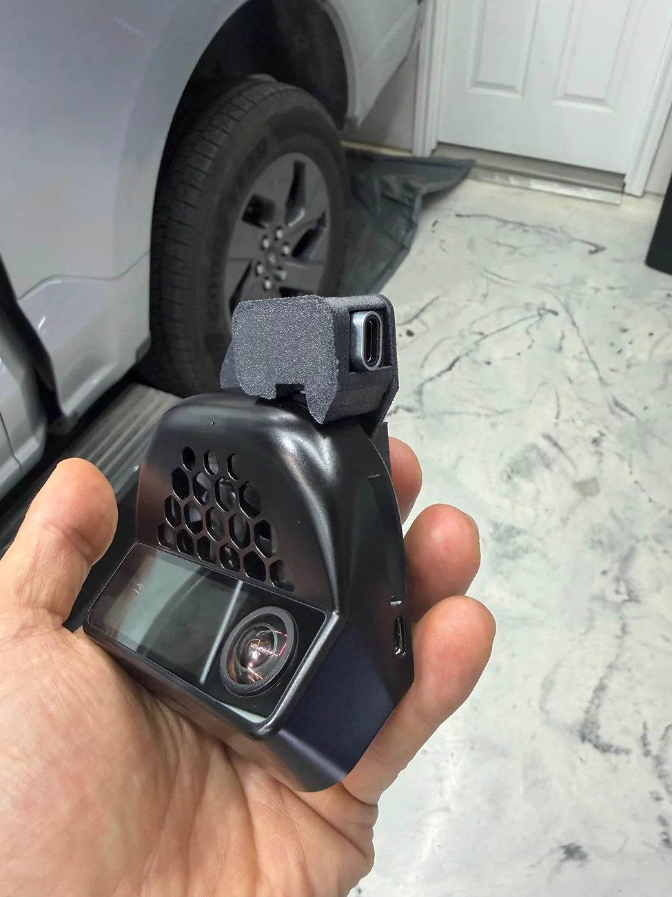

What you’re explaining on the usb flipping is what I did.
On the resistor and lightning and comma symbols, I’m not seeing those. It’s enclosed within the 3d printed case as I received it from bluepilot. Can you elaborate on that one?
i confirmed it is on the black plug, 2 plugs up from the fiber optic lines (not the gray one).

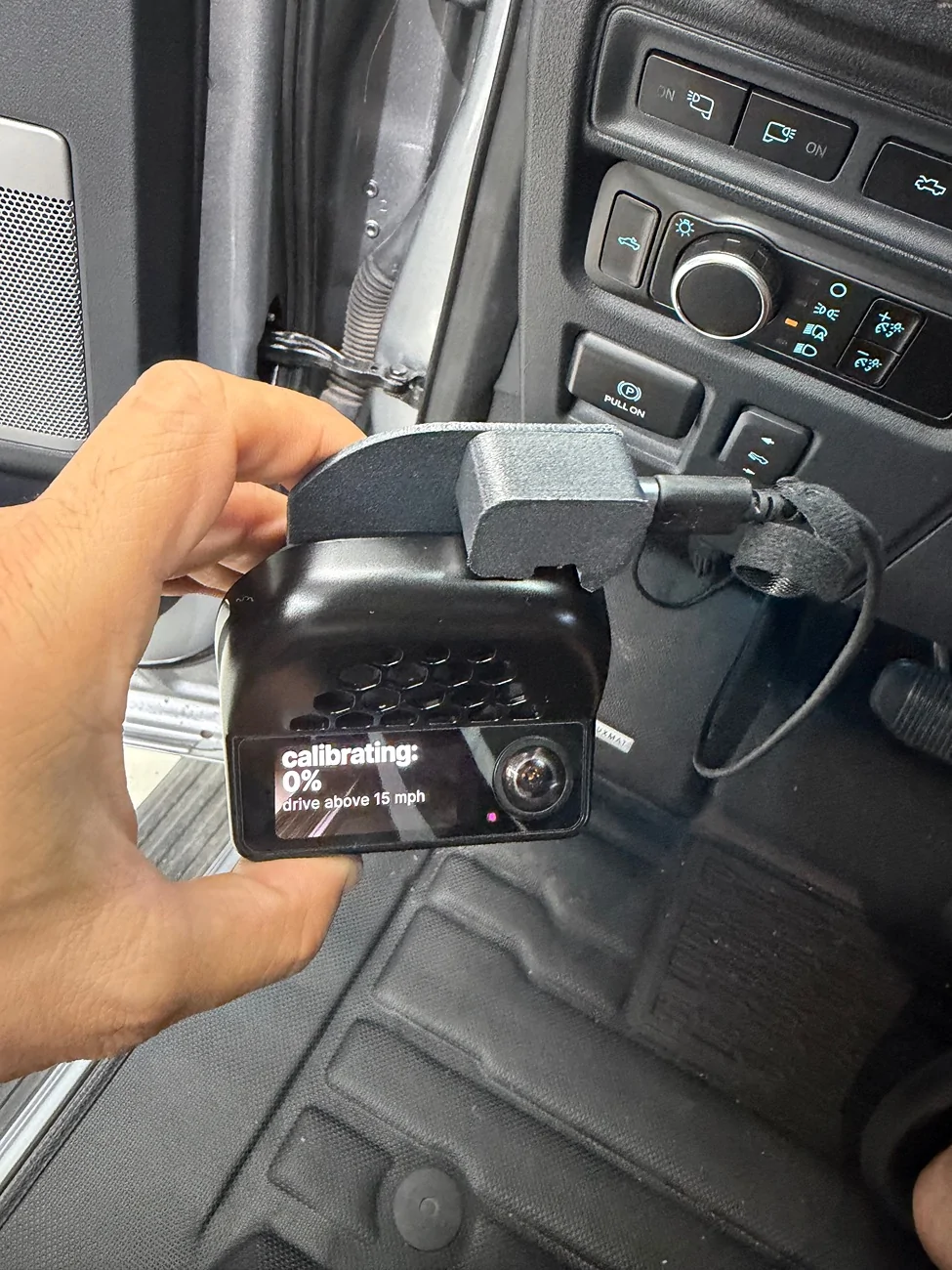

The start car message means it is not detecting the 12v ignition signal on pin 12 of the harness. Usually it's due to an incompatible USB cable (lower quality cables don't have all the wires terminated). If you are using the comma supplied cable, it could just be a bad USB cable. To narrow it down between the harness and the USB cable, hook the device up under the dash using only the short USB-C cable that comma ships with all units. You can't drive like this, because the cable is too short to reach the windhsield, but you can tell if the "start car message" goes away.
wow. Thank you for the suggestion. Tried the short usb, turned the truck on, and it immediately turned the camera on and asked me to start driving.
What usb do you recommend for the long one to fix this issue?
