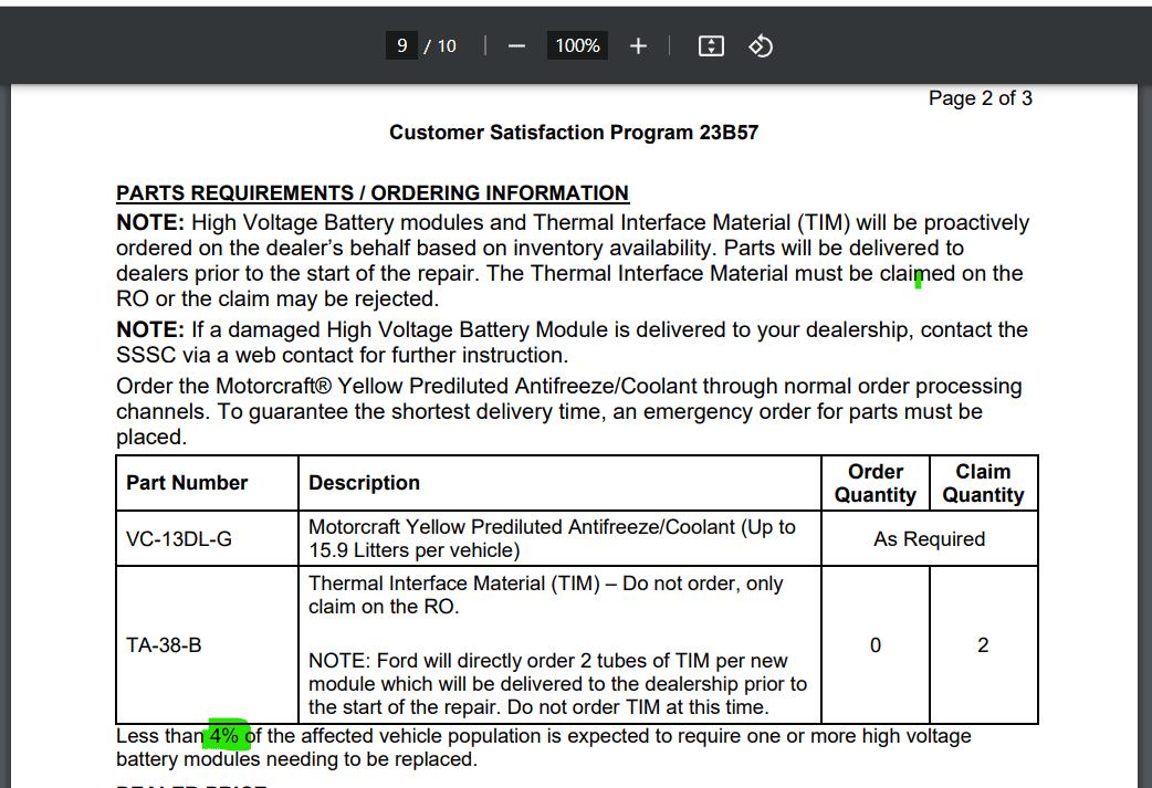

4% of 36,611 trucks = 1,464 total needing new modules, I wonder how many have already been addressed?
Where did you see 4%?

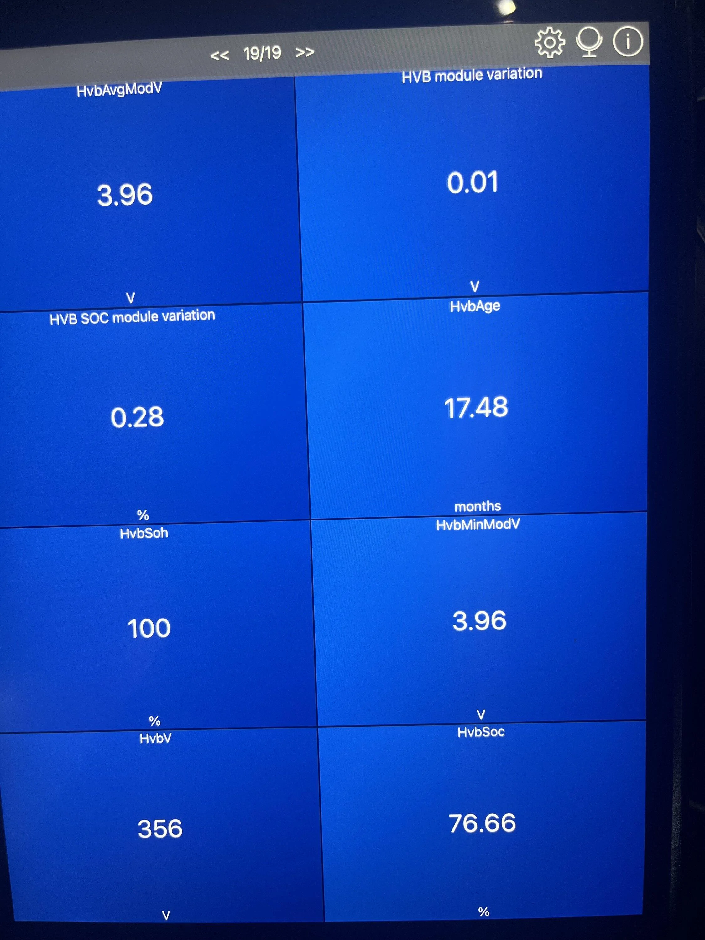

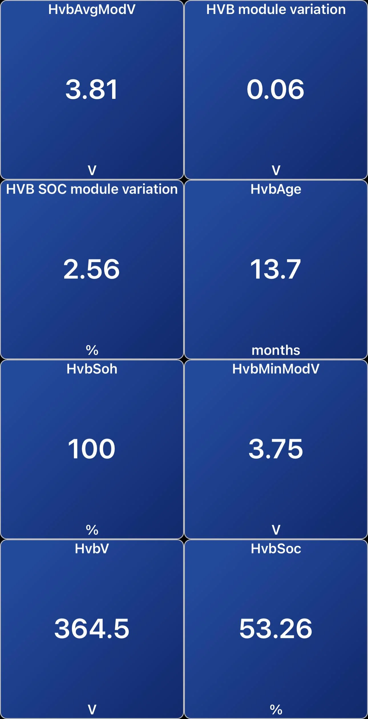

@ctuan13
Here are the readings from our 2 different trucks.
Both Standard Range batteries at 2 different SOC.
Would be interesting to know what is Module Variation that triggers the Reduced Power and what requires a PULL OVER NOW - YOU ARE GOING TO DIE message.
I need to look at Car Scanner again and see if there is a MaxModV. Obviously there is a Min, Avg and Variation so not needed but funny how the reading on the truck on the right shows a variation of 0.01 but the Min and Avg are the same
It's way down on the next to the last page of the document. The total document is 7 or 8 pages.
"Less than 4% of the affected vehicle population is expected to require one or more high voltage battery modules needing to be replaced."

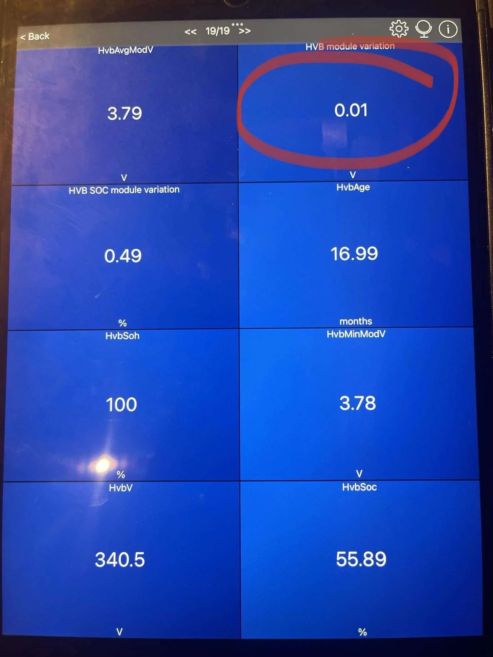

Good to see someone else's numbers! I'm curious about that as well, it seems your module variation is ever so slightly higher than mine, but I'm pretty sure it's still well within the margin for error. Do you only ever charge to 90%? And do you recharge everyday or wait until a lower SOC to recharge?
@MickeyAO we could really use your expertise here! I'm also curious if you know whether the Lightning pack top balances or bottom balances and what if any effect never charging to 100% has as we also know that is detrimental to cell health.
this is at 90% soc on display, parked overnight.
If the battery is 143.4kwh, I am assuming that it is at 122kwh which would be equivalent to 93% SoC for a 131kwh capacity. Since I do not know how to account for the variance in these numbers, I will conclude that the numbers below cannot be used to confirm anything, so I will not review them. Once the the module fails, I’ll get it replaced and move on with life :)
