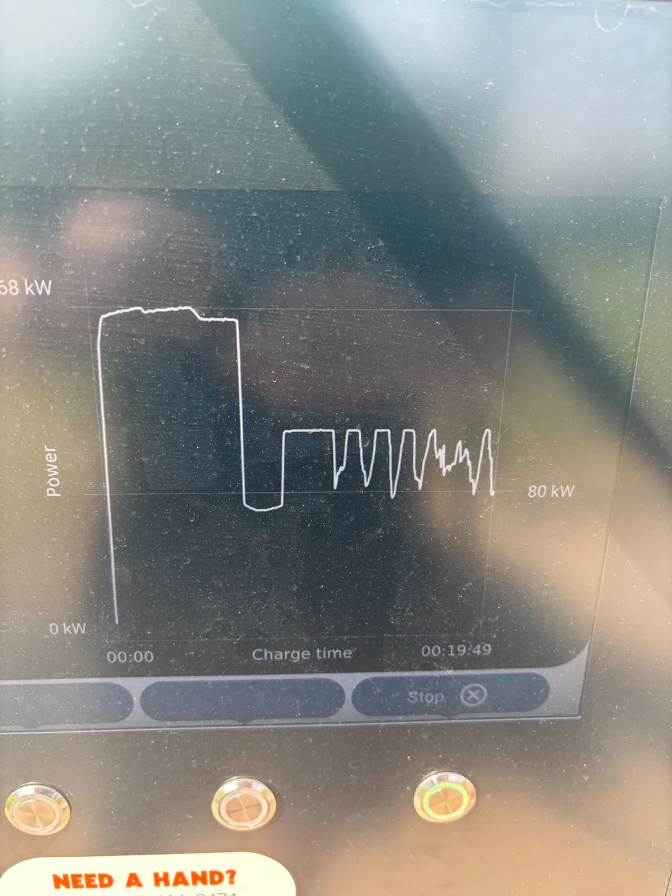

I have a 2022 lightning XLT with about 83K miles on it presently. A month ago, I had the SOBDM replaced under warranty because the truck stopped being able to AC charge at home (and work). After that repair I haven't had any additional problems AC charging. Last week on an 8-hour trip to FL I noticed that during level 3 DC charging after a few minutes of charging at 160+kw the charge rate would suddenly drop down to 75kw then after a minute or so tick back up to over 100kw. It would then go back and forth between 75kw and 100+kw for the remainder of the session until I stopped charging. After the session it took quite a bit of trying to get the charge port to let go of the cable...at times I didn't think I was going to get the charging cable out of the charge port. This happened almost every stop with many different charging networks (Ionna, EVgo, EA, and even Tesla). I have attached a photo of the charging curve from one of the stops.

Tough to diagnose with just that symptom but it could be temperature related. If the pin temperature goes too high the truck will limit the current. Once it cools the current will increase and repeat the cycle. @branden did a post recently detailing the behavior. The fact that the connector was hard to remove also points to temperature since the parts would have expanded. It could just be a dirty pin or the connector on the charger could be faulty.

Was the port in full sun light?
Might be throttling down to cool down?

I would happen when the truck was charging in the sun or the shade. It also felt like the charging cable was locked in with the locking pin even after the charging session was over.
