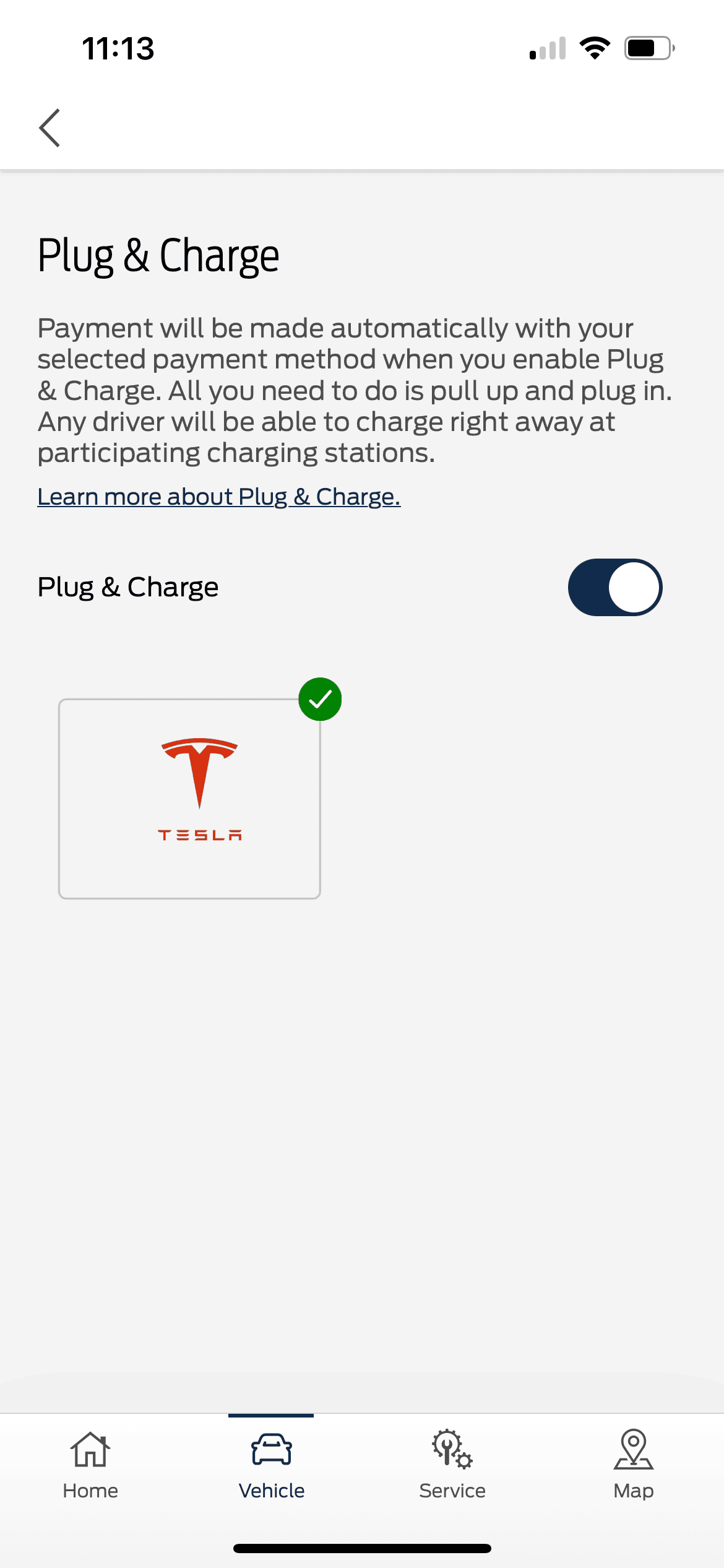

Not sure when it happened…maybe with the Supercharger update or maybe when my dealer factory reset the truck…but EA is no longer listed in Plug & Charge. It was there previously and worked…but now only Tesla is there.
Ford F-150 Lightning EA Plug & Charge disappeared in Fordpass [resolved] IMG_4453
I’ve checked everything I can think of, but clearly I’m missing something.
Anyone else have this issue? Any other insight from you wizards out there?

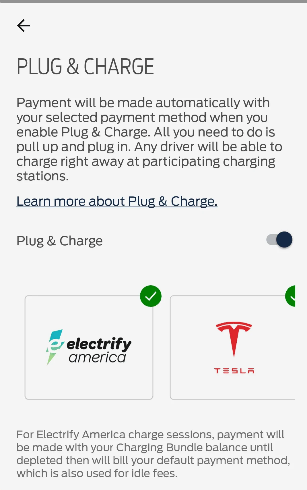

I'm still seeing both, v-4.33.0

Factory reset the truck? That’s probably the trigger here, not the update. Assuming you reconnected to all the services, give it a day or two to resync with the mothership.

I’m on SW version 4.33.
I do agree the factory reset is the likely culprit, especially since no one else seems to be having this issue.
I have turned plug & charge off, and then back on…but I am going to leave it off for 24hrs today…give it a little extra time to reset itself.
I have reconnected all the services…and it’s been well over a week and still no dice.

Delete the app and reinstall?

I noticed some quirkiness, but if EA is already selected it doesn't appear in the list. OR try deselecting Tesla and/or turning off plug-n-charge and they will both come back.
But really, if you have plug-n-charge selected, you don't need to select any specific network because it will automatically already be Tesla and EA only.

Liked your suggestion. Tried it...no dice.

I did try deselecting Tesla in addition to turning off plug & charge. EA just never shows up anymore.

Found the fix. I had to unenroll/cancel the Blue Oval Charging Network subscription and reactivate it. That fixed it.
