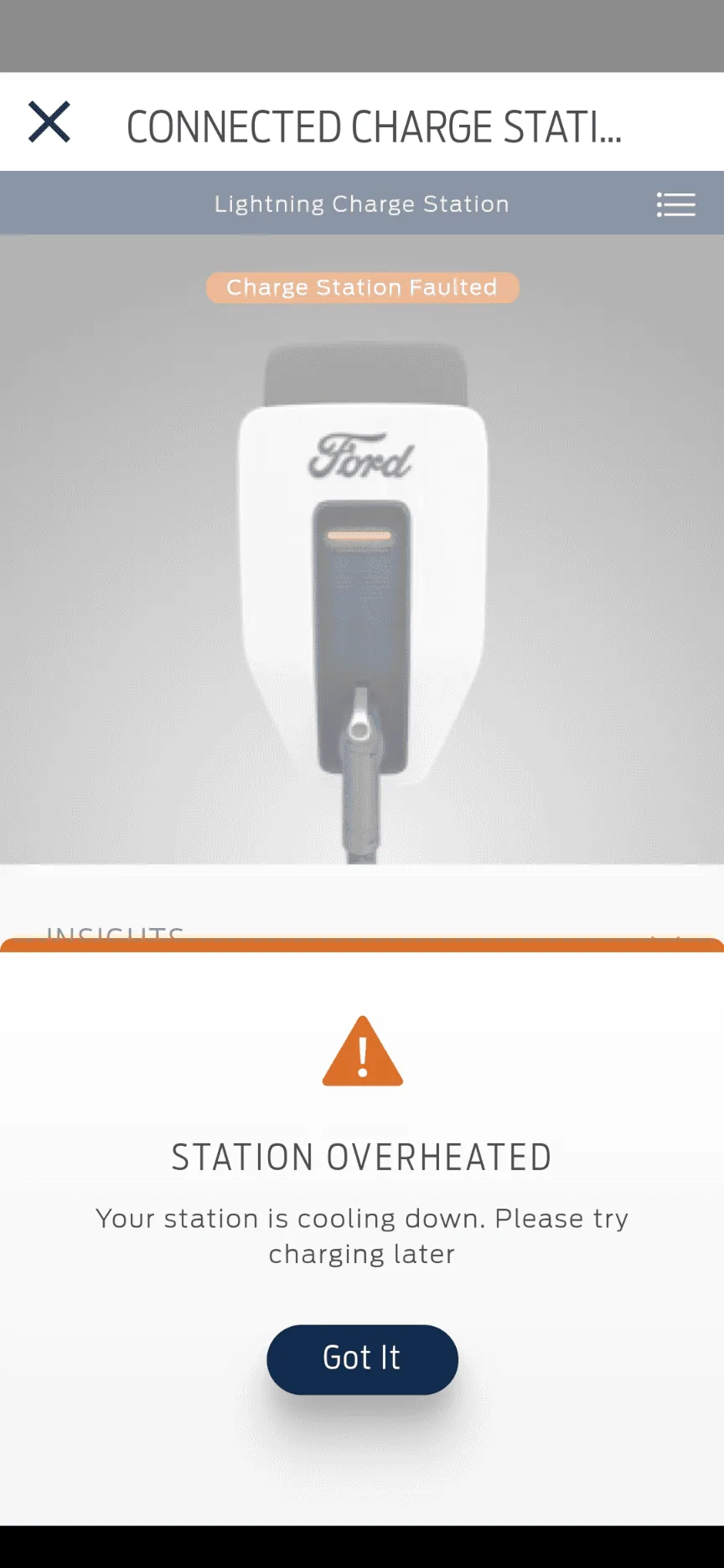

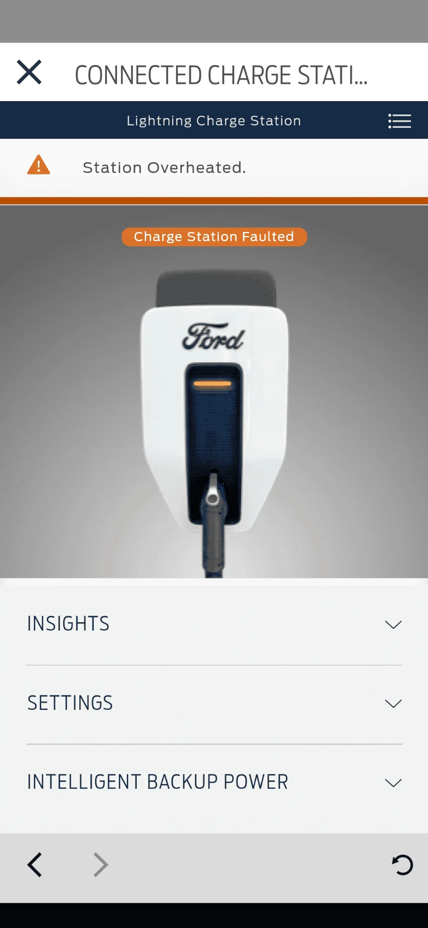

After having to RMA my first FCSP due to it faulting as soon as it would be plugged in to charge, my new one shows an error in my FordPass that it is overheating while charging during the night. Is anyone else see this? I am in AZ where it reached 120 yesterday. I charge in a closed garage. Is it just too damn hot to charge?

Make sure you have the latest FW update. If you do, then yes I am also having issues. I had to dial it back to 60 amps last month. Last night (hit 108 on the weather station at my house) I still had it give me an error near the end of charging (around 9pm). I'm going to change the charge time back to early morning (usually only need 1.5-2hrs to top up). It's still warm in the garage (truck said 92 when I turned it on and it was 78 outside) but better than late evening.

It’s rated for up to 60C (140F). Has your FCSP been updated to the latest software? There are a couple threads showing what the current version is.

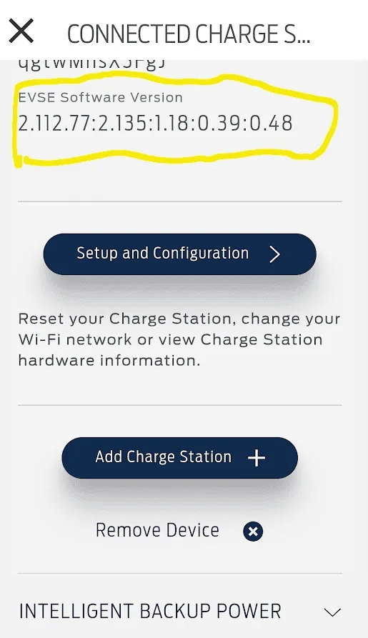

Current FCSP software version:

I have the latest firmware 2.112.77:2.135:1.18:0.39:0.48. I also have mine dialed down to 60 amps, by the installer, as they think having it at 80 may have been what killed my first one. I charge between 11:00pm and 5:00am, as my power company has super cheap rates for EVs during that time. I got the overheating messages at 1:02am, 1:33am, 2:06am, 2:38am, 3:12am. It finished charging at 4:42am

Good to know you're up to date, you can dial down the charging rate in the Connected Charge station tile, on the FordPass app, try lowering it to 40 amp while it's this hot possibly minimizing the charging pauses due to overheating.

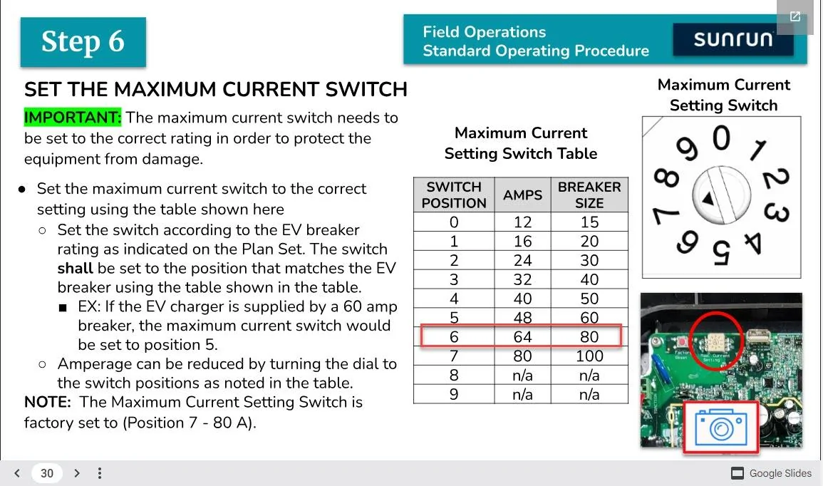

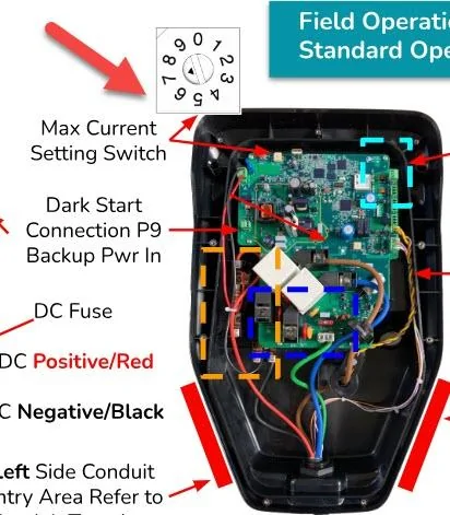

One thing I noticed, when the electricians installed it, they "dialed down" the max current setting switch from 7 to 6. Setting it to 6, would be 64amps; which may explain why that is all you were getting. I wonder, if the setting on the FCSP is set to max at 64 amps, but your FordPass is set to 80amps, would that cause overheating? Might also be my issue

I checked my charger when they installed the replacement & it's set to 7 / 80 amps. I've always kept it on 7 for both chargers & only adjust it by the Ford app.
The hardware setting is a max limit and can not be exceeded regardless of the software setting.
