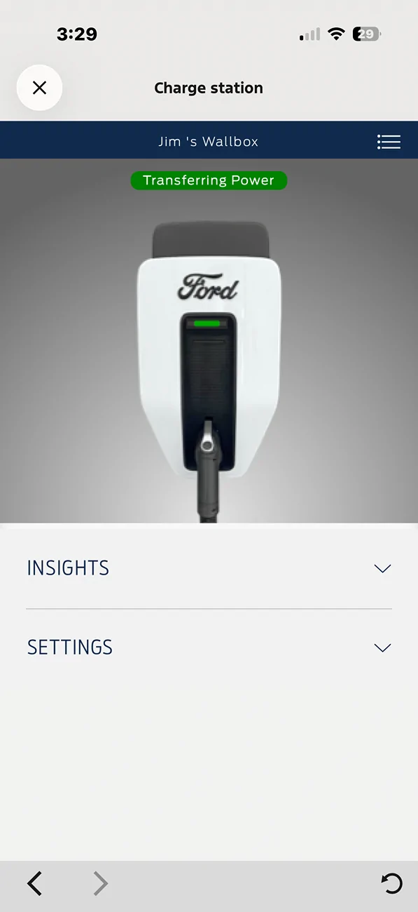

My charging session started 35 minutes ago and the FCSP is showing transferring power (green) in the fordpass app now. My charging rate is the normal 17.3 kw. Definitely something is up.
I have the same issue. Showing transferring, even though I don’t have that set up. Also can’t see the version number anymore through the Ford app. Not sure when that went away. The other night the station was charging at 1 kW to 8 kW normally it charges right at 17. Not sure if it’s related or not.

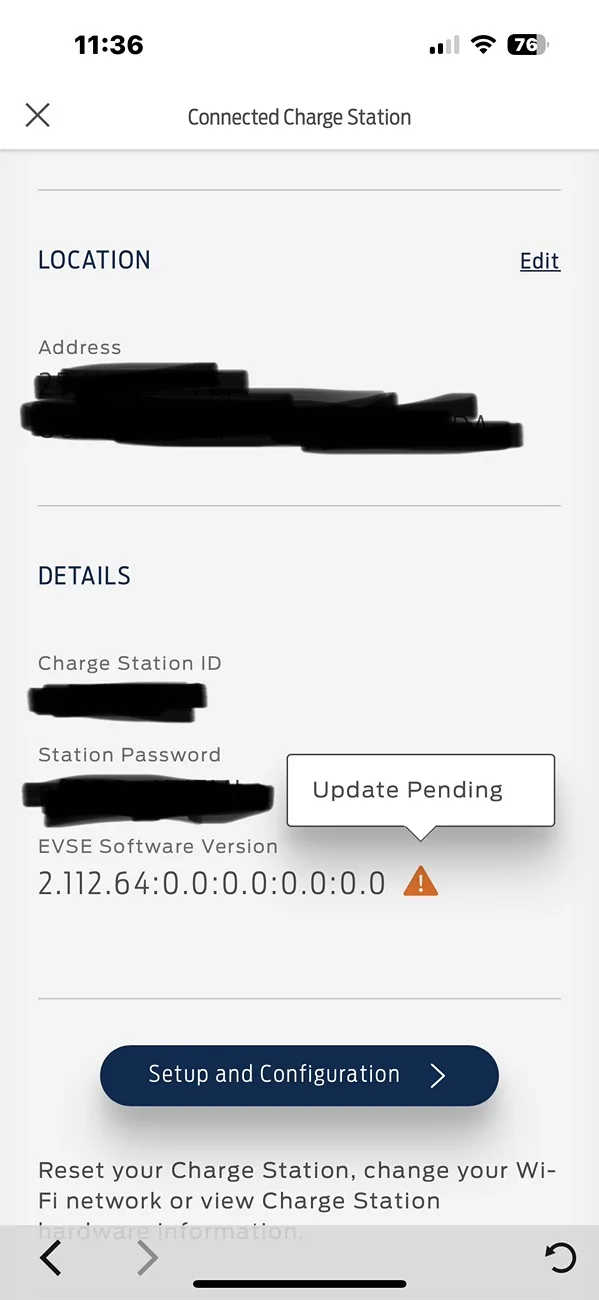

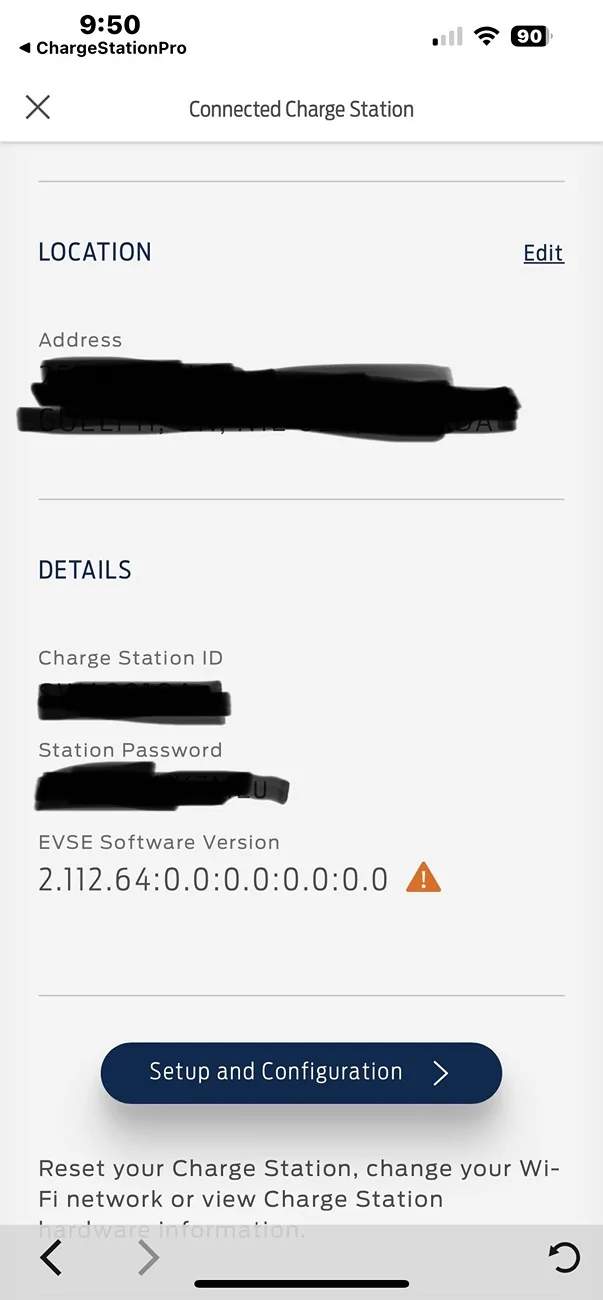

You don't. That you see in the Charge Station app.
It used to be located in the Ford app under Charging Station. I used the Charging Station app initially to set it up, but I deleted it afterward. I guess I’ll have to download the other app if I want that info now. Thank you.

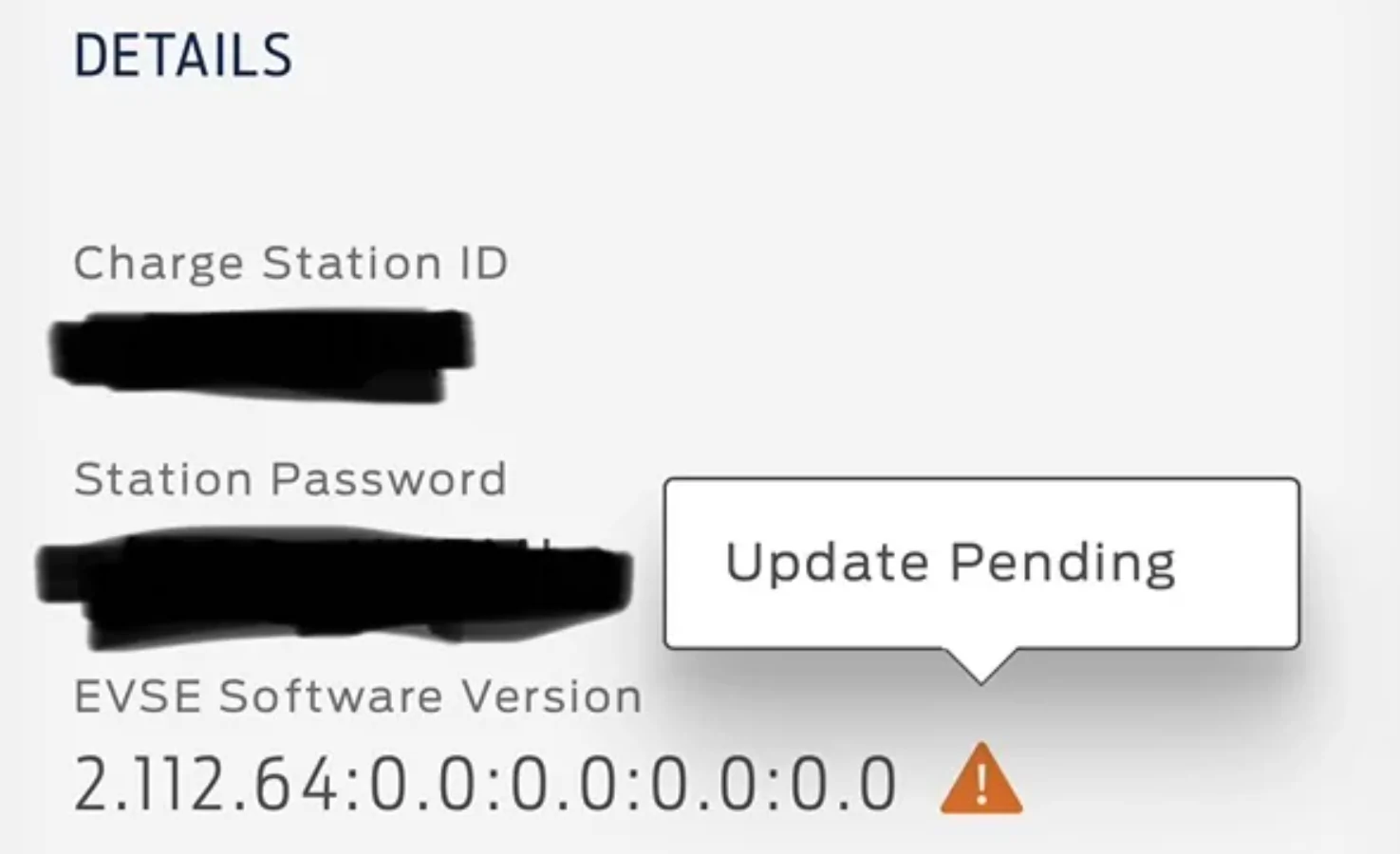

@Jim657 , I wouldn't worry too much about how the FCSP firmware you have now behaves. Based on your post, you are probably at least a version or two behind the latest that's out now and as your image shows (see below), you have a firmware update pending.
Ford F-150 Lightning FCSP Software Version 2.500.34-ford.27+26-08 1787194837997-f3
