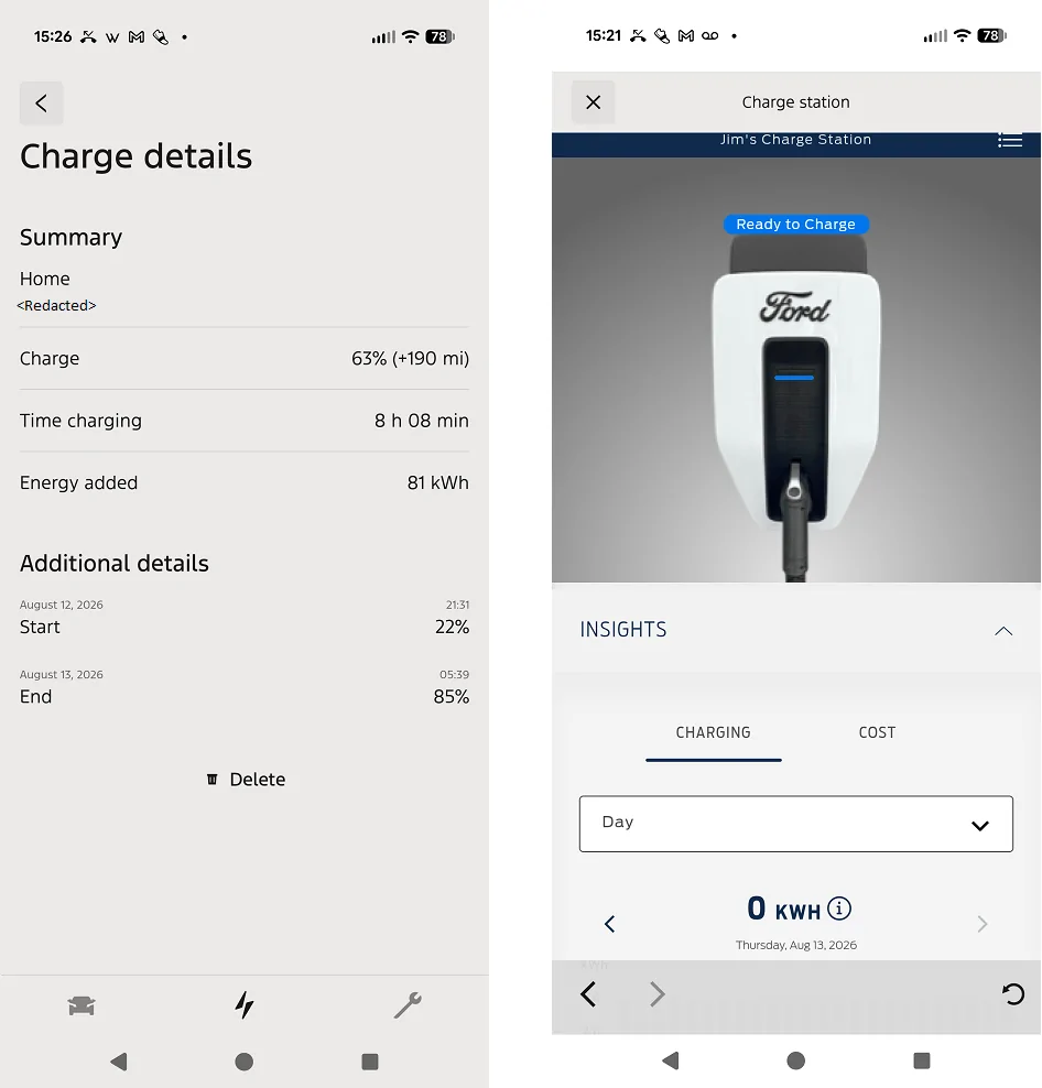

A change today. I charged last night from 2131 to 0539 this morning. The Ford app showed the power prior to disconnect, and after disconnect the session showed correctly in the Charge History. However when in the Ford app and selecting the Charge Station and then Insights, the session did not show. Prior sessions are still there. Prior to today, charge sessions did show on Insights.
As expected, if I try to connect to the FCSP via the Charge Station app, it is listed, but can not connect - no change.
Your FCSP is in the same operating condition as mine with the corrupted firmware update.
The statistics we can see are coming via the truck telematic data, while the insights data from the FCSP itself have gone silent because of the mishandled log files being generated at the moment.
I'm done trying to experiment with my unit until we receive word on how to remedy the situation.
Luckily, I have my Emporia energy monitor for actual gross energy consumption, which frequently matched the FCSP values to the tune of 99% match, so it's not a big loss to me, but the integrated statistics inside of Ford App for long term analysis was nice .... while it lasted!
