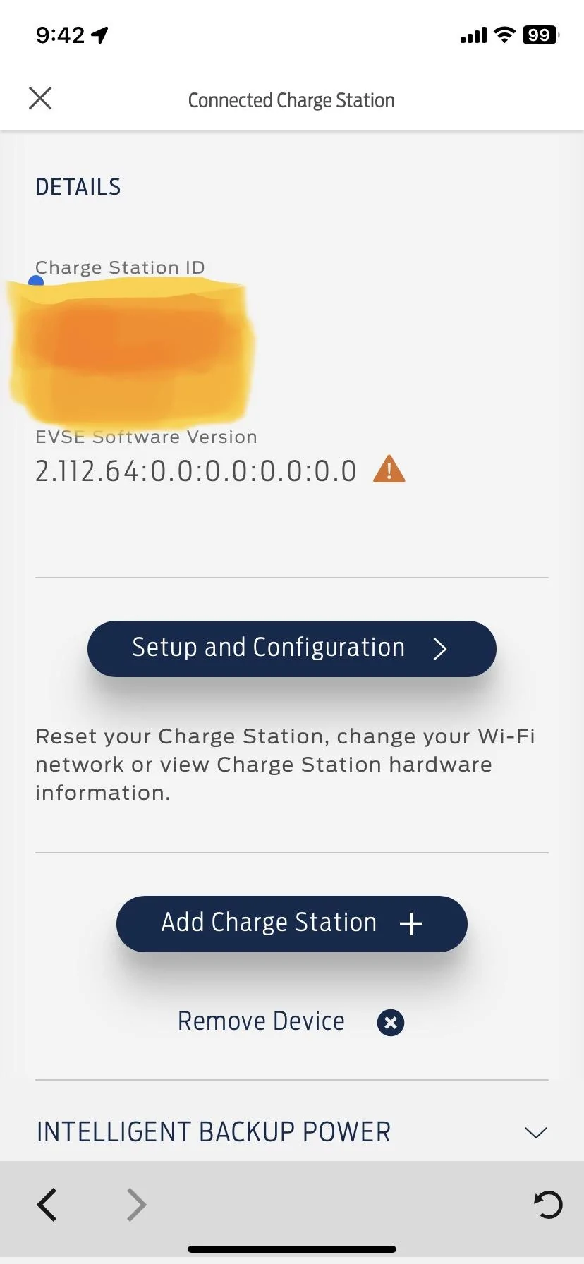

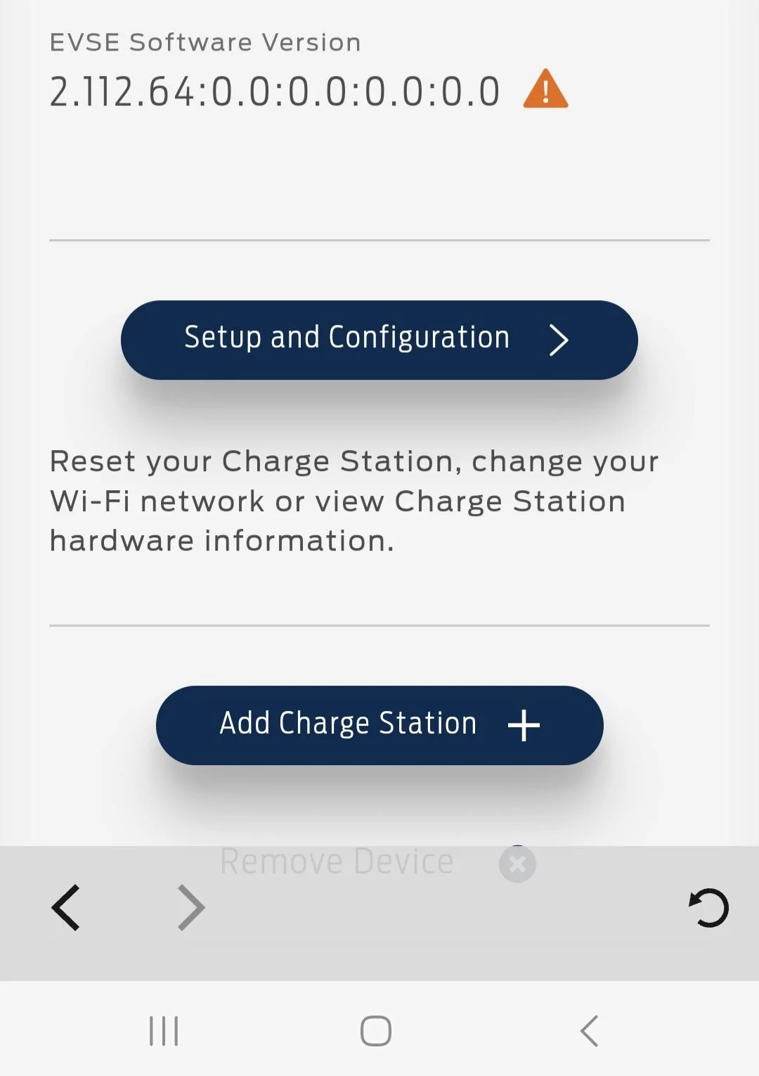

I just got the FCSP installed on a 100A circuit. It has version 2.112.64 out of the box; the box said it was built in Nov 2022. It said it has an update pending, so I let it sit overnight not connected to the vehicle. It still said the same in the morning. So, I flipped the breaker off for 15 min, then back on. The station has the blue light on and would presumably charge my vehicle, but I've left it unplugged so the software updates. It been on, unconnected to a vehicle for 8h today and the FordPass App has said Connection Lost for the entire time, but still says update pending in the underlying stale "settings."
This is really great software.
Do I need to flip the breaker yet again, or let it sit like this for even longer?

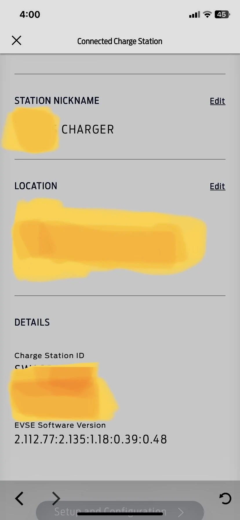

I installed the fcsp on 6/3. I power cycle it several times with the breaker box and also using the reset button. I also left it off for an hour or so, and on 6/5 it showed that it updated.
Good work covering up all critical information. But tell me, if you canโ€™t get into the charger, why would anyone else be able to? And if they could, tip them well.
I quit effing with mine and run it as a dumb(yes, it is) 80 amp charger.

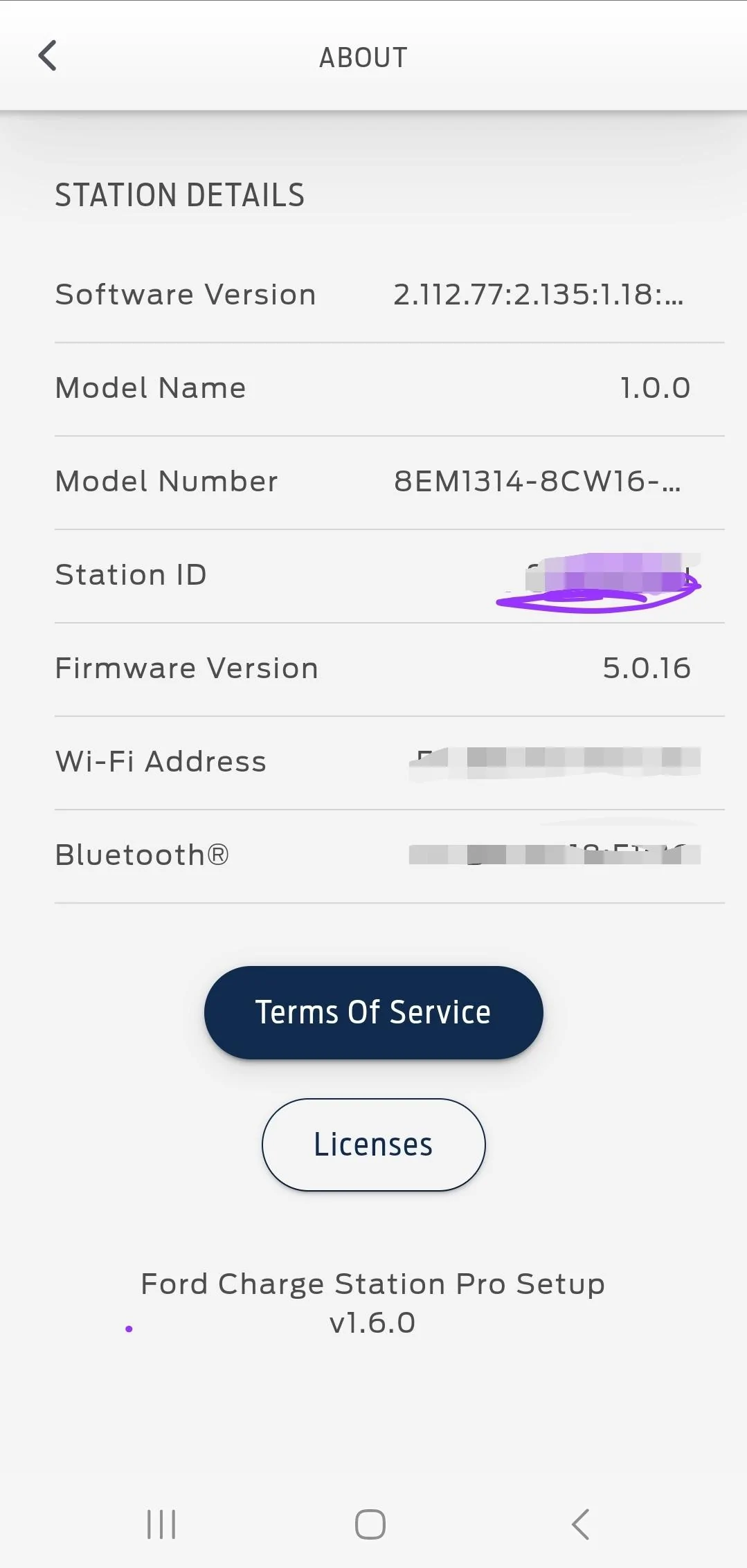

I was following this thread to for the same issue everyone else is having.
Something I noticed today however is that that when I access the charging station through the Ford pass app, I see the old software version with the "update pending".
However, when you go through the actual ford charging station pro app, I noticed that my software version was up to date. So not sure if it's just a syncing issue. But I would presume that if the software is updated through the main app, then it shouldn't matter what the ford pass app says. But dunno.
It'll settle out in a few days, this happened to mine a few weeks ago.
