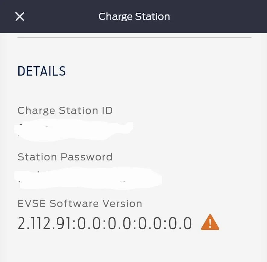

Great DO NOT change the app, but do increase the POT from 5 to 7 and see if the yellow light goes away, I'm curious if it does, might be a wild goose chase though and the issues you're having are actually heat in the handle, now that the FCSP is connected to the network, you might also get a couple patches that will remedy thermal sensitivity.
Every couple days power cycle your FCSP to implement any firmware updates, also look at the FP App settings for the current version level, post a snap shot of it (sanitize your device name & password) note my version numbers are eff'd up by a prior update, you will see a complete sequence of values
Ford F-150 Lightning Ford Charge Station Pro Fault - "charging at a reduced rate" 1726617864587-vx

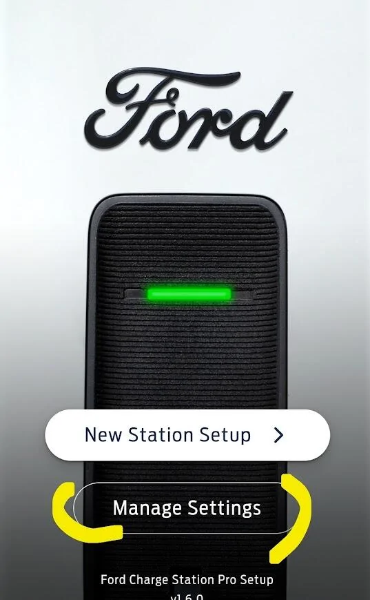

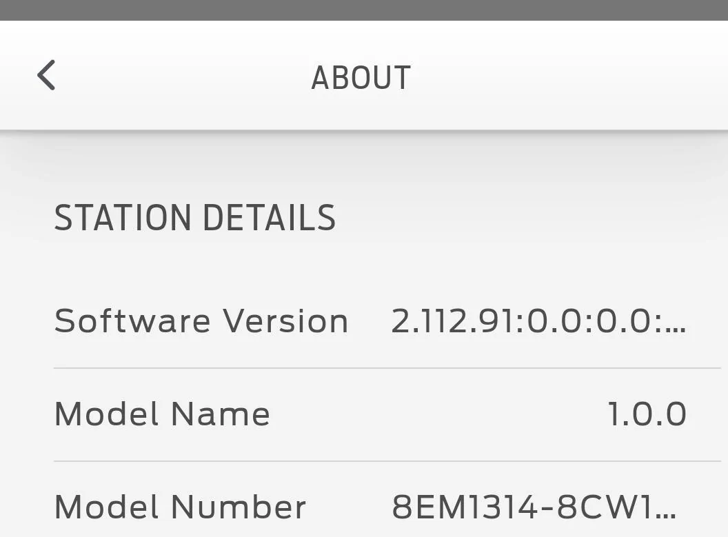

This information can also be seen in the FCSP Setup Application, to see it your mobile device must be connected by wifi to your home network and then you use the utility to logon.
Ford F-150 Lightning Ford Charge Station Pro Fault - "charging at a reduced rate" 1726617932834-mf
Ford F-150 Lightning Ford Charge Station Pro Fault - "charging at a reduced rate" 1726617950647-52

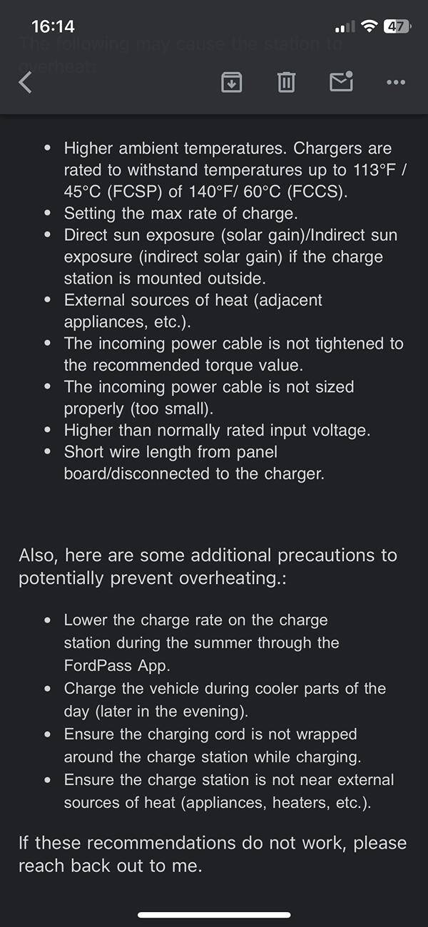

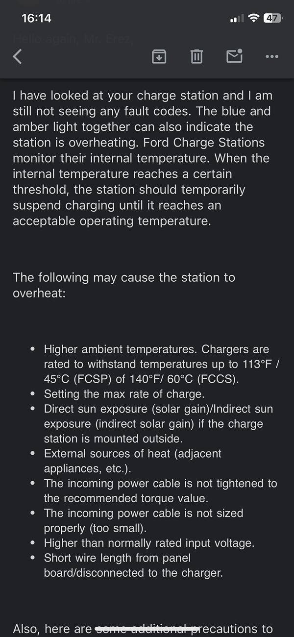

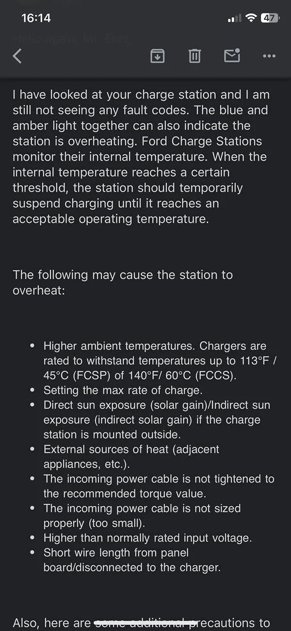

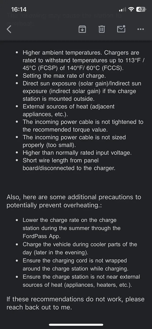

Ford sent me the following email. The vast majority of these things don’t apply to me but a few do, like having the cord wrapped around the charging station. I’ll post the email here for future readers to use and help troubleshoot.
Ford F-150 Lightning Ford Charge Station Pro Fault - "charging at a reduced rate" IMG_5926
Ford F-150 Lightning Ford Charge Station Pro Fault - "charging at a reduced rate" IMG_5927
