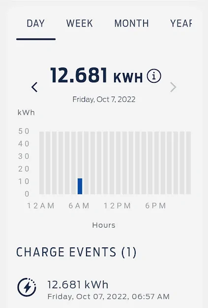

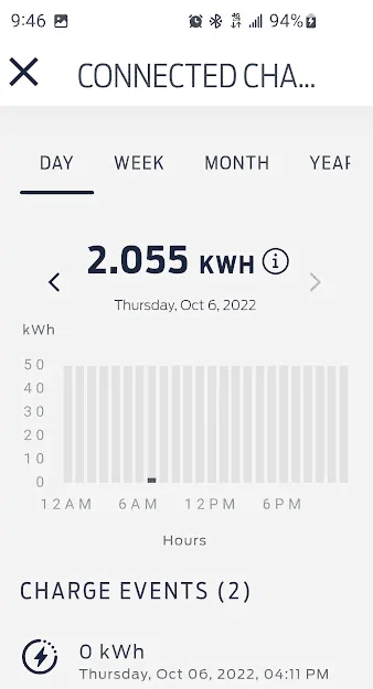

Unfortunately no, but if you use the Insights screen, it will give you a charge history, by the day, week, month and year.
Ford F-150 Lightning FORD charge station Pro- how to tell what rate is going into truck? 1666821798383
Looking at the daily chart, it's detailed into 60 minute increments, you also have the charge log which will report the time it took to take on that charge, from there a quick calculation will yield the average rate of charge and further you could get the average amperage.

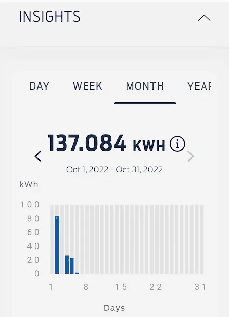

Week, month and year charts also though not useful to get the data you (and many of use would like to see)

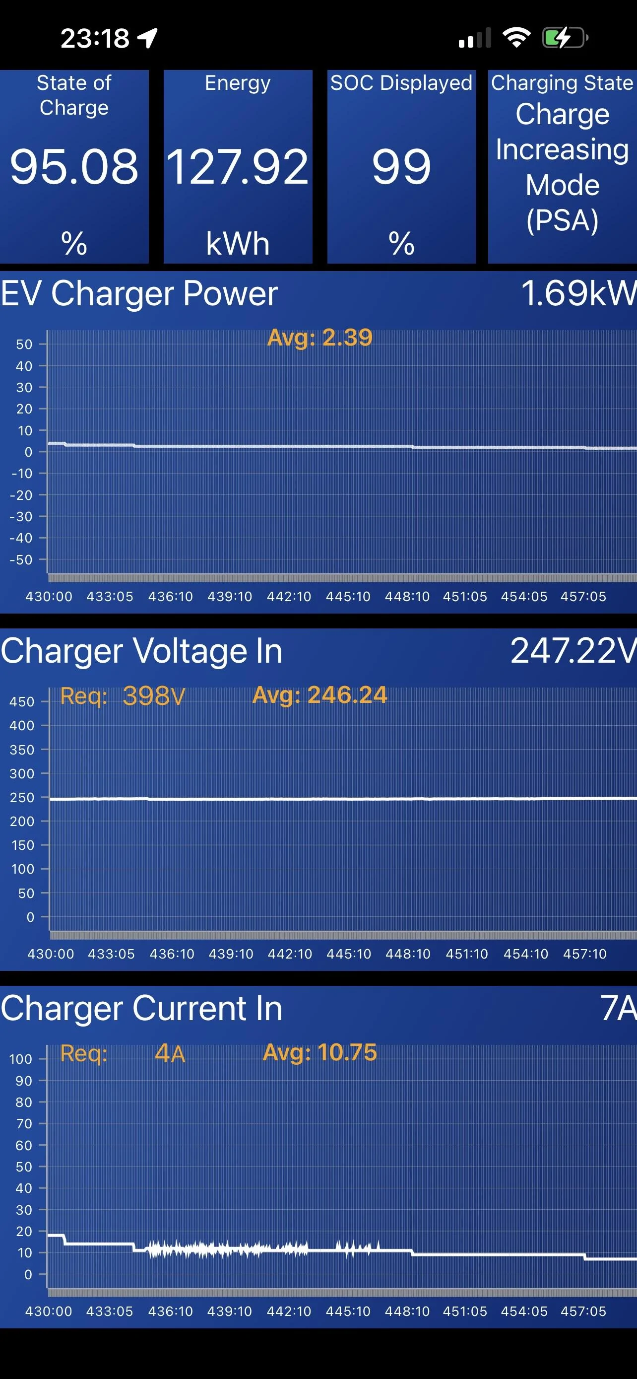

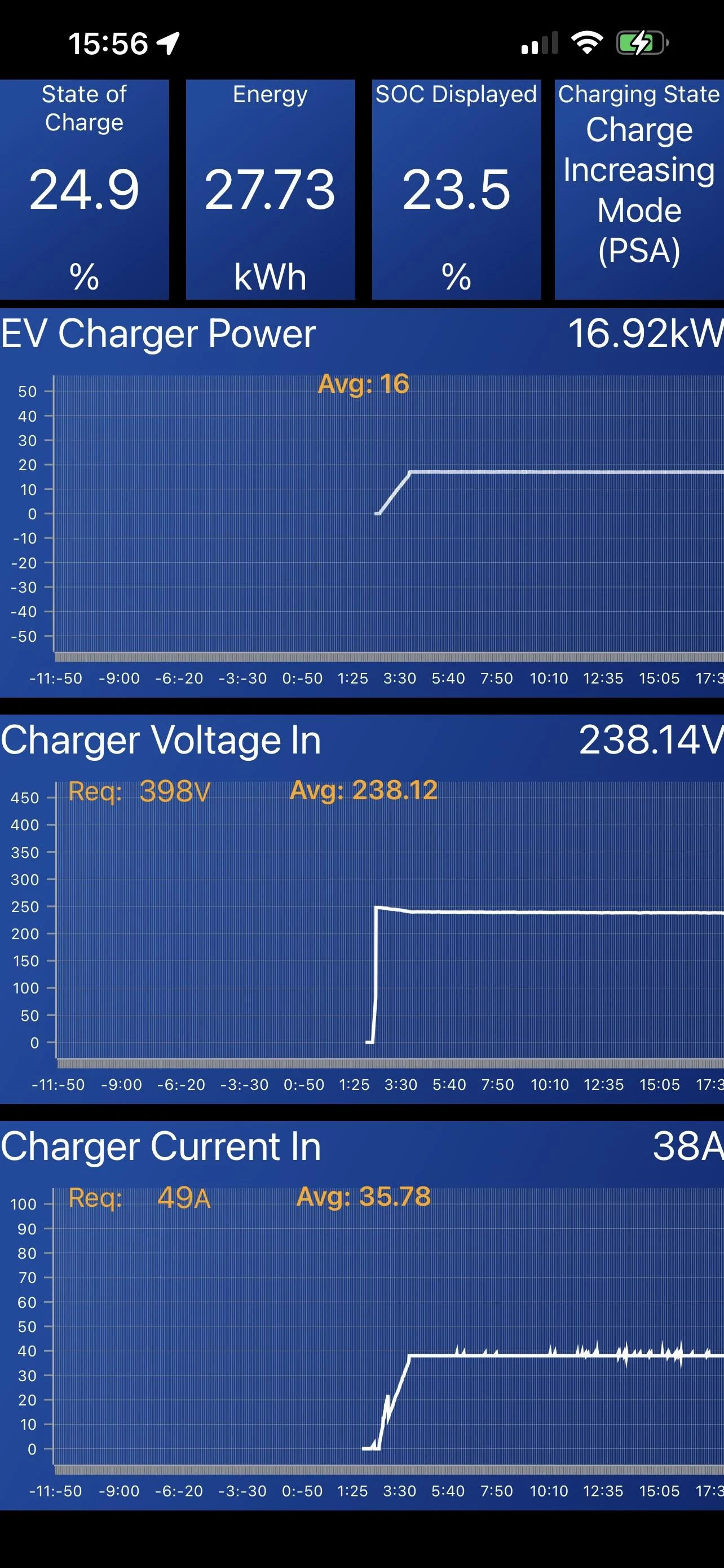

The only way I know of is to install a OBD dongle linked to a third-party app to monitor the PIDs for the vehicle’s (two in ER, one on the SR) onboard AC-DC chargers like TorquePro (Android-only) or CarScanner.
I’ve only been able to identify & monitor one of amperage PIDs, but have found the PIDs for total kW delivered and volts requested and delivered to the truck. I’m using math to calculate the total amps…..
Below is a screenshot of a recent charge session that started with a 20% SoC. My general observations to date for my FCSP fed by a 240V/100A circuit and set to 80A is I’m seeing an initial Power Delivered spike just over 17 kW that settles to an average 16.68 kW @ ~238V/~71A (amps calculated) until the truck reaches ~90% SoC…it drops of precipitously after that (see second screenshot below).

The only way to read the power is to measure voltage and amperage at the charger. I found that delivered amperage is less than that selected by Ford Pass or the dial in the charger.
I no longer measure but I consistently got 77-78 amps on 80 amp settings.
