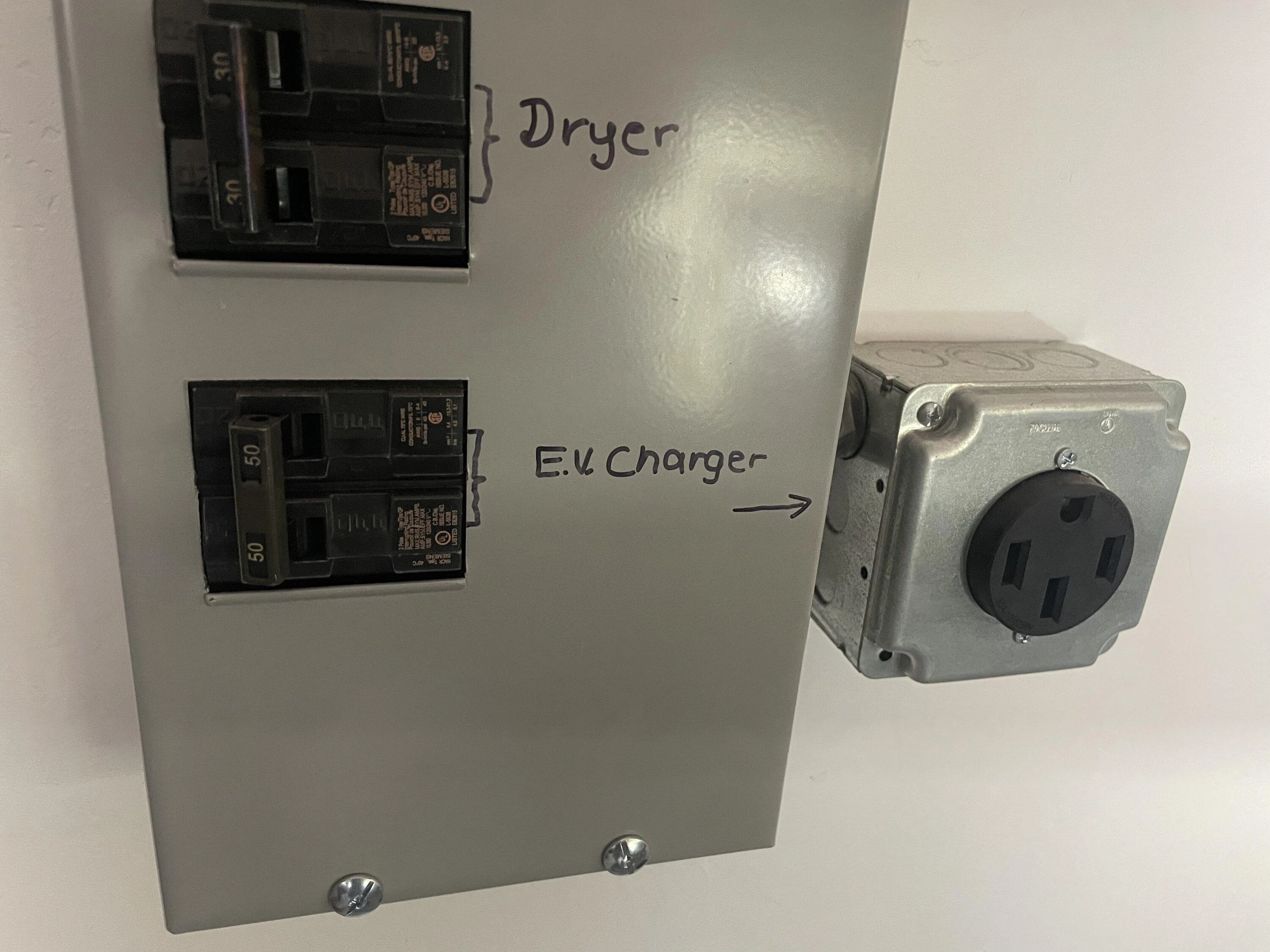

Hey everyone, I got an email that my pro charge station is on the way. Ive been using the travel charger plugged into my wall outlet. The charging has been going pretty slow. Im sure the information is buried in the thousands of posts in this thread but i wonder if someone would be kind enough to give me the 411 for my situation? I don't intend to use the truck to power the house through the pro charger. I also don't intend to change the plug on my wall from what I have got. Given the 50amp breaker and the plug Ive got -what is the best way forward for me?
Does the charger come with a mating plug? Would I be able to push more power if i hardwire the charger? If all I can pull is 40amps of charging how can i limit the charger to only provide that much? Given I don't need the full capability of th pro charger should I sell the pro charger and go with a cheaper aftermarket charger? I already own a charge point for my wife's volt and I can dial back the max provided power on that charger.
Thanks in advance.

There is no plug on the charger. It has to be hardwired. You'll have to figure out how much of a sustained load you can pull out of that panel.
If you remove the 14-50 outlet you can use the 50 amp breaker to install the charger and set it to only pull 40 amps.

Unless you get an electrician out to hardware that FCSP into a 100 amp outlet you are better off selling your FCSP and buying a NEMA 14-50 40amp 3rd party charger. That would allow you to maximize your charging capacity with your current infrastructure, assuming you don't want to invest in infrastructure changes or the Automated Home Backup feature.

So a couple things. 1) I see that the Ford pro charger is selling for $900-1000. The replacement level 2 charger from charge point i want is within $100 of this. So, Im thinking of just going with the Ford and dialing the current down to 40 amps 2) Is there any reason that I cant put a 14-50 plug onto the Ford pro charger? I mean vs hardwiring it?

I believe the installation instructions specify hard-wiring. It is an NEC violation to not follow the manufacturer’s instructions.
Using a cord & plug introduces an unnecessary potential failure point and, depending on what code cycle you’re on, may require a GFCI breaker that would not be required if hard-wired.

You can go to a hardware store and buy a 14-50 cord with a plug on it. Put it on the pro and set it to 40 amp charging. That is what I plan to do with mine if I can not put in a higher circuit.

Those range cords sold in hardware stores aren’t designed for continuous duty. Never mind that the terminals on the FCSP aren’t designed for that fine-stranded wire.
