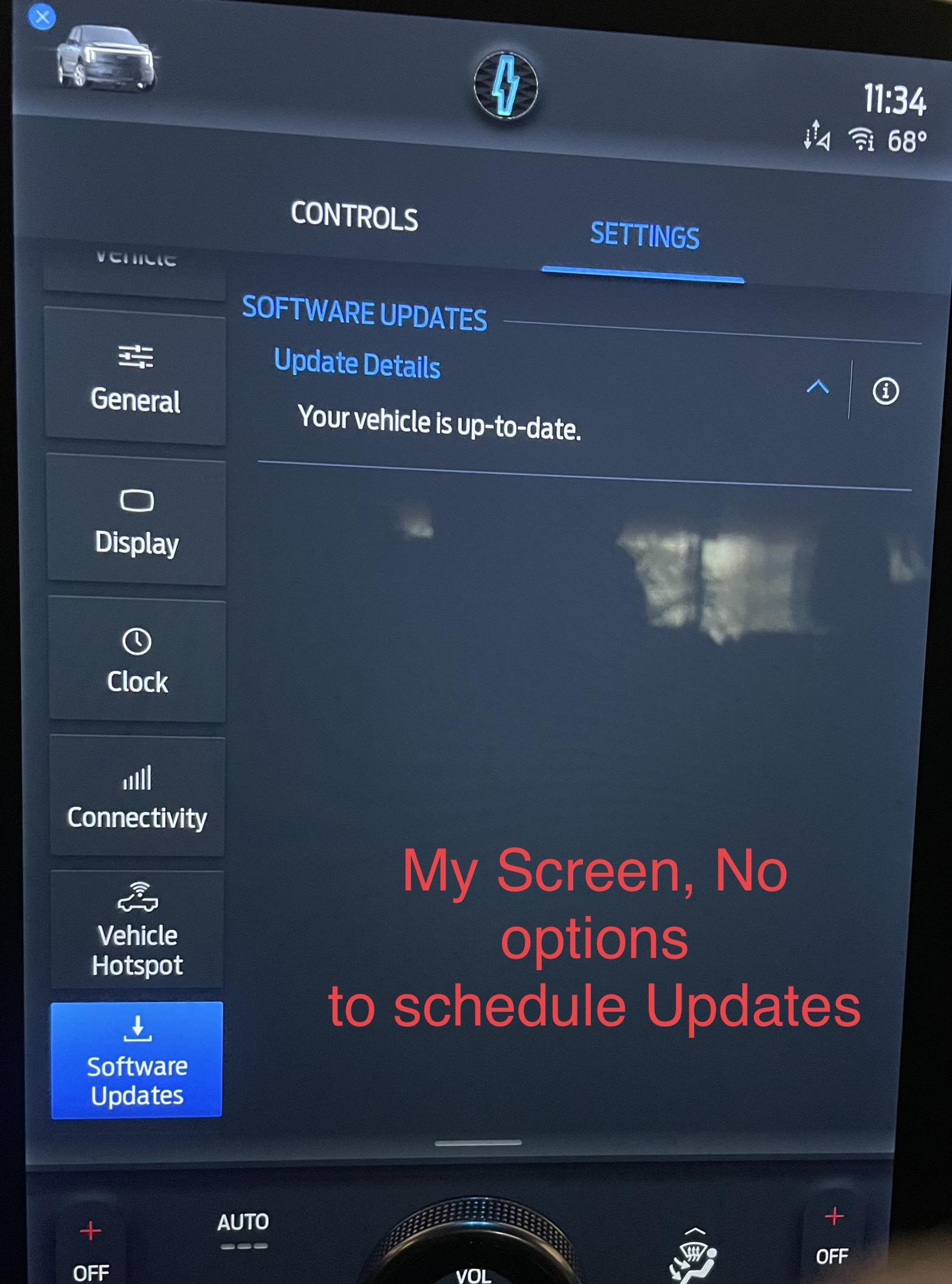

Any Ford employees or anyone familiar with the Ford Sync software,
Please HELP

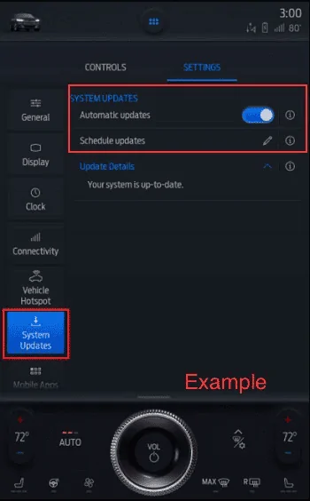

On the System Updates screen, I should have the options ‘Automatic Updates’ and ‘Schedule Updates’. However, I do not.
I have presented this problem to Ford Support and they referred me to my local Ford dealership. I have since taken it 5 times and they have not been able to fix it.
These were their responses:
  1. Wait for the next update, the options should pop-up.
  2. Fortunately a month later an update was pending and the options weren’t there, so I took it back. They updated the software and hoped the options would come up after the update….they didn’t
  3. Ford engineers are telling the dealership to wait for the next update??‍♂
Does anyone have any recommendations?
And yes, I already unplugged the 12v battery (lol), reset the Ford Sync system and uninstalled and reinstalled the Ford Pass app.

I exactly had same issue and it took me more than two weeks to figure out the issue from somebody else’s post. You won’t see those options if those are setup under either dealers or somebody’s fleet account. You can find it easily by going to settings—> connectivity options, if you see a lock symbol on telematics then your car is under somebodies fleet account .Found out that dealer was lying that he marked it as sold and he didn’t remove it from the dealers fleet account. Please contact ford fleet at (800) 343-5338. I think i chooses the option for ford pro charge station. The customer care rep created a case number and contacted somebody to get it resolved. Once he sent the email things started moving fast and everything got resolved in 24 hours. Now i can see that i have access to turn off telematics and also can see the software schedule options.

I was hoping this would help… I contacted the number you provided. I selected the Ford pro charger option. However, they referred me back to the dealership. They told me that if it was in fleet mode, they would not be able to help me. They told me Ford dealership would need to reprogram it. I contacted the dealership that I’ve been working with, they told me to bring it in in two weeks. However, they did not give me much hope as they were almost certain it is not in fleet mode….I’ll keep this thread updated with results.
