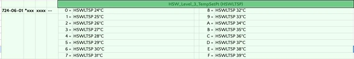

From 10 o’clock to two o’clock are the warmest, but the wheel is so big that most people, including me hold it at 9 and 3. There is a way to change the target temp with FORScan. There is a recent discussion on this.

I went into Forscan and jacked it up to the max. Toasty.

Any obd2 to usb adapters recommended in particular? I was looking at an ELM327 with an MS/HS switch, assuming this will get the job done?
