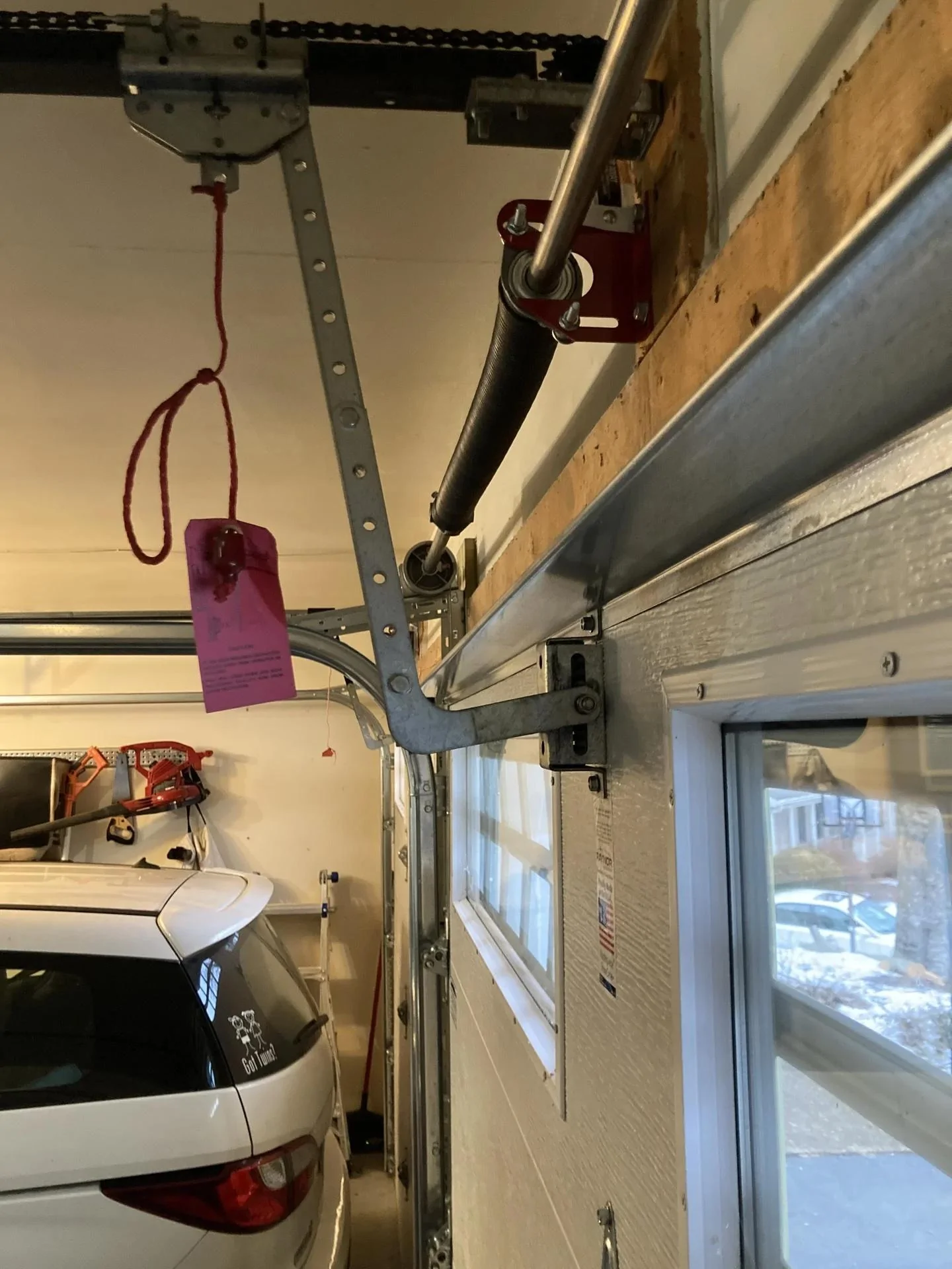

Its not the opener, its the L shaped or even J shaped bracket that attaches the opener to the door. Closed is not a big deal, but when its open it will hit the roof of the truck.
Not my picture but close enough.

Would it clear the opening?
Is so wouldn't a direct drive opener be an option ?
They attach to the bar/shaft and you can get rid of the whole overhead pull mechanism.
https://www.homedepot.com/p/Chamber...-Backup-and-Wi-Fi-Connection-RJO101/325675581
Lift master has the same? unit as well with their branding.

They’re not cheap, but you might consider a side mounted opener that doesn’t use the rails or connector you are having issue with.
They mount at the top of door connected to the spring rod.

I might look into that. According to the last home owner, I have "special" garage doors so I need to check compatibility and etc.

I believe those openers are called "jack shaft opener". They look to attach to our existing door shaft.

The J attachment piece might be able to be shortened. I had 10’ door and a 9’8” rv. I just sawed off part of the J so as to maintain 10’ under the J.

Could you move the attachment closer to one side or the other? I moved my garage door opener and its attachment over so that instead of being in the center it is 1/3 of the way to one side (to accommodate the roof box in my Volvo). With the roof box the car clears the opening by about an inch (maybe less).
