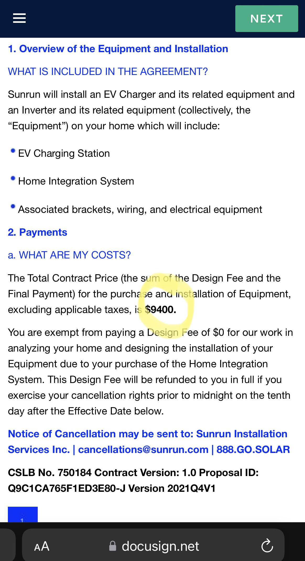

I got it off of the DocuSign contract that SunRun sent me tonight. Installation can get done On June 23rd if I sign it now. My truck is due to be delivered on June 13th-ish, so this would fit the timeline well, if I can justify the cost.
Wow.
I don't know anything about your house; but to my mind that is too much.
You need to buy the hardware from them, but any qualified electrician should be able to install it for you.

3x material is generally a good rule of thumb. In this case, it's probably about 4500 in material, and the rest labor. Not awful.

I was quoted same price with estimated install of 21st. Truck eta 24th - 30th. I signed on.

The quotes are to install the Bi-Directional Inverter, Microgrid Integration Device (transfer switch), Dark Start Battery (for grid down start of the system) and the Ford Charge Station Pro EVSE.
If you subtract the cost to have Sunrun install the FCSP, which I think was $1,500, then you have a $8k system. If you have new solar installed along with this, $8k is reasonable for the installed inverter, and makes a lot of sense (nearly free?). If you can get them to include or discount a new subpanel with this that helps as well (half the install cost).
If you are not integrating this with solar, it really does not make sense (assuming the BDI can charge the truck with solar). If like me, you are going to have to rip out and ebay a newish functioning inverter, this might make sense, but the install cost is too high. I may still do this by doing the retrofit myself, but would prefer a standards based system.
If the BDI has been reduced from 10kW to 4kW (which is what the website says now), this is a useless solution and undercuts ALL of the marketing Ford did on HIS, and a major reason I wanted the truck.
