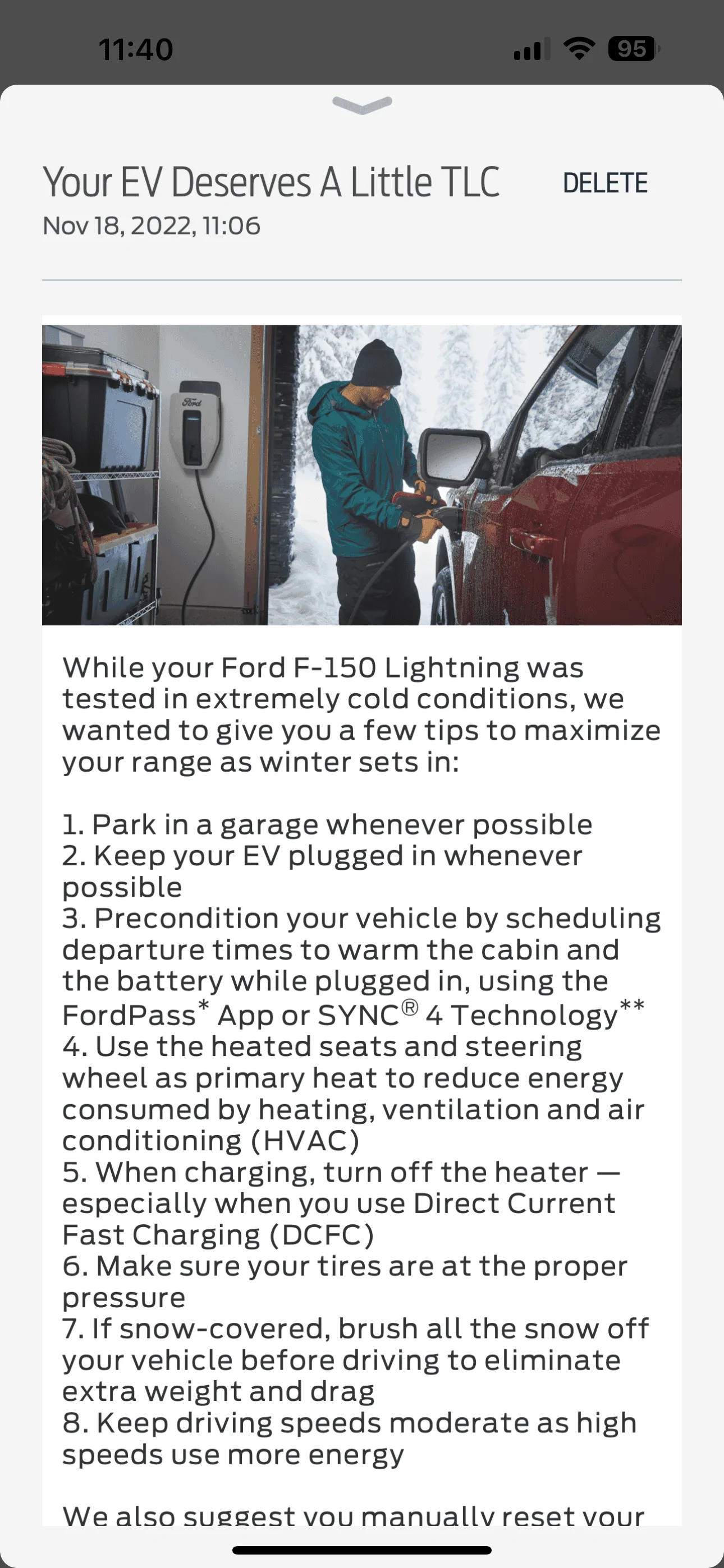

And Ford just sent this lol
Show some TLC
Just got it too. A reminder of the things you can do is good, but likely in response to the rumble they are hearing. Maybe a lot of first time EV owners out there.
Nearly the same email they sent a year ago to Mach-E owners.
