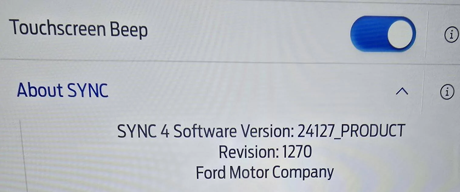

I am still on 24127. No APIM has popped up. I'm headed out to reconnect in just a few to run the BECM battery test. Other than the network test/scan is there something I'm missing to make it run a module check?
I am also on SYNC 24127, and no APIM update was available when mobile service was here last week doing my BCM.

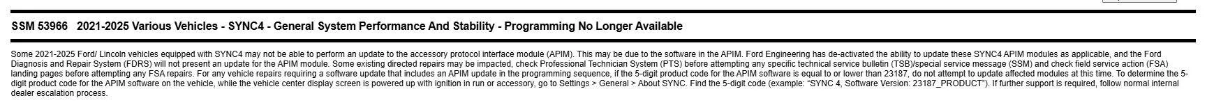

PSA to whom it may concern. We've known this to be the case for a long time on the forums. We use to think it was a mistake of some sort on Ford's side, but it seems to be on purpose. If your vehicle is on Sync 23031, 23159 or 23291 and not showing any more updates for the APIM, GWM or TCU, then Ford just doesn't like you. I can think of no sensical reason why they would do this, but it is what it is.

Happy to find mine is a newer version [24127], but I'm still waiting for recent updates to hit via OTA, last was 4/9/2025
Yea, I'm also on 24127. Hard to say what is the percentage of vehicles that are being held back.

You don't list 24127 as being held back, but yet there is a newer version and those of us with 24127 don't have it listed, so is it maybe a bigger problem than they have documented?
I wonder whether this is affected by coding differences between the 15-inch screen trucks and the 12-inch screen trucks.
It is very possible that once you get to 24127, you won't have the update for the newer version available, either.
I think 24127 is the latest version for genpop. 25094 has only been out a month and I think was initially EAP. However, looking at the 25094 OTA thread, seems an assortment of folks have it. @TaxmanHog removed the EAP flag.
