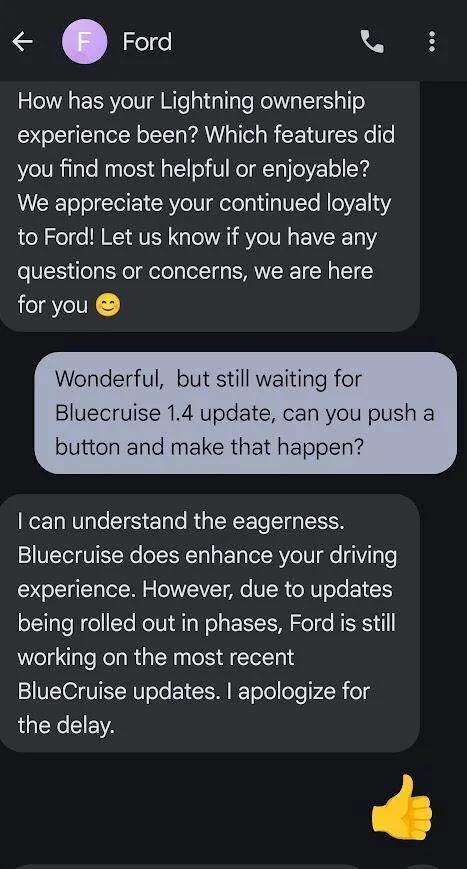

Ford F-150 Lightning New BlueCruise Version 1.4 - Rollout  IPMA-24.204.10.9 1744828845696-q3
