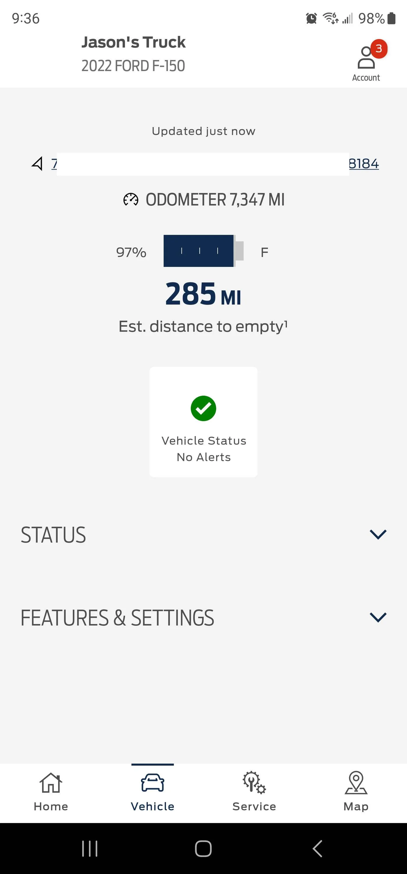

Has anyone else's truck ever had missing info in the Vehicle tab on the App? I recently purchased a used 2022 Platinum about a month ago. It's never received an update. I have a 2023 Pro as well and it shows much more in the App and has already received a few software updates as well. The screen in the truck just says software is up to date.
Today it just deiced to forget about my home charging schedule and charged itself to 100 percent rather than the 90 it's been doing for weeks. I feel like the software is like beta when the truck first came out or something. Very frustrating. Can anyone tell me if it's really out of date?

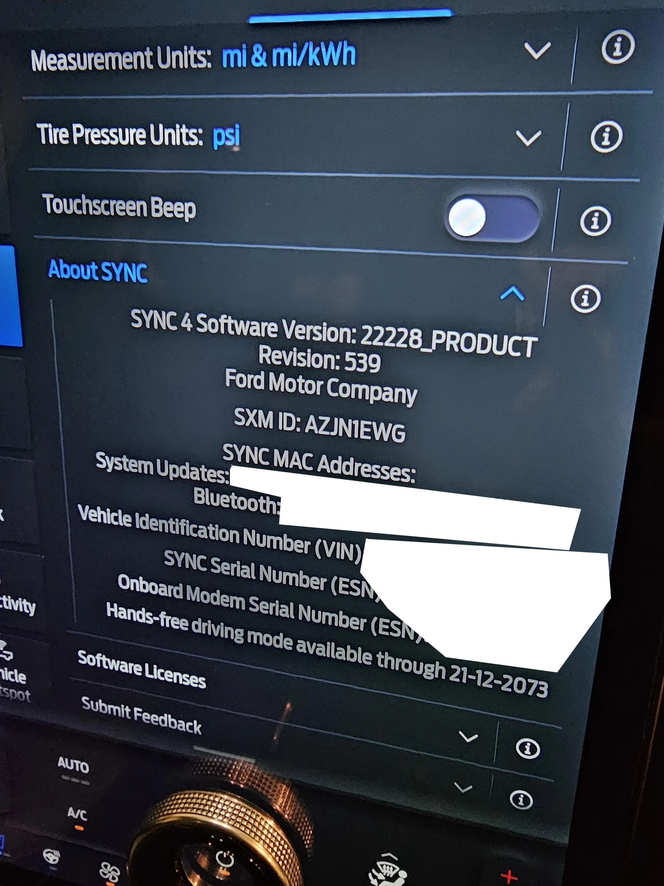

Thanks for all of the replies everyone. I went on this website and entered my vin...
https://www.ford.com/support/sync-maps-updates/
It's showing the following...
Ford F-150 Lightning New to me '22 Platinum. Super old software?  Beta pre release? Missing lots of app features 20231025_140620
Is this a fairly new version? It dosen't seem like it's that old. I think there's something else going on with my app and the missing info.
Here's my 2023 Pro work truck on the app. It has the charging tab and other things. On my 2022 it won't even show when it is charging. The only way to know is to wait a while and look for the percent to go up.
Ford F-150 Lightning New to me '22 Platinum. Super old software?  Beta pre release? Missing lots of app features Screenshot_20231025_140839_FordPass
Here's the 2023 pro version. It doesn't seem like it's too far ahead.
Ford F-150 Lightning New to me '22 Platinum. Super old software?  Beta pre release? Missing lots of app features 20231025_141159

I think Sync/Map updates only relate to those items. OTAs update truck programing for truck systems, hardware, and the computer on which Sync and Maps are installed. I suggested a potential resolution above. the truck is a big computer and sometimes you have to use elimination of potential issues. As I have suggested the first thing to understand is can the truck actually receive OTAs? If it not a Fleet vehicle then next step is to call Ford Pass rep and find out if they can see it in the system if so they may walk you thru a system reset. Do it in that order because Ford Pass can’t force OTAs while its under a Fleet designation as that blocks the truck out of OTAs. And Ford Pass cannot unblock the Fleet designation.

Yes it's working. I can remote start the truck, lock and unlock using the app. I just don't have any charge indication on the home tab and no charging drop down on the vehicle tab. Several features are missing on the features & settings tab. Charge logs etc

It's just frustrating that the PRO model work truck has many more features than the top of the line Platinum. I probably never would have noticed if I didn't have both trucks.
