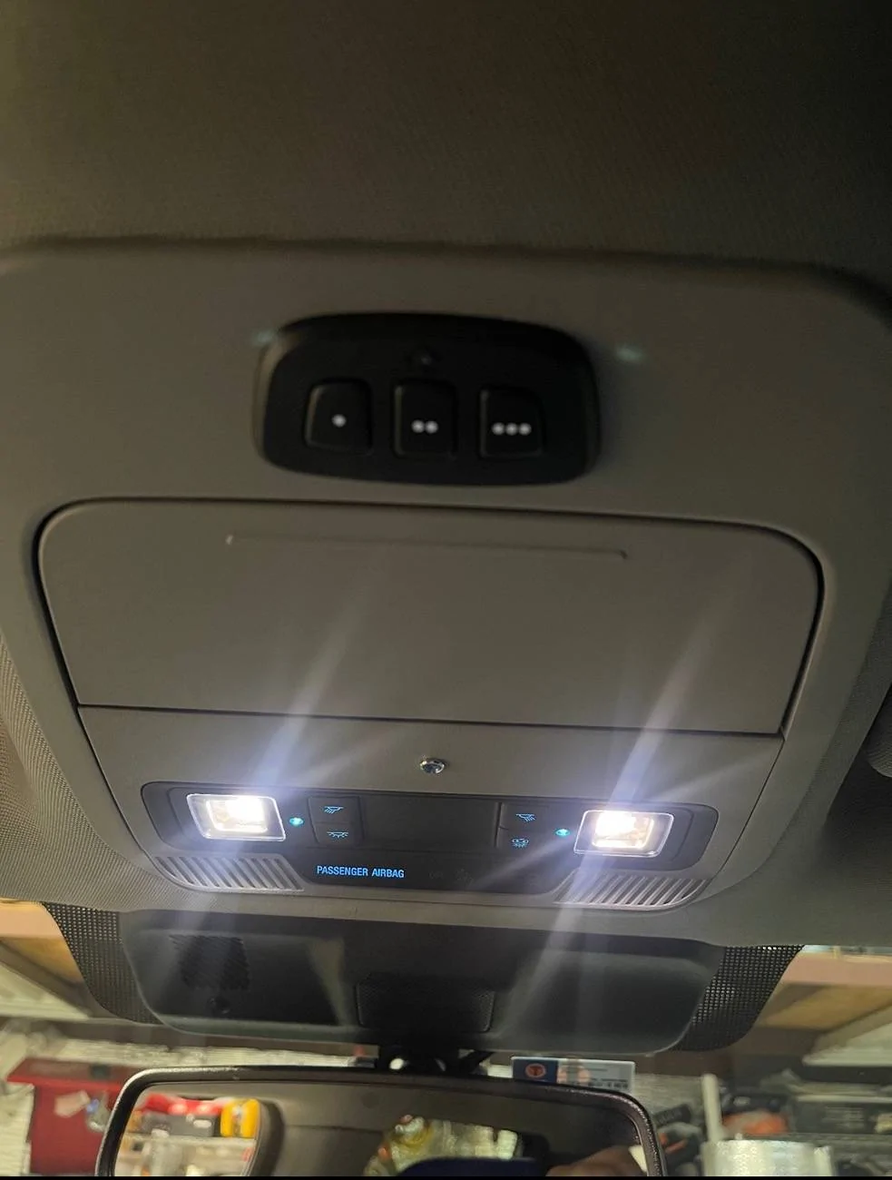

I'm thinking of just sticking my opener to the top middle where the sunglass holder is with double sided tape. I have Chamberlain openers and work of their iQ app as well. The app hasn't failed me yet in the 3yrs I've had them installed.
mrau
Feb 2, 2024
395
551
23 Lariat⚡ER
@Itaintfastenough added a Homelink button near the sunglasses holder. Looks great.
