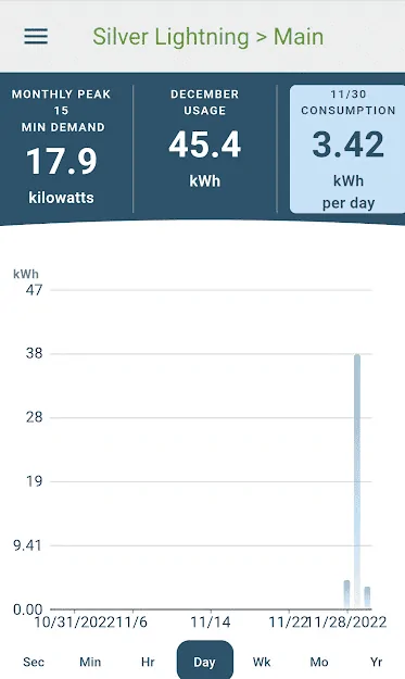

This event was timed to occur while I had the TOU set to a non-charging period, to verify the FCSP would still provide the required power to accomplish pre-conditioned cabin.
Here is the Emporia graph, by the minute this snap shot was at 7:27, peak rate was 11 kw at 7:12 then , slowed to 9, the 4.4 kw, at 7:27, it continued to maintain the temps until we walked out and unplugged the truck at 7:47 am.
Ford F-150 Lightning No Preconditioning for over a week 1669837366541
Chart by the hour, showing a total of 3.42 kWh was consumed or 92 cent, much cheaper than idling a diesel for 20+ minutes!!
The tall bar of 38 kWh was Tuesday evenings battery charging session of 67% to 90%.

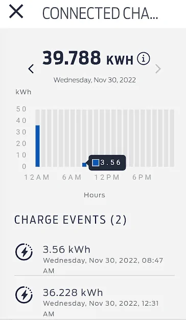

Here we see the Connected Charge station log report, note the FCSP was configured during DST so it's stuck on DST and reflects a one hour error, actual charging ended Tuesday evening at 11:31 PM Note the close correlation of energy consumed, 36.228 kWh for the charge 67 to 90% and 3.56 kWh for the 37 minutes of preconditioning.
