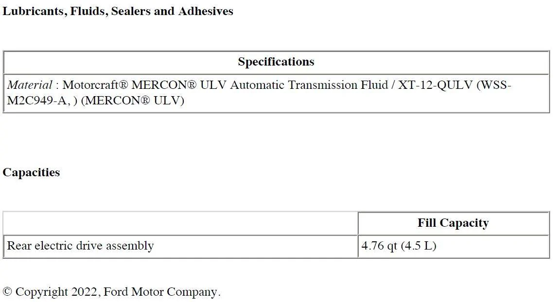

Here's the spec sheet for the Mercon ULV:
Ford F-150 Lightning Oil used in motor/axle/differential assembly Screenshot 2025-01-21 at 9.24.18 AM

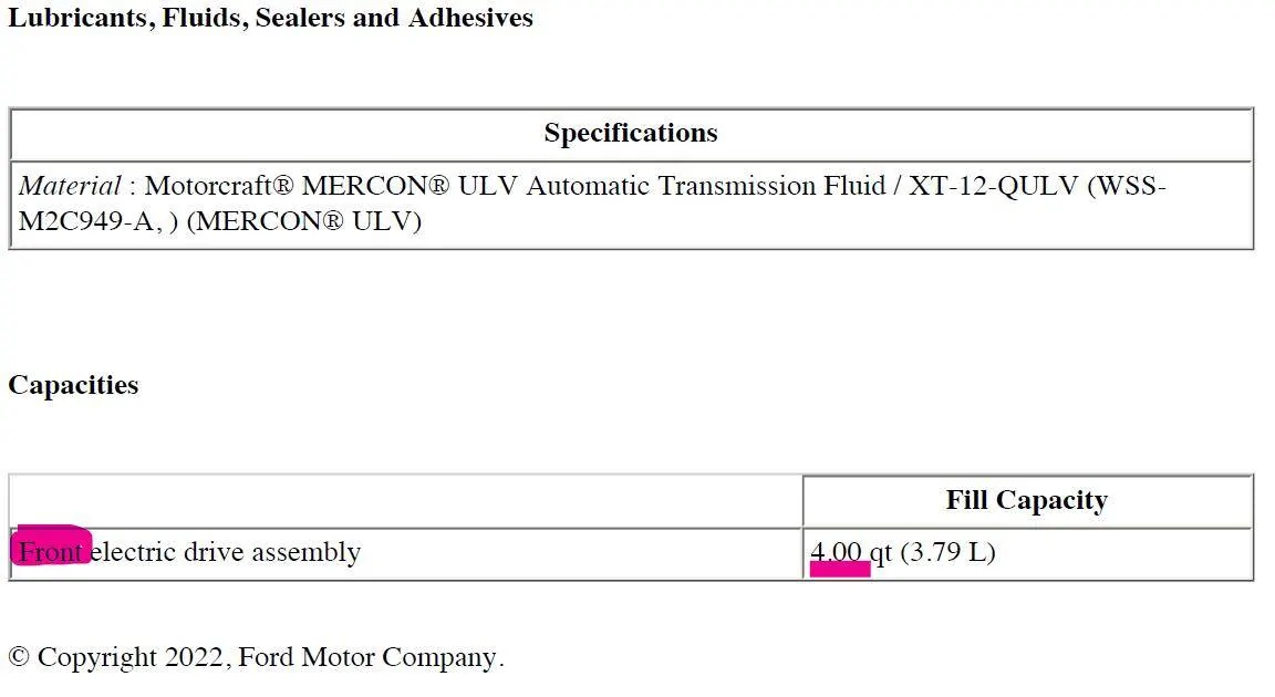

From the owners manual, shop manual, or other? Just curious.
thanks!
Shop / Service manual
Updated post four with that information and a snapshot of the volume needed for the front motor.

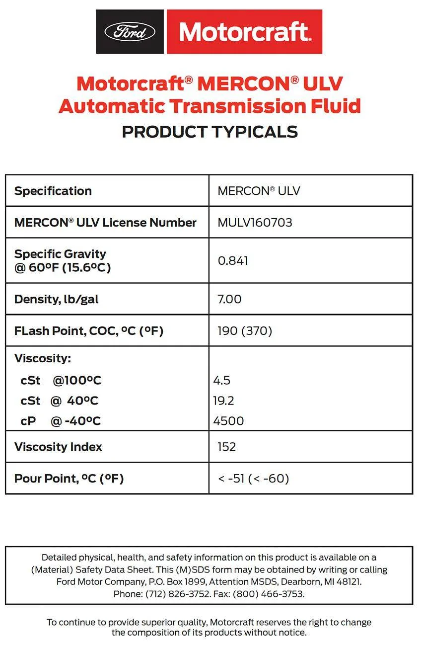

Note the pour point temp... I speculate this is why the motor temp gauge doesn't really deviate from middle as seen with the excellent work by TaxmanHog, who's purposely cold soaking his ride. As others have also noted at even much lower temps the same lack of motor temp gauge deviation.
