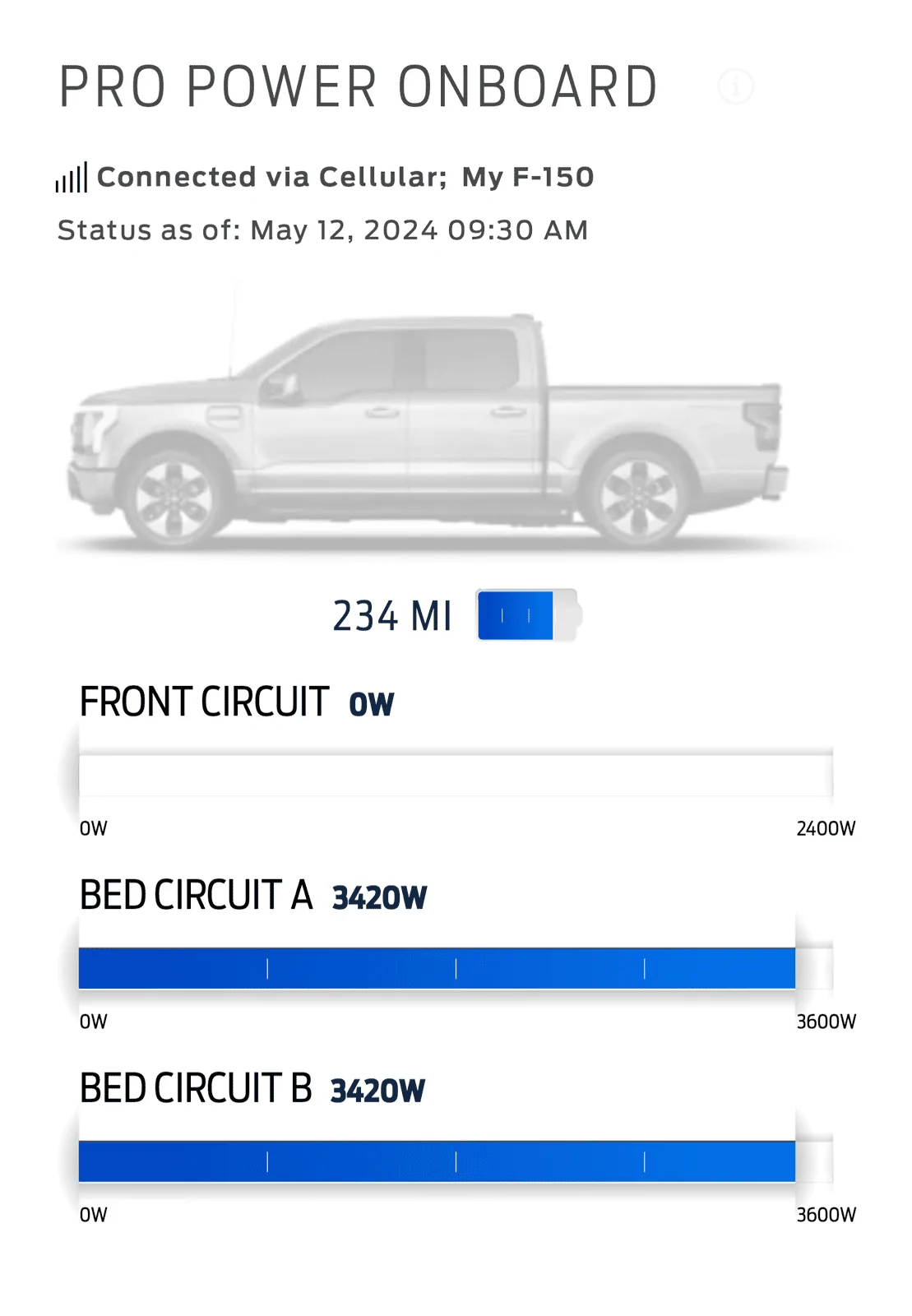

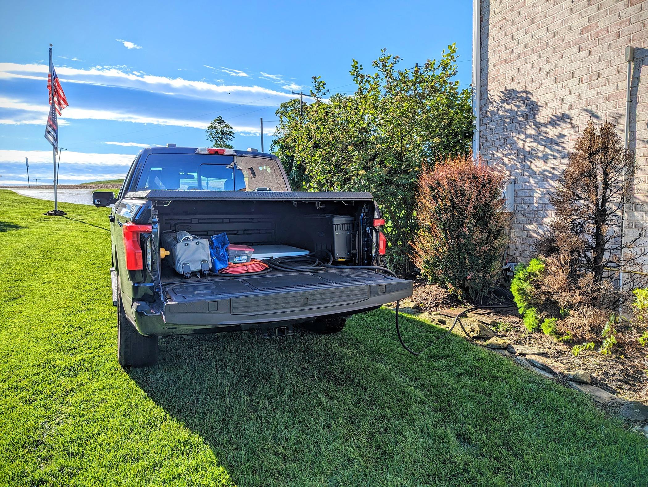

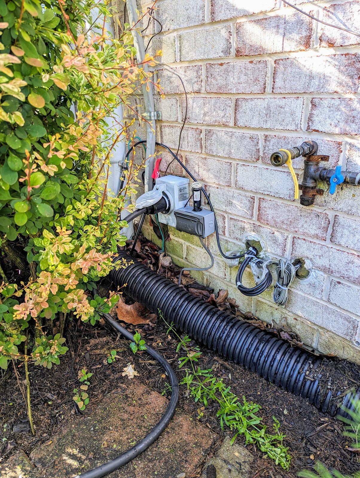

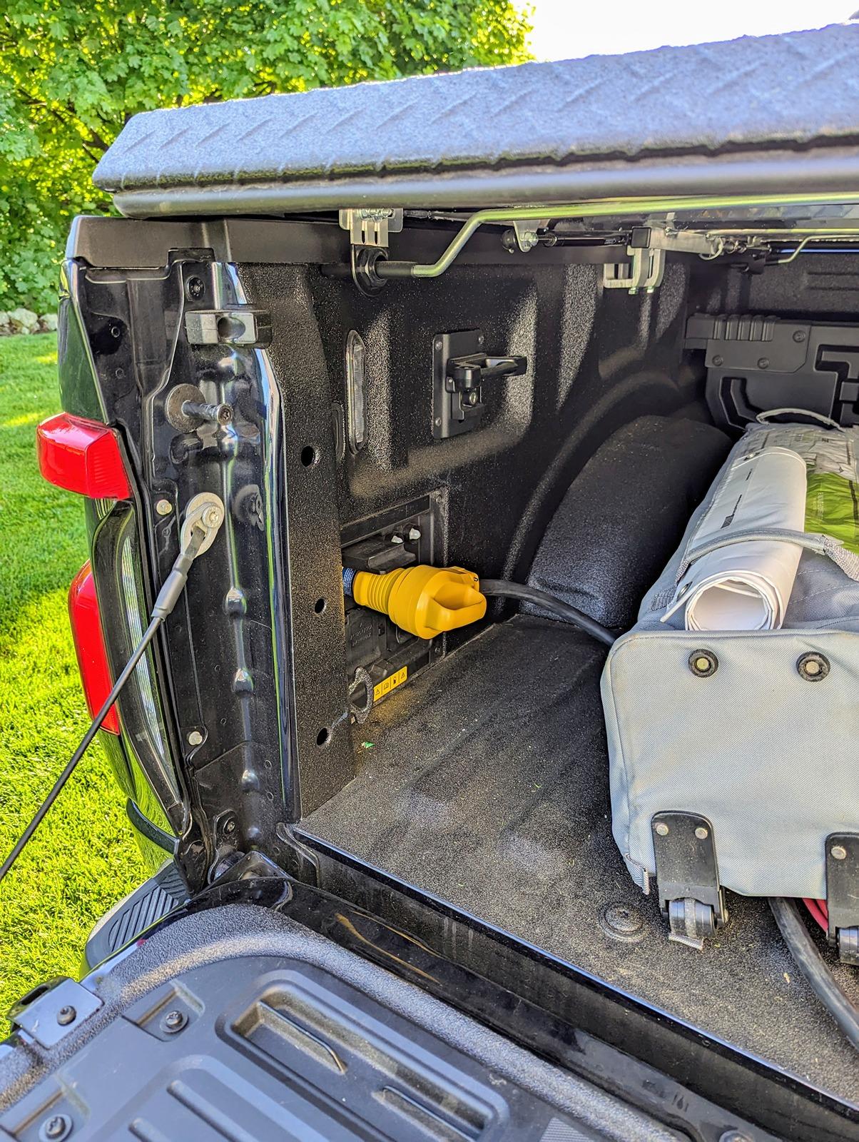

Unclear if this is a planetary scale disaster from the solar storm, or a squirrel farted on a power line down the road. But the Lightning is powering the house quite smoothly. So much quieter than my big portable generator that I normally use. Same capacity, 0% of the noise. Runs all the lights, electronics, networking/comms, fridge, microwave, well pump, and water heater etc.
The truck's overload trips much faster than the generator, so I can't run the heat pump (heat and AC) until I get a soft start installed on the compressor. The generator just sags, moans, groans, but is able to start the compressor. Weather is nice so no need for AC or heat today.

Wow! you're squeezing all you can outta the 7.2KW
Yes that was with my base load of lights & electronics, plus the well pump and tank water heater operating. If I'm running the heat pump (central AC/Heat), I typically leave the water heater off until I need to shower or something since that will be bouncing off the max load.
