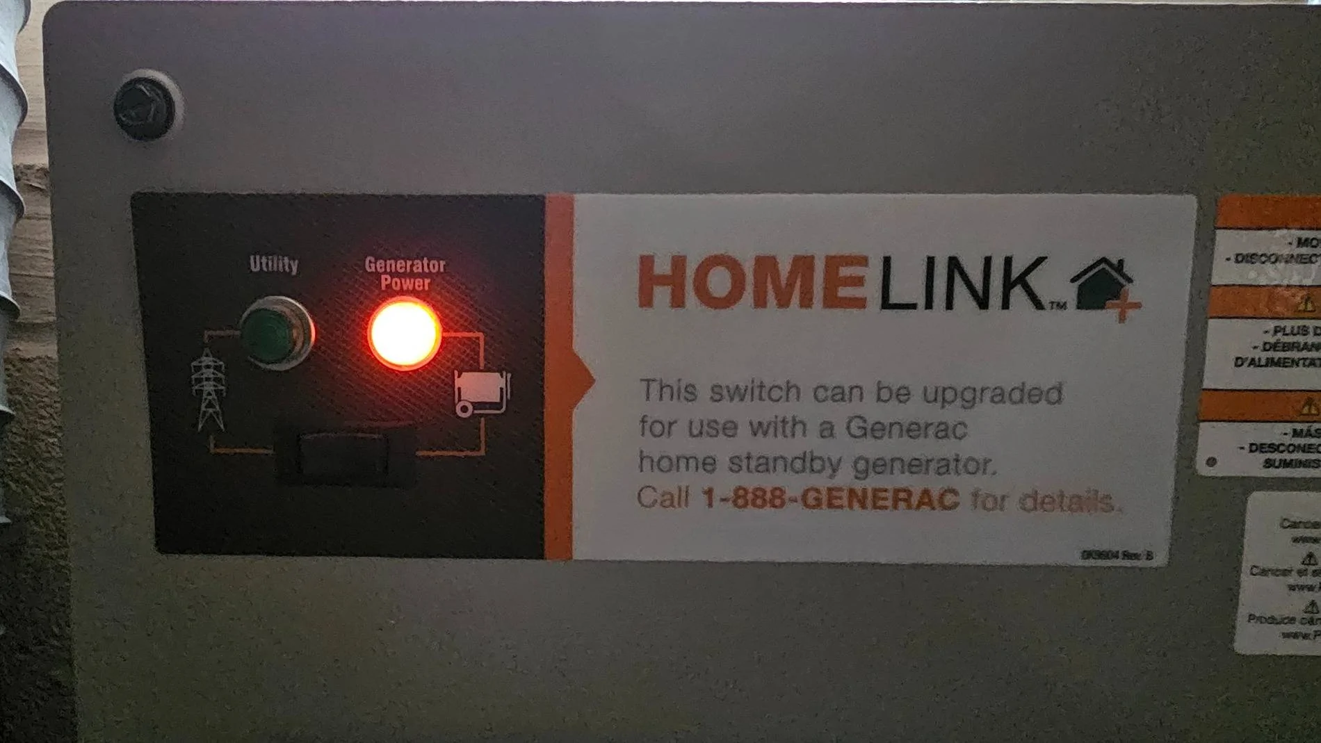

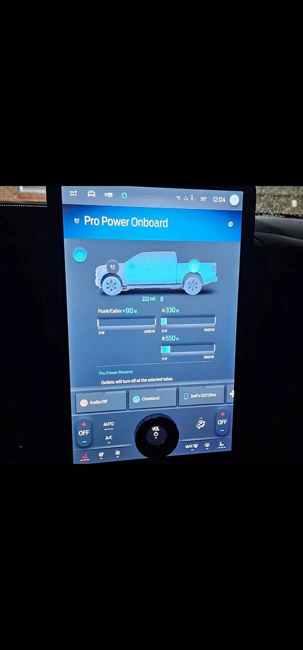

After almost 2 years of it being installed, I finally am using my Lightning to power my home! The lights went out at 11:40 am EST and they are still out 2 hours and 10 minutes later. I'm going to use my wife's car to go to work soon.
With the transfer switch, will the green Utility light light up when the power comes back on? I told her to go and look at the transfer switch every 30 minutes or so and if the green light is on, she can throw the switch back towards the green light, and the house will be on regular power again. Did I advise her correctly?
Thanks.

If your setup is anything like mine, you have a bunch of lights that aren't in the switch panel. When you notice those lights turn back on you can flip the switch panel back to utility and be on your way.
To answer your question more directly; you are correct. The green light turns on when a load is on the generator and utility power is available.

Thank you. About 30 minutes after I posted this thread, she went to check and noticed the green light was on. She threw the switch to the utility side. She then unplugged truck from transfer switch plug, then turned off truck. We figure the truck ran the furnace (33 degrees F this morning), 2 refrigerators, internet modem, 3 huge monitors and 2 computers for her job... TV, cable box / DVR, lights throughout the house and more. All of this was powered via the Lightning for about 2 hours and 40 minutes, and the battery went from 77, to 76 percent!
I'm glad I finally had the chance to use it for backup energy supply. ?
