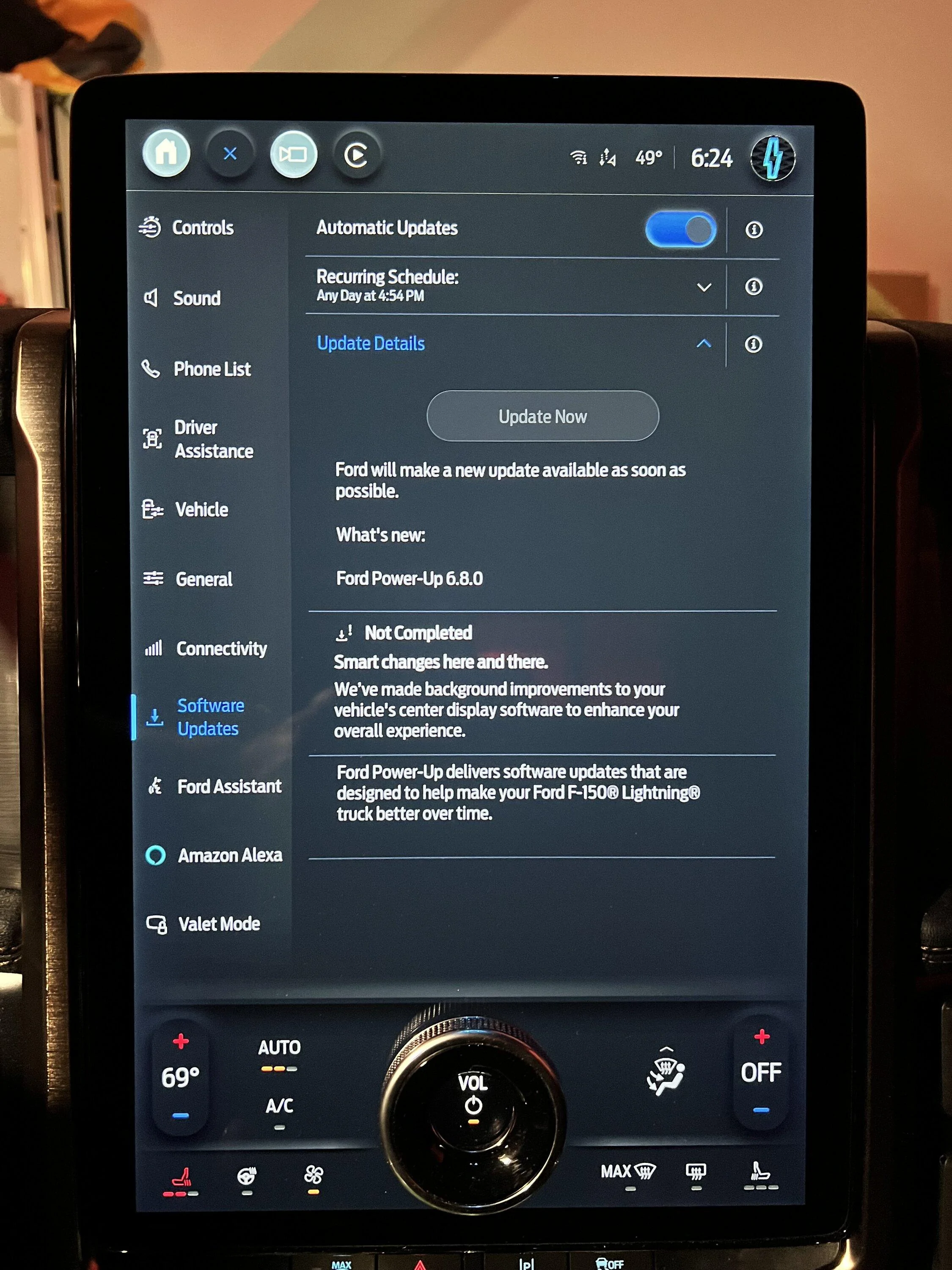

Have you tried to manually update using the update now option?
Yes, several times in various conditions, I'm really curious "WHAT" the process is that interrupts the install process and why it can't be told to us if there is something proactive we can do to inhibit said process.

That seems odd. I usually use update now because I’m impatient and never had anything interrupt the install. The only other thing I regularly do is disable the interior alarm.

I had the alarm system turned off already, but when I looked to verify, there is another switch under a drop down for the sensors, so I flipped that off too, ran the install now, and still failed due to interruption.....
I'm beginning to wonder if the truck's call the mothership, she fails to give a timely response to validate and continue the update process, seems only a few of us are running into this road block, most are getting through, my working theory is that as the deluge of requests subside, more of us will get through and the update will proceed to conclusion.

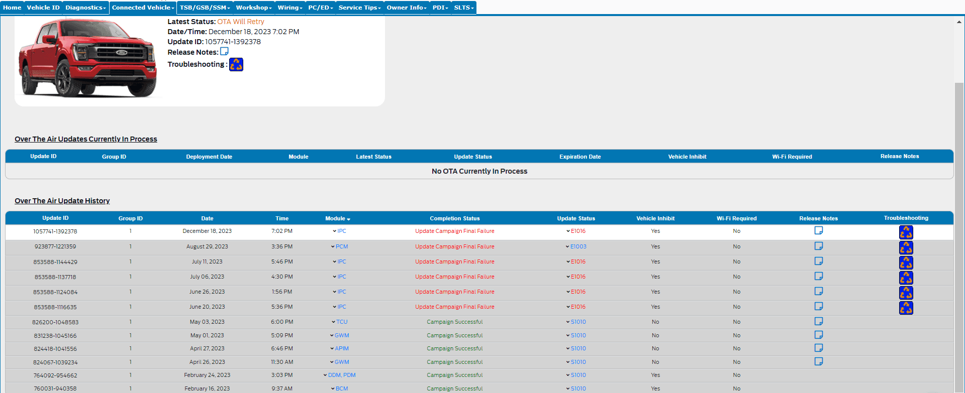

It could be worse. You could have a defective vehicle with a problem impossible for dealers to diagnose like mine where it is incapable of getting an IPC update via traditional means forcing me to install them via CAN that takes 6 hours. :ROFLMAO: It has been showing for me in FDRS for a week or so and they already tried sending it to me once. Look a little further down my OTA dashboard and you can see what happened the last time I was sent. Same thing happened two years ago with IPC OTA my truck needed to activate Bluecruise, so I'm used to it by now and can laugh at it.

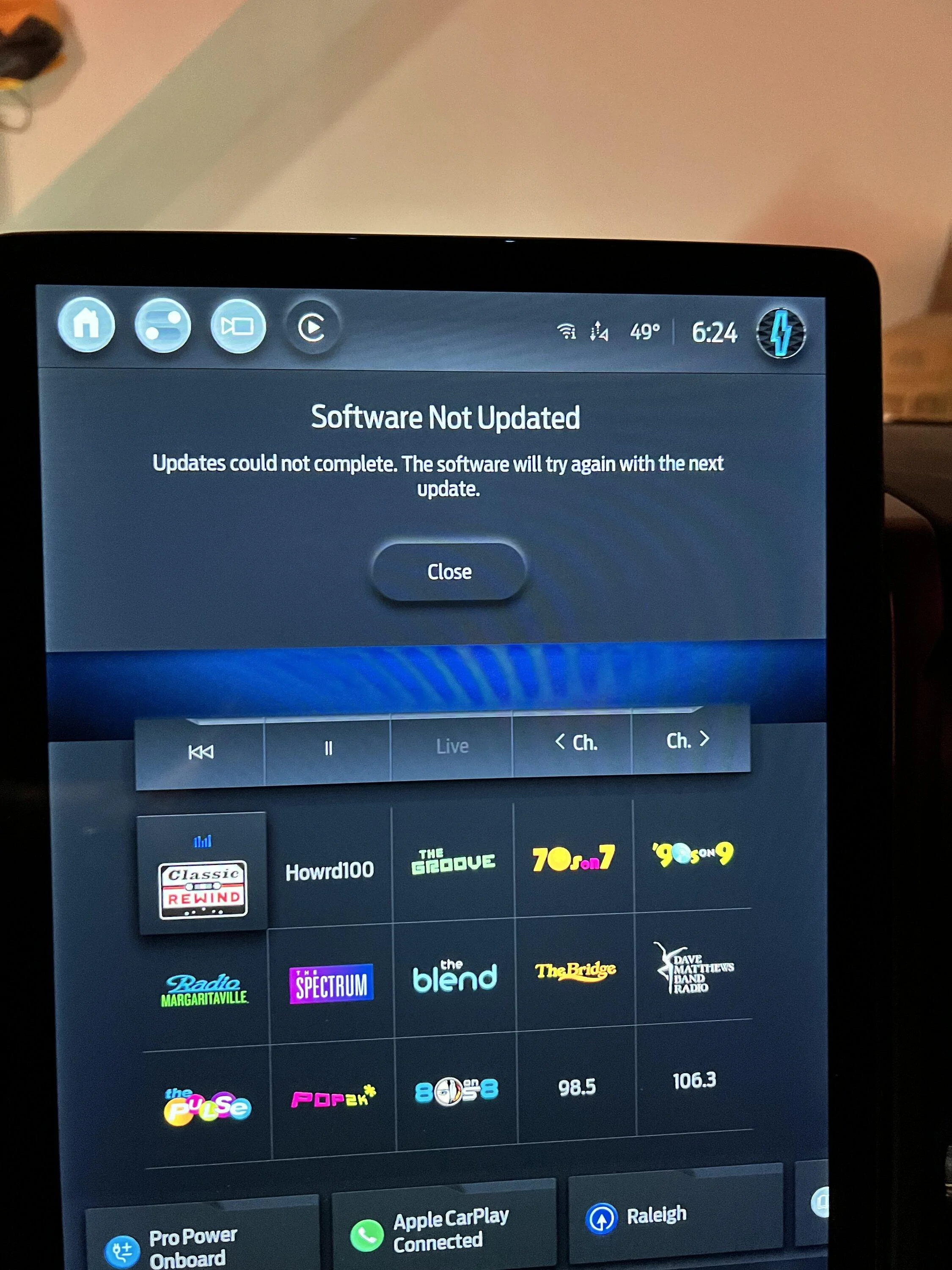

Downloaded today and failed install twice already. After the first try the 12V was at 76% so I left it on in the garage for 3 hours and it only got to 80%. I kicked it off again and it failed a second time. I’m thinking I need to keep it parked where it will be easy to tow.

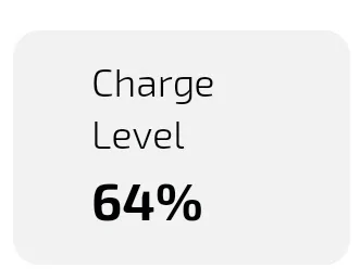

Finally posted 6.8.0 this morning, SOC was pretty low 50's when I remote started the truck at 7:40, ran for 20 minutes which helped increase SOC, drove to breakfast location, but left the truck "idling with 30 minute countdown turned off, after breakfast head home and initiated the update, SOC was in the mid/upper 80's.
Truck was parked in the driveway, shut down cell phone, moved key fob out of reach.
Waited an hour before firing up my phone, blessed to see the following. Post install SOC is at 64%

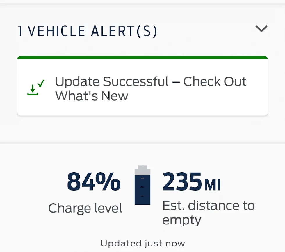

Got the 6.8 update last night and installed without issue. So happy to finally see the SOC on my dash screen and I can now use my big screen for viewing other things.

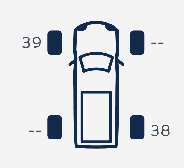

First drive after the update completed, 3 hours resting time, headed out on errands, IPC has the speed limit icon moved to left side of Speedo. No impact on my pre-existing dynamic SOC that I got last summer, 100% power was available from the battery to motors, the motor display showed traction & regeneration coming from front & rear set, TPMS straightened out to correct readings.

The last two days I’ve been running the truck and driving around to get the 12V above 80%. After 4 failures it looks like @Ford Motor Company has pulled the update for me. I thought they were starting to get the OTA process under control but it’s still a shit show. I’m doing some more research into North Carolina’s lemon law.
