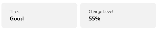

I'm struggling to get this one to install, LVB has been low today, spent time driving and standstill charging, etc. she just won't get above 55% at the moment, earlier is was in the low 40's!

Tomorrow I'll give the LVB BMS a reset and continue with charging.
If this LVB turns out to be bad, I'm going in for my tailgate light bar replacement 12/26, I'll have them evaluate the condition of the LVB, maybe get a warranty replacement???

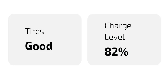

It improved overnight with the top off charging to 85% on the HVB, got me to 82% on the LVB.
Install still rescheduled to next try, what is funny is I don't get an alert of failure, just we'll retry!
Yes that message is the new norm it appears. No longer do I get a post in my Account messages. Instead just a vehicle alert. The only thing that changes is the date. And lots of nag screens when starting and stopping the truck that update failed and that another attempt is scheduled.
Mine finally updated last night after at least 13 days of attempts. I did the slow charge method. Set my Emporia to charge at 24 amps and started about 9:00 pm. It was scheduled to finish charging at 2:11 and the update was scheduled for 2:00 am. 12v was about 88% when I started the AC charge session. I’m sure it went up from there but it is only at 89% this morning.
Still plan to take it in this morning for LVB check.
Update, got back from QuickLane. They checked LVB with their tester. Took a second to find out it's rating (380 CCA, AGM) but test showed good - it delivered 488 CCA.

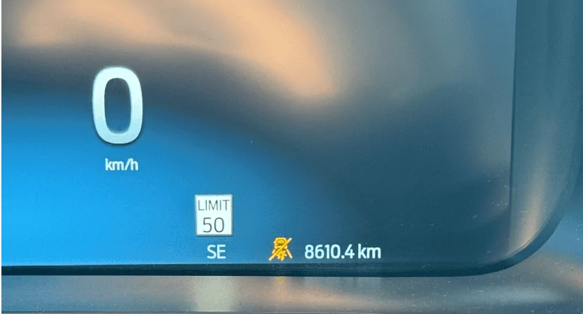

Mine successfully installed however i get the occassional warning light below in the dashboard. Anybody knows what that is? It goes and comes back…

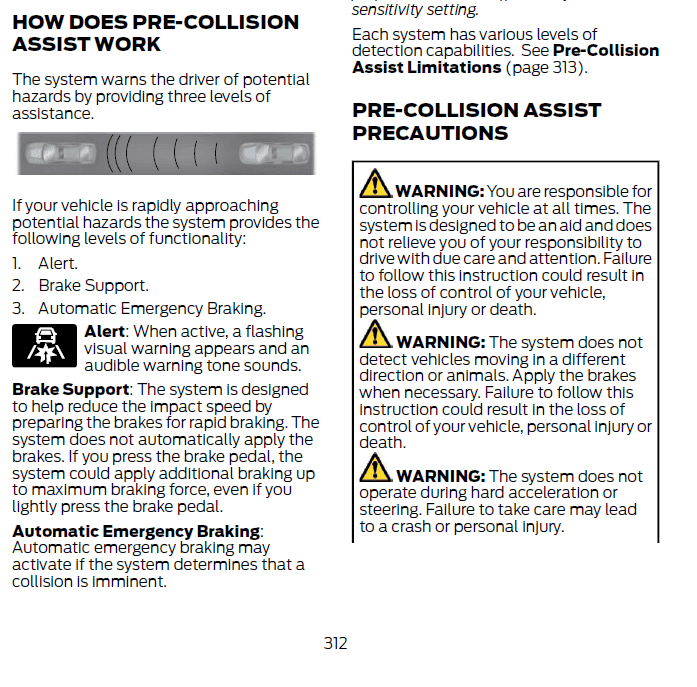

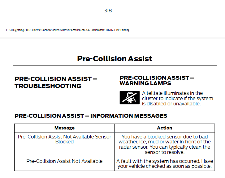

Pre Collision Assist is off or unavailable, begin reading about this feature on or around page 312 (MY22 manual)

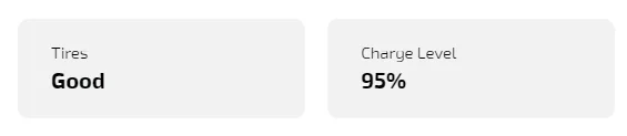

I got the LVB up to 95%, but install still failing due to "Interruption by another process"
I give up, it'll happen whenever she's ready to do it.
Have you tried to manually update using the update now option?
