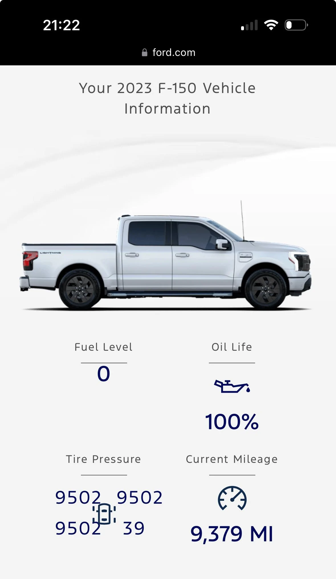

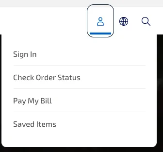

I went on Ford.com. How do I find any health info on the 12v battery? Thanks for all the info!!!
Adventureboy
Jonathan
Jan 30, 2023
1,007
972
Ontario
2023 F150 Lightning Lariat
Sign in with your account info by clicking the icon in the top right:
Ford F-150 Lightning Power-Up OTA 6.8.0 - Smart Changes: Center Screen 1703016533451
Go to your account at the top (not vehicle dashboard):
Ford F-150 Lightning Power-Up OTA 6.8.0 - Smart Changes: Center Screen 1703016615985
You should see this:
Ford F-150 Lightning Power-Up OTA 6.8.0 - Smart Changes: Center Screen 1703016712352
The Charge Level is the 12V SOC. (obviously mine has failed)

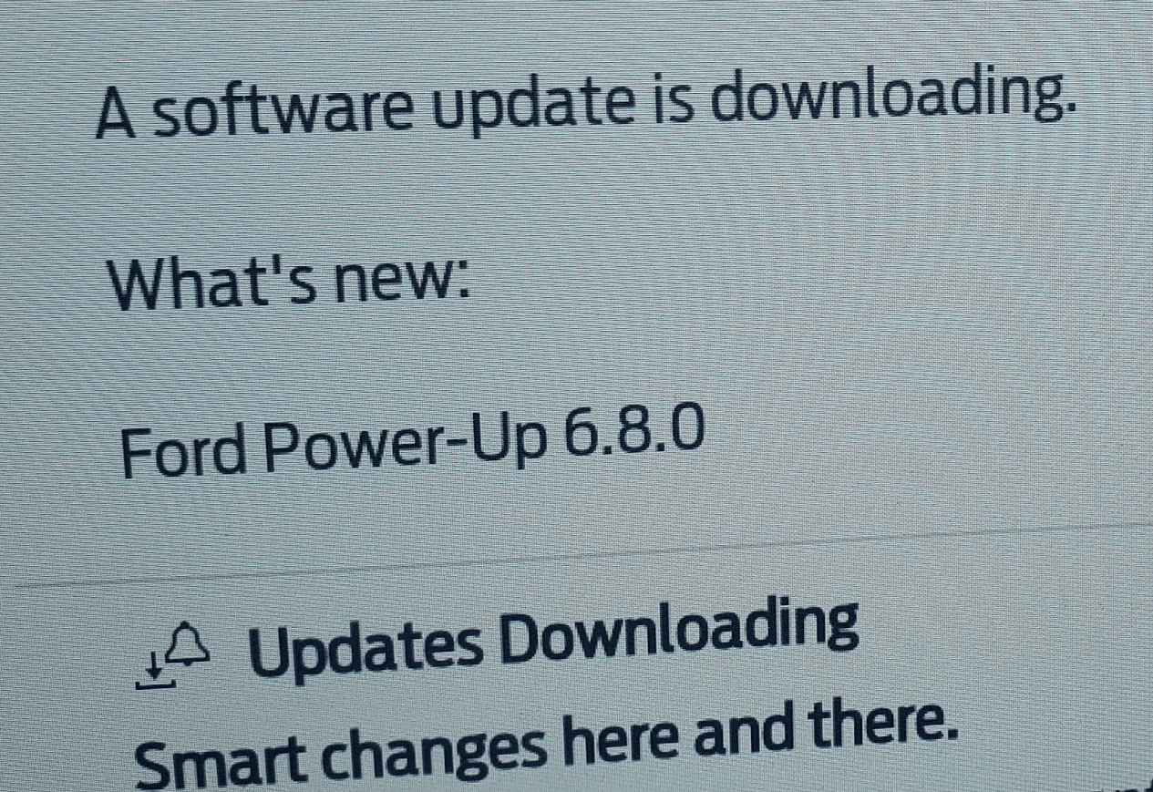

In between invidiously comparing Lightning engineering to Windows engineering, I went to the garage to check software updates. The DC Fast Charging Priority Update ...CHG3 apparently tried to reinstall itself and failed (NOT COMPLETE), whereas the first try on 12/13/23 was supposedly a success. Before I could get a screenshot of the CHG3 NOT COMPLETE notice, Power Up 6.8 started downloading. The Update Now option failed 2x with my LVB at 73% SOC (again, only the FordPass alert mentioned LVB voltage as a factor; the Sync screen told me nothing beyond powering off the truck, closing everything, exiting, and locking the vehicle). After I had charged the LVB to 82% SOC by running the truck, 6.8 succeeded. I now have the HVB numerical % SOC displayed in the circular battery gauge on the left of my Tire Pressure screen and the Speed Limit sign reader is now to the left of the dash speedometer :love: . Tire pressure readings temporarily got zapped, and I'm recharging the LVB in hopes of Santa delivering 6.13 for Christmas. My LVB SOC dropped to 72% during the update.
208
15,410
17,155
Up next:
Ford F-150 Lightning Power-Up OTA 6.8.0 - Smart Changes: Center Screen 1703084696726
Ford F-150 Lightning Power-Up OTA 6.8.0 - Smart Changes: Center Screen 1703084720231

Hey we’re on the same track now. I just updated to 6.8.0 as well.
We might see BC 1.3 before next year yet. After all we still have 11 days for Ford to make good on their promise of ‘by year end.’?

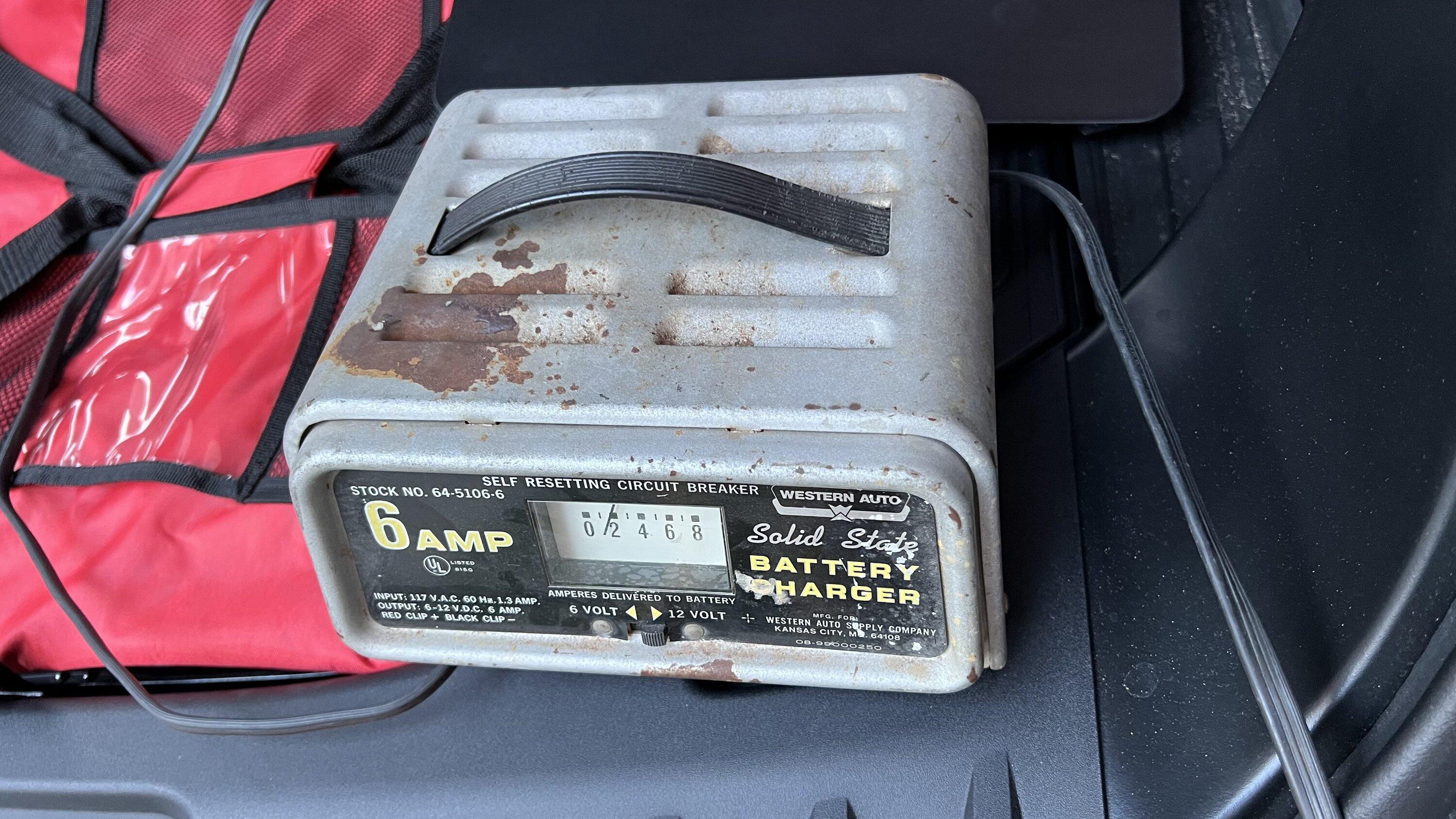

This is my fourth update in less than two weeks, and the first ever that's failed. Dusted off my trusty 1980s vintage Western Auto battery charger to give the 12 volt battery a boost. That charger may be the closest thing I have to a family heirloom :)
