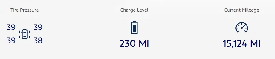

Sorry if this has been covered and I missed it. It’s hard to keep track of all the changes. I believe this is the thread where many of us learned that the charge level on the dashboard on the Ford website was actually the SOC for the LVB, not the HVB. Except for a Canadian writer, whose charge level showed Km, not a percentage. My dashboard on the website now shows miles (equal to the miles shown on the app), and not a percentage (which it used to show). Do we know what changed? Is there now no way to see LVB SOC without a reader? I’ve had no updates to the truck. Thx.
This link shows: tire status, LVB SOC and miles of range
https://www.ford.com/myaccount/account-dashboard

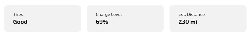

This link shows tire pressures, HVB range in miles and total mileage
https://www.ford.com/support/vehicle-dashboard/?gnav=header-account

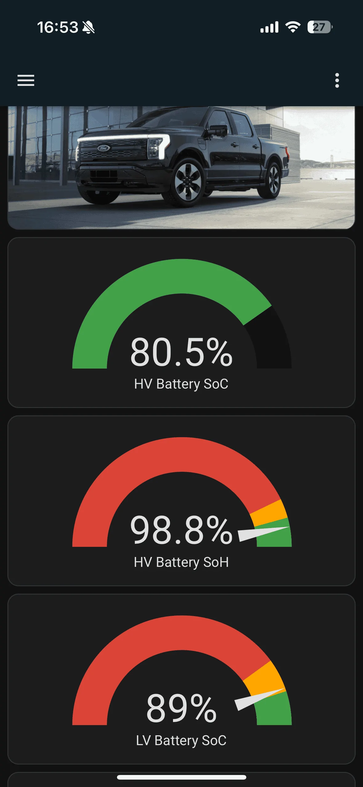

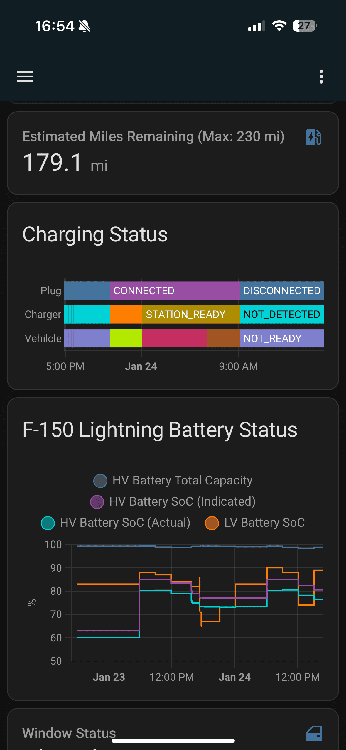

My BMS is the recalled part and has been acting funky lately. All of a sudden about a week ago my LVB started reporting 10-15% lower than actual (tested resting voltage several times and was typically showing 12.7v+ /80%+-). I have the Ford Home Assistant integration and set up a nice dashboard (see attached)
The first attempt to install 6.8.0 failed and the LVB was showing down to 40% after the attempt. I charged the LVB with my Schumacher and reset the BMS. the LVB was reporting 90% when the wife left for the school run the next morning.
I manually started the update when she got home and went right through. LVB reported 75% after the update. Took the truck for a spin and LVB was back up to 90%.
probably going to order the improved BMS part and swap it myself. For ~$20 it’s right on the edge of being worth the time and headache of the dealer. Unfortunately I don’t have mobile service near me

If you’re referring to the 12V battery SoC, you can see it in your Ford account at Ford.com.
Thanks Maquis. Took me a while to find that page. I assume "Tires Good" means pressure are within spec?
Mine are kind of low on pressure, not enough to trip the instrument cluster alert, that might cause this condition code to change if one or more tire get too low.
