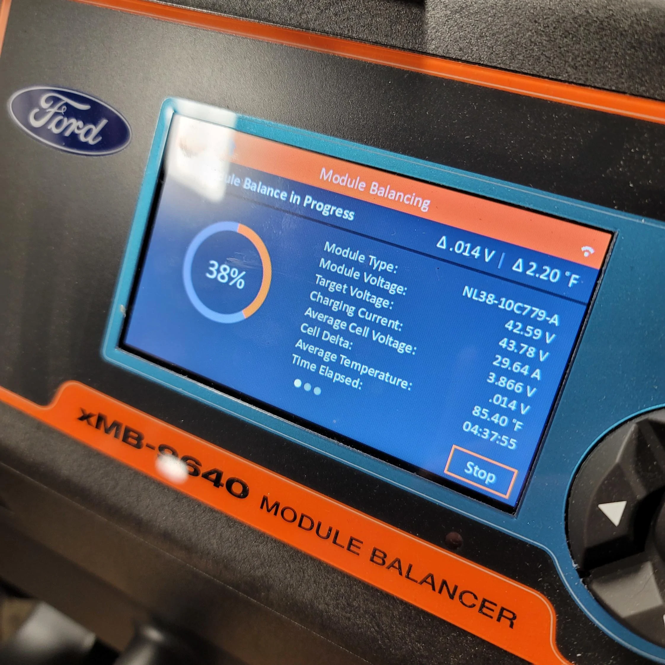

My dealership's EV Tech (4 year Automotive Technology degree from Weber State University) is having major issues with balancing modules, even with Ford Engineers in Dearborn assisting and use of the XMB-9640 Module Balancer. Much more is involved than exchanging modules. Also, voiding the 8 year / 100,000 mile battery pack warranty would surely occur with repairs by anyone other than Ford.
Could you tell me what the dealer should have done in balancing. Mine came back with no indication of charging done (at least not from the app screen) at roughly the power level I dropped it off prior to replacement of a module. I know they don't have a high power charger and it was dropped at my house in less time, from the start of repair, that a level 2 charger would have taken to refill a battery if it had been drained prior to repair. Range was off (along the lines of 8 filled and one empty module) till I ran it down to near zero and then charged it up (still doesn't look quite right but close enough). Nothing on the repair description that says anything was done but not sure they would have written anything up.
If they didn't balance it, it would throw a fault. It is statistically impossible for a service array to arrive at close enough voltage that no balancing would be needed. So, no fault after the repair, you should be good
I have attached a link to the module balancer they use, and a photo of its data screen with my battery. I agree with Gimme_my_MME that you would very likely have gotten error codes if they did not balance the new module with the original modules. MickeyAO provides details at post #240 in this thread.
https://www.midtronics.com/ev-solutions/xmb-9640/
The balancing is done when the battery pack is disconnected from the truck. Essentially it's a special balancer (see post no. 248) that balances the new module(s) with the existing modules. Since the truck is disconnected there would be record of it in EV charging history.
I recommend anyone taking their truck in for a module replacement have their truck between 40 - 50% SOC. The tech that did my repair said this is the sweet spot. He didn't elaborate on whether they have to bleed off power if the truck is above a certain SOC.
