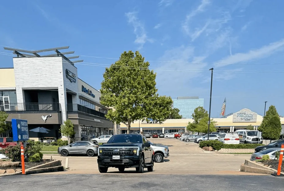

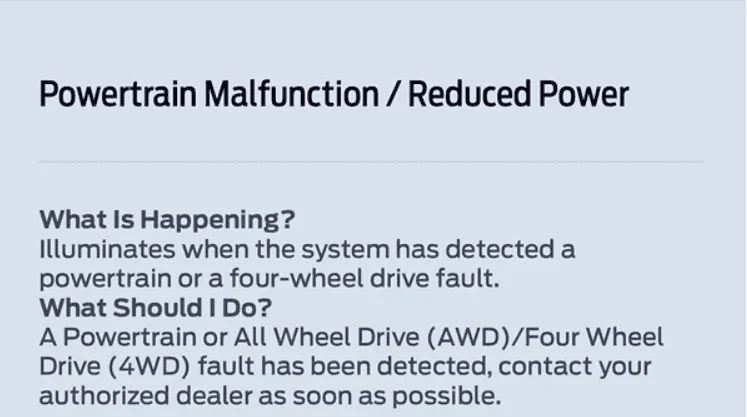

I got my 2023 lightning in march of 24 with 200 miles and 9k plus miles later I get a power train malfunction/ reduced power message and could not drive the truck. Took family to the mall. I had to remove the 12 volt battery to reset, this was a week ago. Well tried to park the truck properly this evening and the same problem again. This is exhausting, repeated the same process to get it to move. Taking it to my dealer this morning. I can’t imagine it happening while my wife or kid was driving.

Hello the truck totally stopped moving right by a dealership. VIN#. Mileage is 9658. I am left without a vehicle now. This is unacceptable especially when I paid $90,000 for a truck. The dealership does not know how long it would take to get it fixed.

Just the powertrain failure and high voltage battery warning
