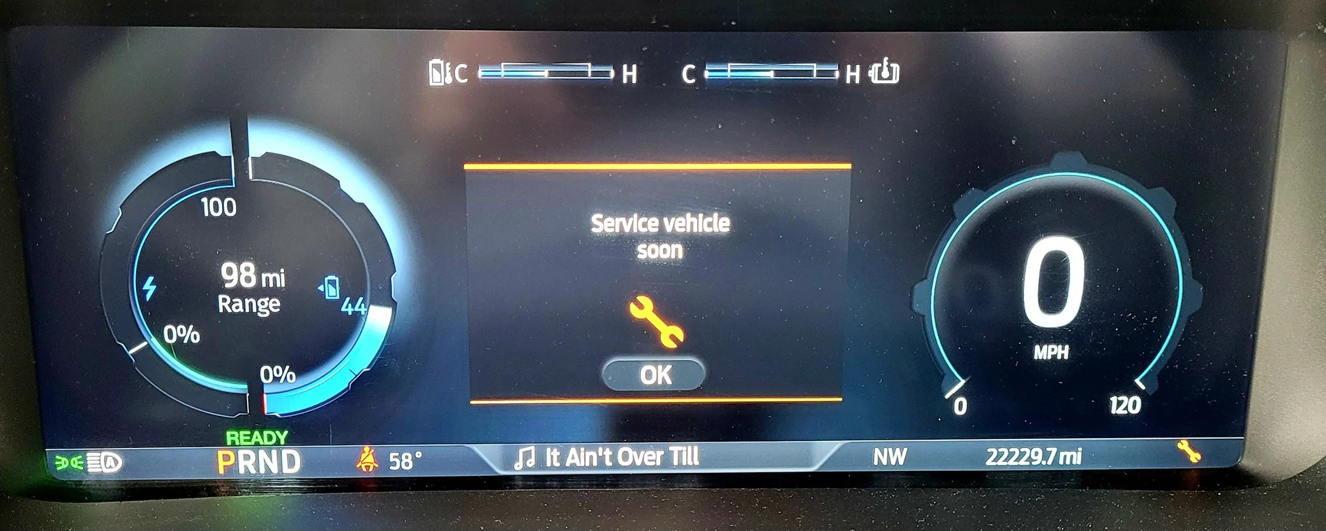

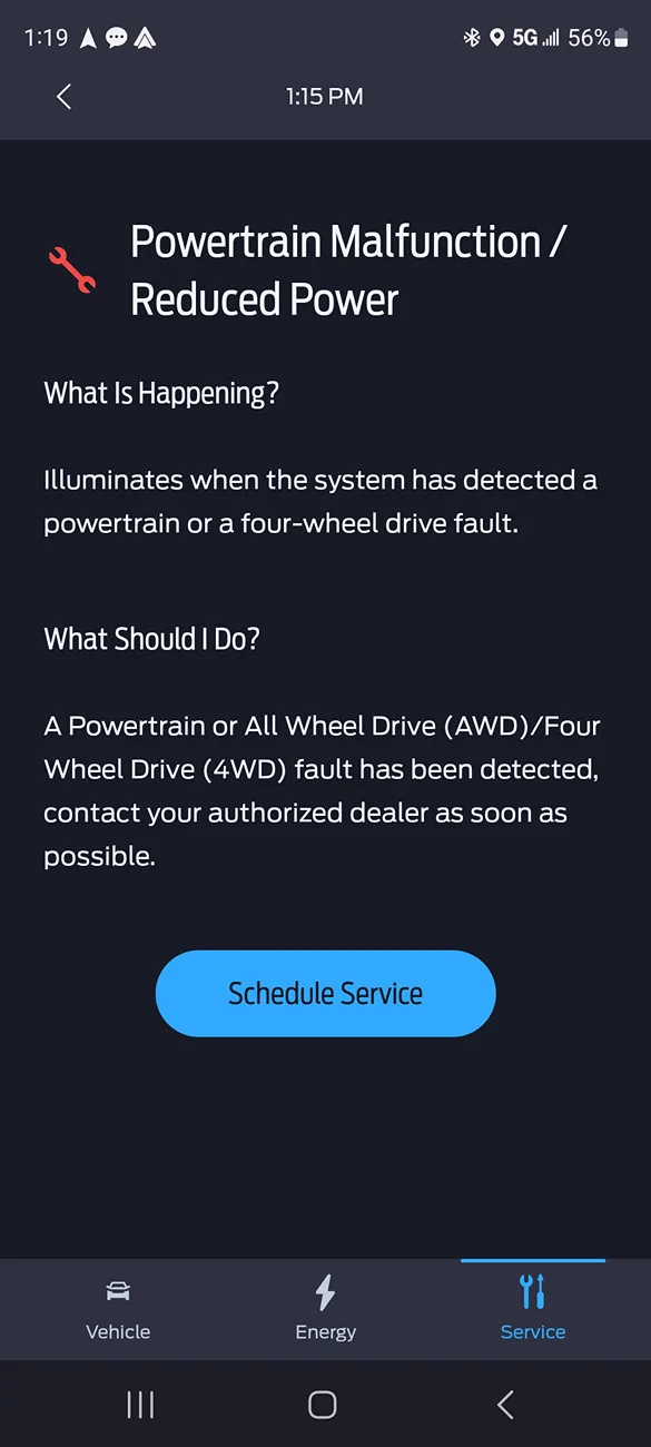

After raving about how flawless my ride has been, today I got the wrench. I read some of the related threads where people had bad modules and shifter issues but I still can't tell which group of unfortune owners I belong to. Here is the short story;

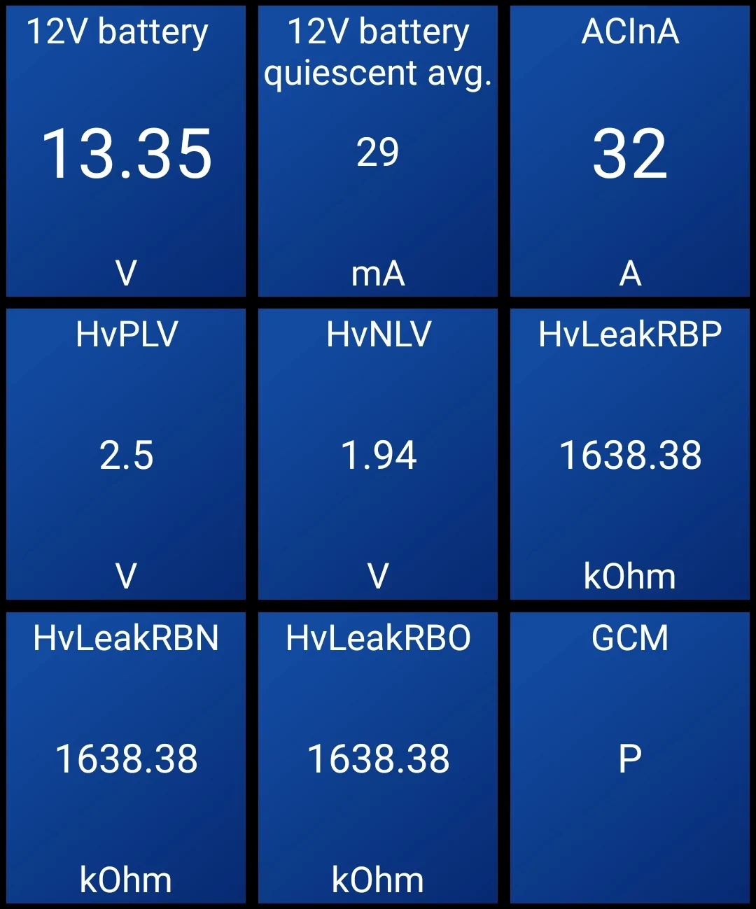

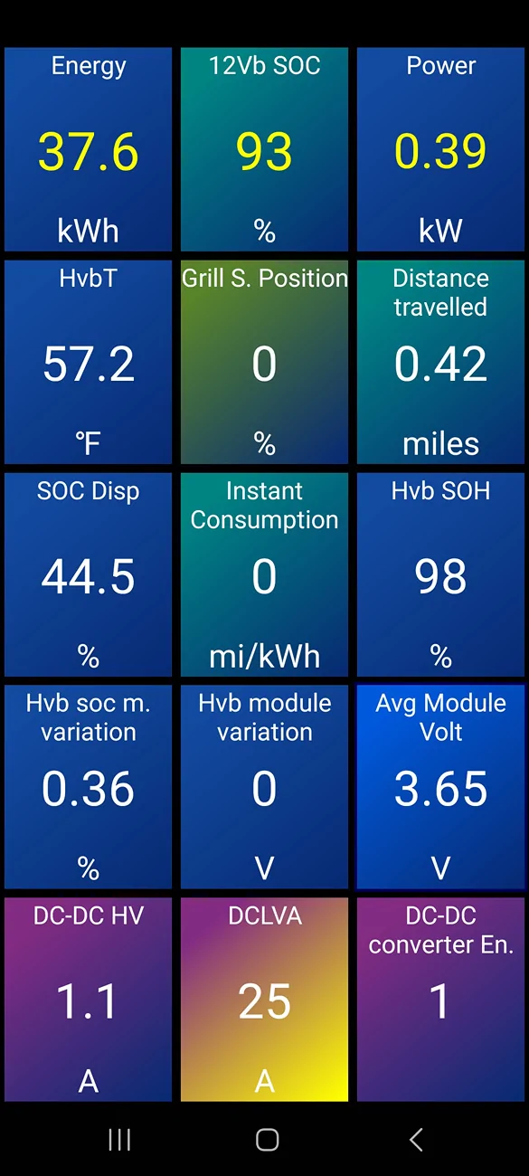

I left the driveway in rain and 4 minutes later I got the wrench but my power was at 100%. Dropped to 95% later at night. I tried the wistful thinking thing (turned off the power and back on twice). The wrench went away. I plugged in for a minute to see if it charges OK. It seemed fine. Got back on the road and wrench came back in less than 3 minutes. I checked the voltage variation with carscanner and it didn't look too bad. I ran the trouble codes (attached) and I have no idea what I am looking at or should be looking at.

This happens normally when state of charge is lower and the battery is cooler. The lower the soc, the lower your available power.
The powertrain malfunction is essentially a check engine light, could mean several things from serious to mundane.
