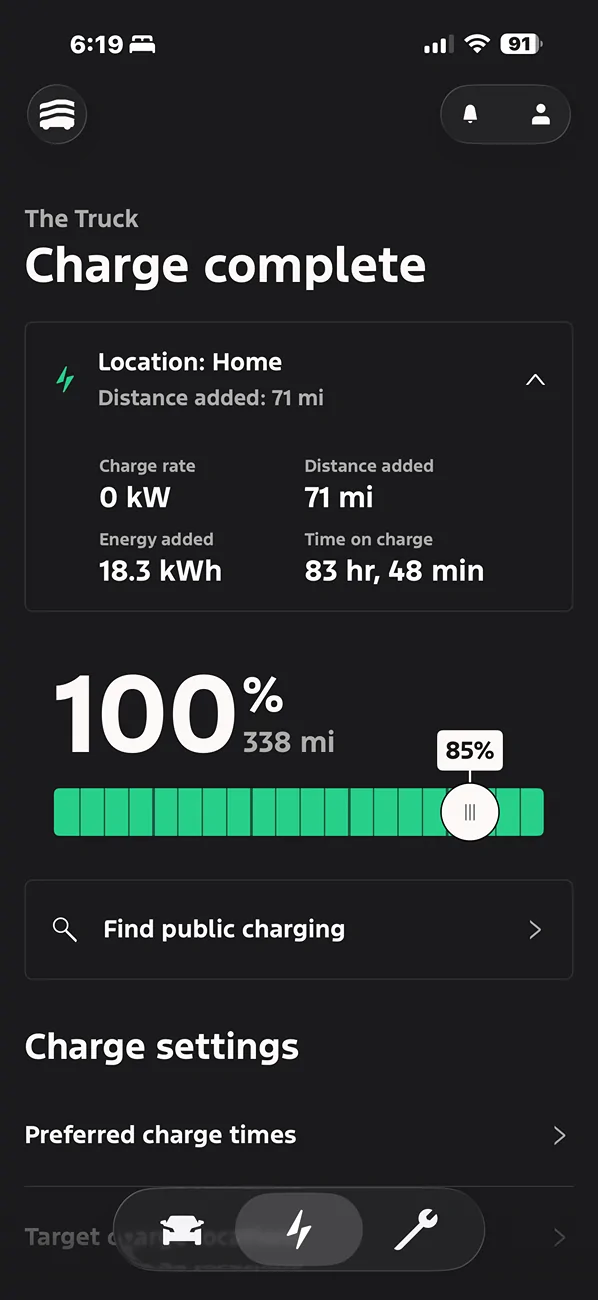

Just completed a call with Ford Battery and charging tech support. They shared there is a known issue with preferred charge times not working for some vehicles and they are working on an OTA update. They recommend to manually plug in and manually start charging until a fix is released. Sharing the info to help others avoid waking up for a trip and finding the truck opted to not charge over night. I have a 2023 Lightning Lariat with about 50,000 miles on it that I’ve owned since new … and Love:).
Background - additional info.
- Haven’t knowing changed anything with my charging system or home network for months.
- my truck has been charging the preferred times at two different locations defined in the FordPass app reliability for several months (actually for a couple years).
- all indicating lights were normal when I went to bed last night and the app stated ‘ready to charge’. The battery was at 37% when I went to bed and the same when I woke up. .
- no error messages on truck or app. Lights normal on charger.
- In truck charger app shows the preferred charge time.
