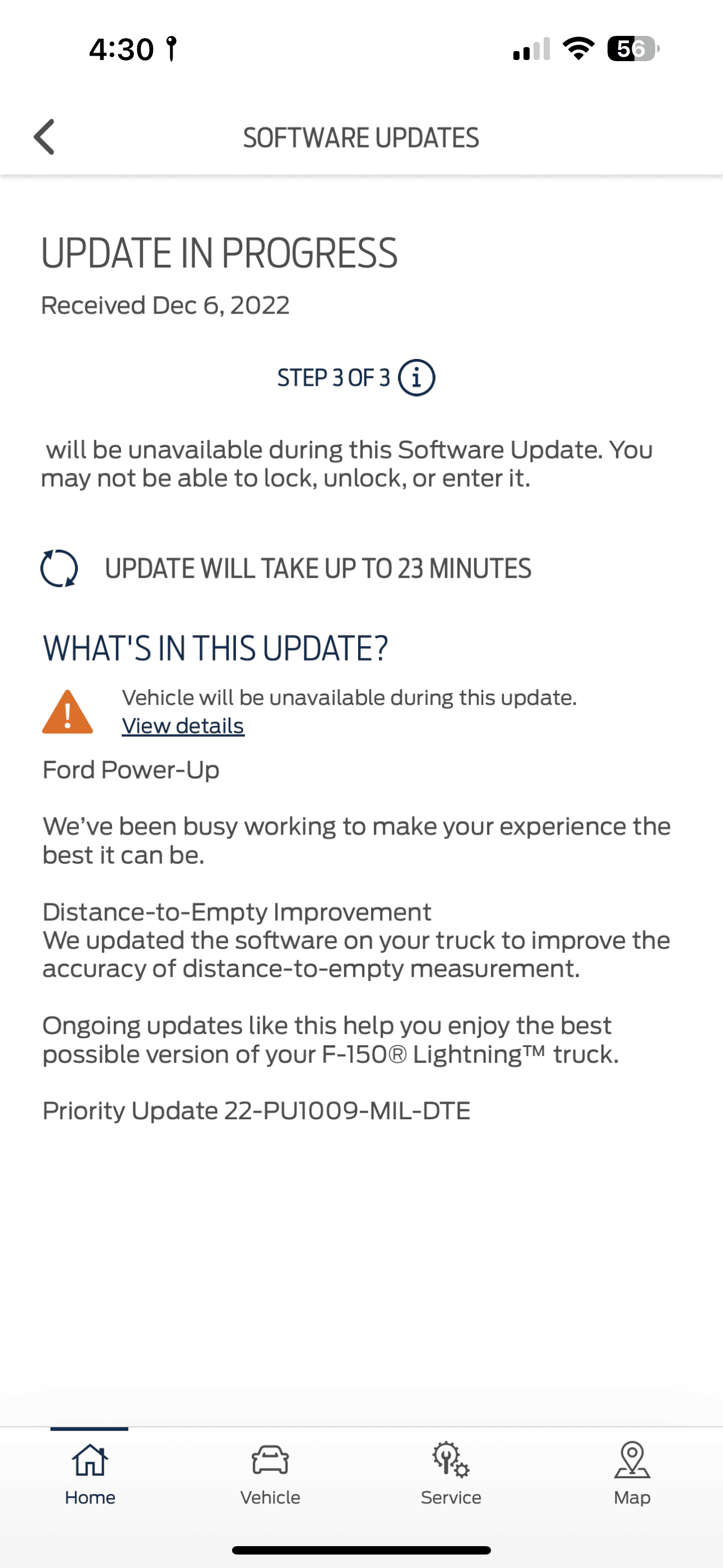

Coming on the heels of another Hoovies Garage Lightning video , we have a brand new (not 3.5.5) priority power up update installing on my truck right now.
Of note : I did not receive 3.5.5 and this is one of those separately numbered updates like the tire pressure recall / phone as a key / and now this targeted distance to empty Update
Ford F-150 Lightning Priority Update: 22-PU-1009-MIL-DTE Calculation E47B701D-D144-4241-9250-09788B7191E2

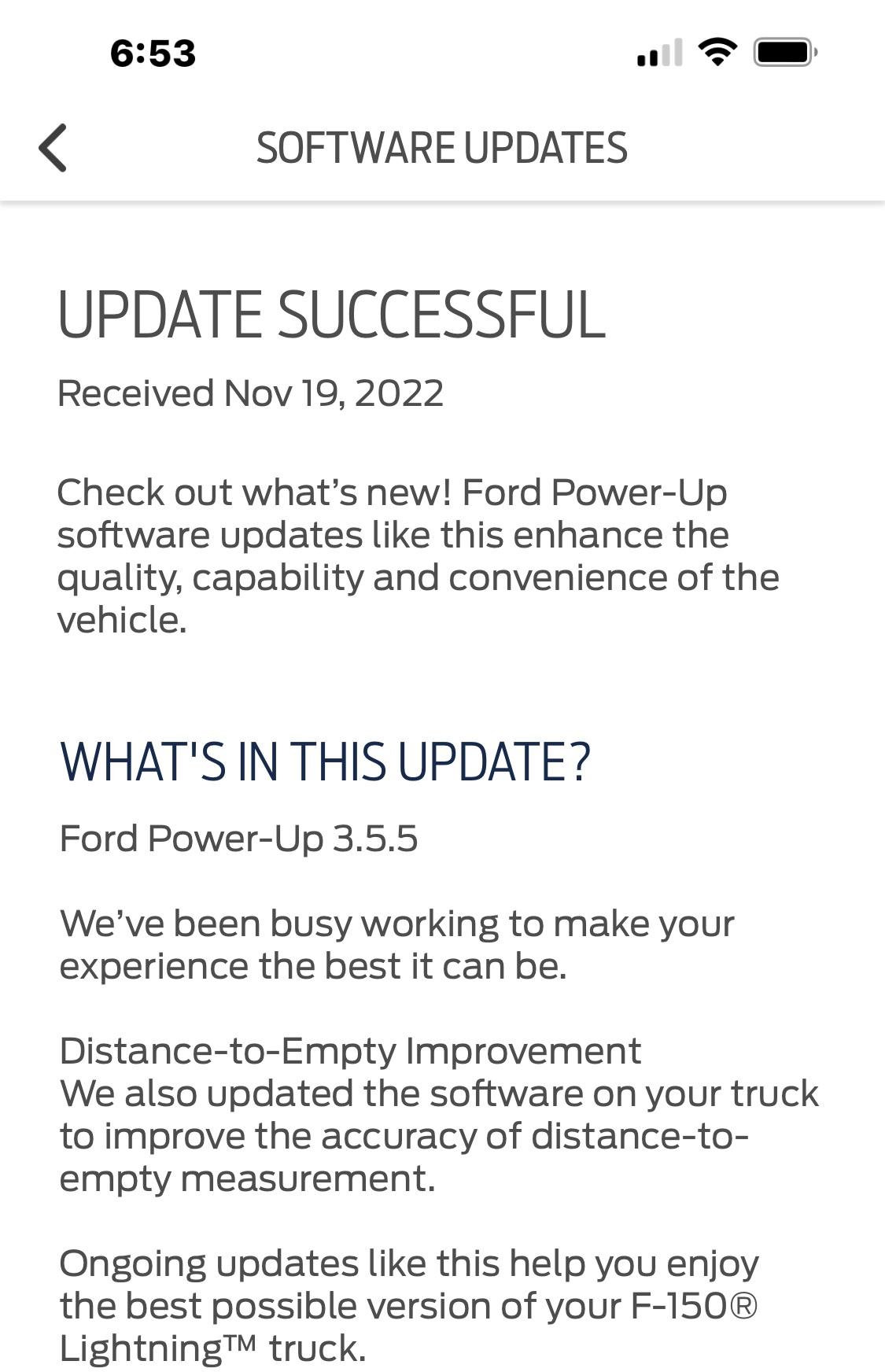

Got 3.5.5 last month.
@Ford Motor Company I deserve to be on Ford's Early Adopter / Early Access program!
If it makes you feel better, I am in the early access program and am still waiting on 3.5.5. and working preconditioning.

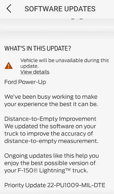

Update to Distance To Empty calculation.
Ford F-150 Lightning Priority Update: 22-PU-1009-MIL-DTE Calculation 1670382959105
Ford F-150 Lightning Priority Update: 22-PU-1009-MIL-DTE Calculation 1670383018827

Interestingly, when I went out to get my evening coffee run in, the truck prompted me to review a pending update. also got what you have above.
I started a new thread with a poll attached to track who get it., might merge this thread into that with the poll

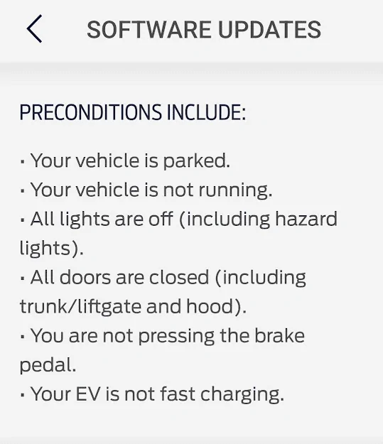

My update failed to process, two manual attempts and the overnight scheduled event failed.
Folks have found the LVB 12+ is not always up to snuff and a long drive in the truck tends to create enough time to charge it up to the value needed for the update to proceed, I'm going to take her from a long ride this afternoon.
