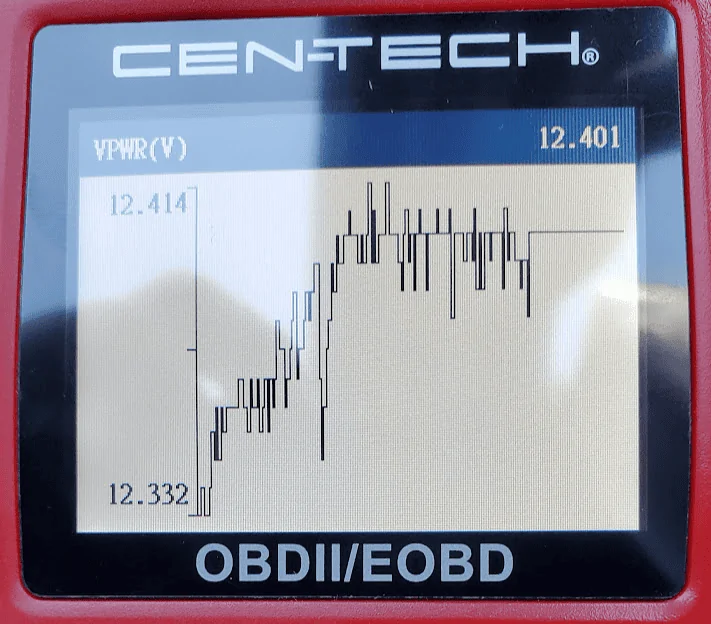

I plugged in my old school OBD2 code scanner and ran a couple tests, when I power off the truck the static voltage drops to around 12.332v while accessory loads are still active, when I open the door to cause the accessory items to shut down the static LVB level rises to 12.414 , wondering if that is too low to allow the update to start?
Ford F-150 Lightning Priority Update: 22-PU-1009-MIL-DTE Calculation 1670601679757

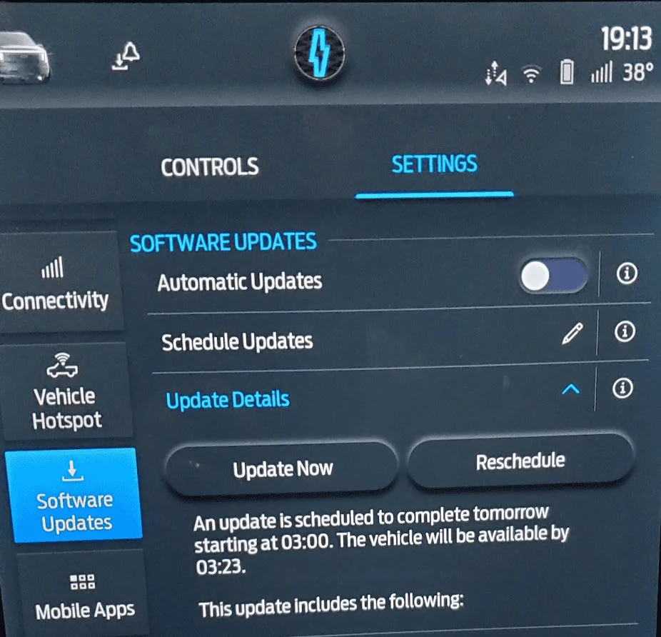

The previous attempts were never successful.
While tinkering with the PAAK re-setup, I noticed the Software Updates screen now shows this, which also failed to install immediately, so I will let automatic update try overnight. BTW, not specifics about what this update does or a version number.......[[ NOTE the switch for automatic update is now on after I took this shot]]
Ford F-150 Lightning Priority Update: 22-PU-1009-MIL-DTE Calculation 1670720501328
