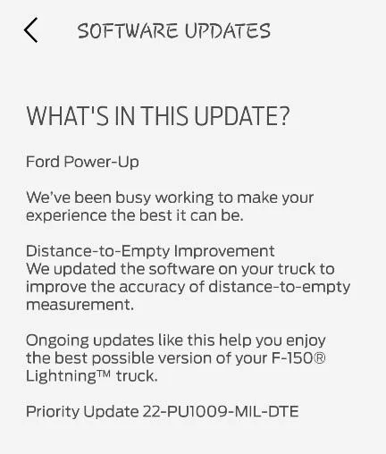

Got PAAK update about two weeks ago. Been working perfect. Got the notice about an hour ago for 22-pu1009-mil-dte I will let everyone know. FYI, I just have my updates scheduled for midnight every night. I don't mess around with manually approving it. So far I've never had an issue... Knock on wood.

Ford F-150 Lightning Priority Update: 22-PU-1009-MIL-DTE Calculation Screenshot_20221212-202628_FordPass

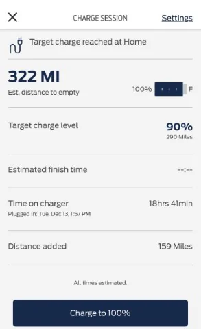

I got the notice a couple days ago. I have updates scheduled for midnight. Last two nights got the update failed message in FordPass shortly after midnight. Yesterday tried the Update Now and it failed about 5-10 minutes in. Plugged in charger and still failed. Left it on charger and charged to my default 90%. Left on charger overnight. This morning I get the notice that update is installed. And that apparently also reset charge level so now I’m at 100% and 322 mile range. But it also shows I’m home with a target of 90%.
Ford F-150 Lightning Priority Update: 22-PU-1009-MIL-DTE Calculation A11D1112-5849-4EA2-9BF3-23B463771CCF (Small)
