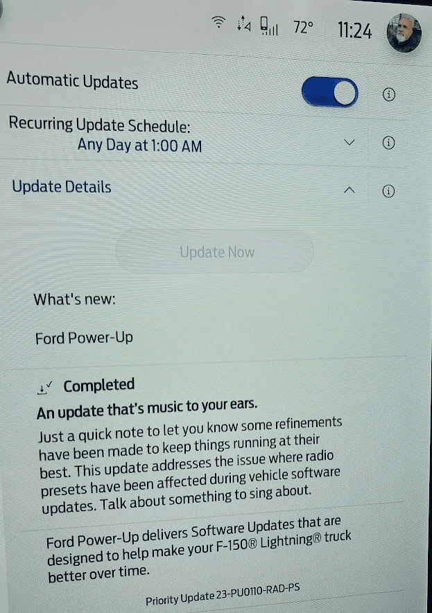

Yup, my efforts in this fashion paid dividends!
I figured even if there is a slow drain on the LVB, eventually it gets low enough to trigger the DC/DC charging cycle and top's up the LVB SOC to a satisfactory level, at 11:10 am we were back at home, so I kicked off the update process after sending the wife into the house with the key FOB, I shut down my phone, then the truck, locked the doors and sat there through the process.
At 11:24 it finally completed after observing the process, clicks, humming of the coolant pump for a couple of minute, more clicks and finally this, BTW I've never had an issue with lost pre-sets, and today the remained as reliable as before. Took a quick look at the onboard owners manual, didn't a deep proofread.
