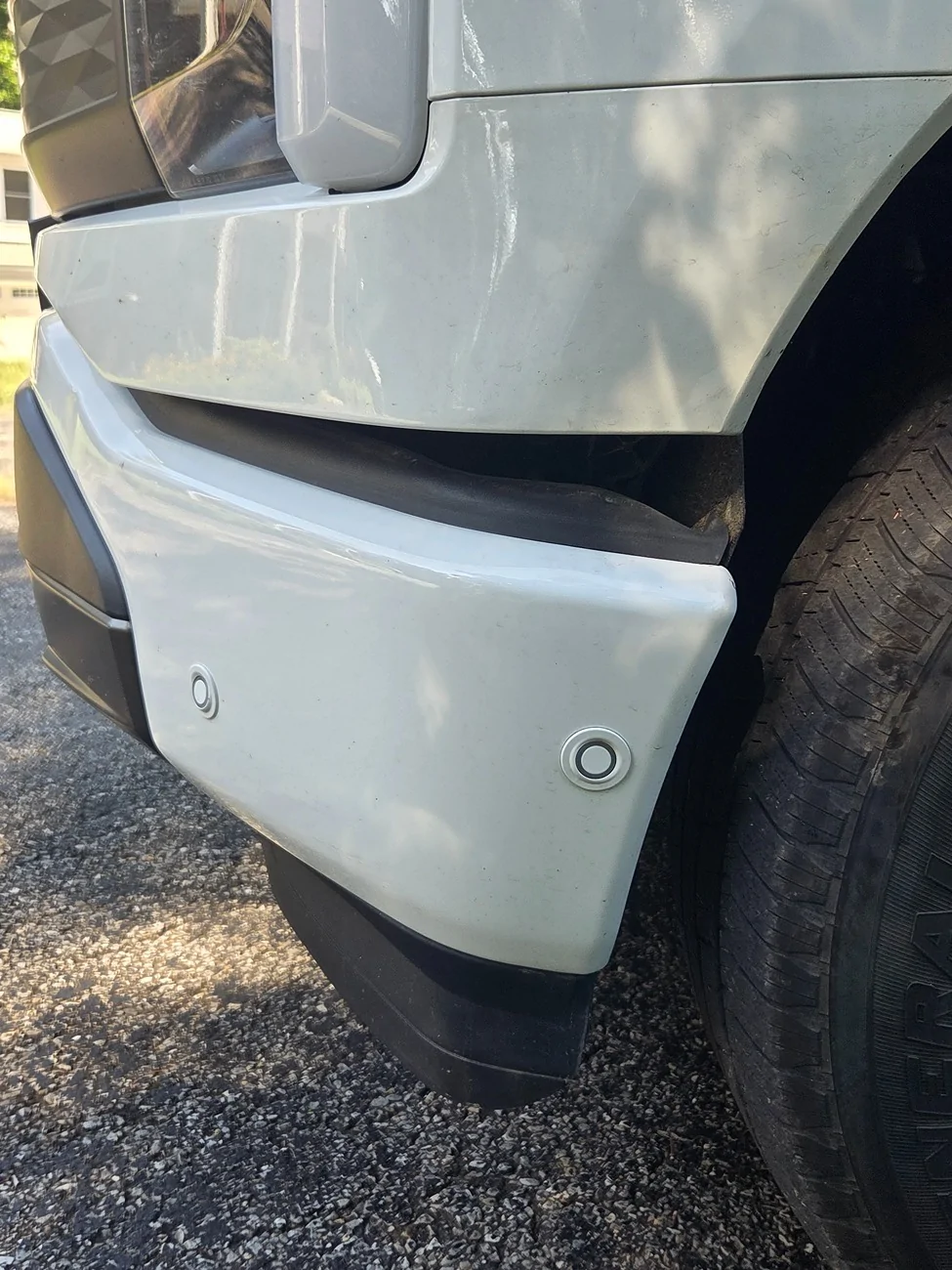

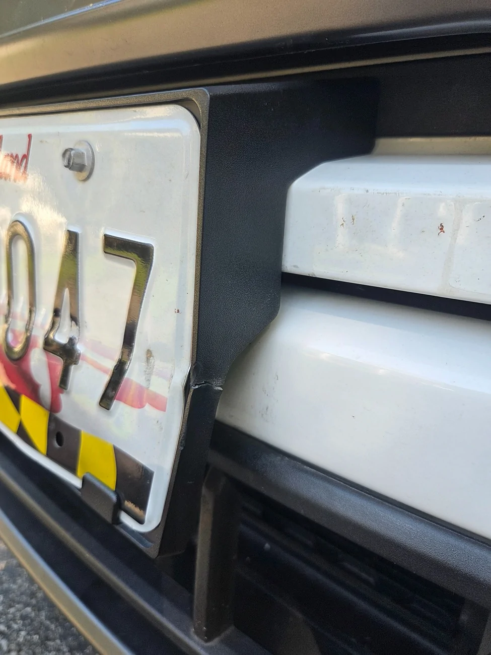

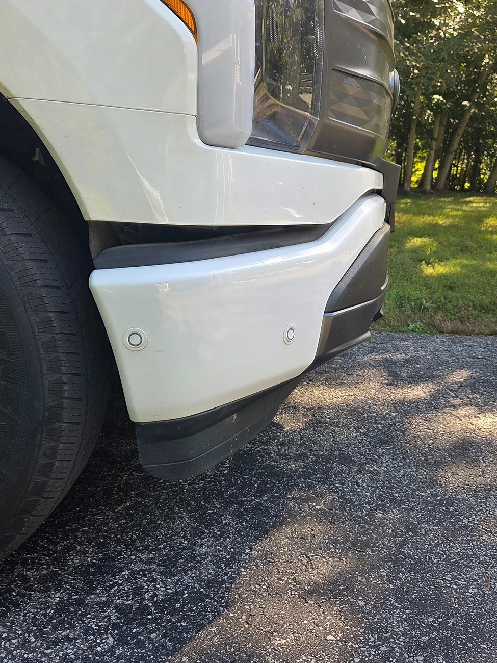

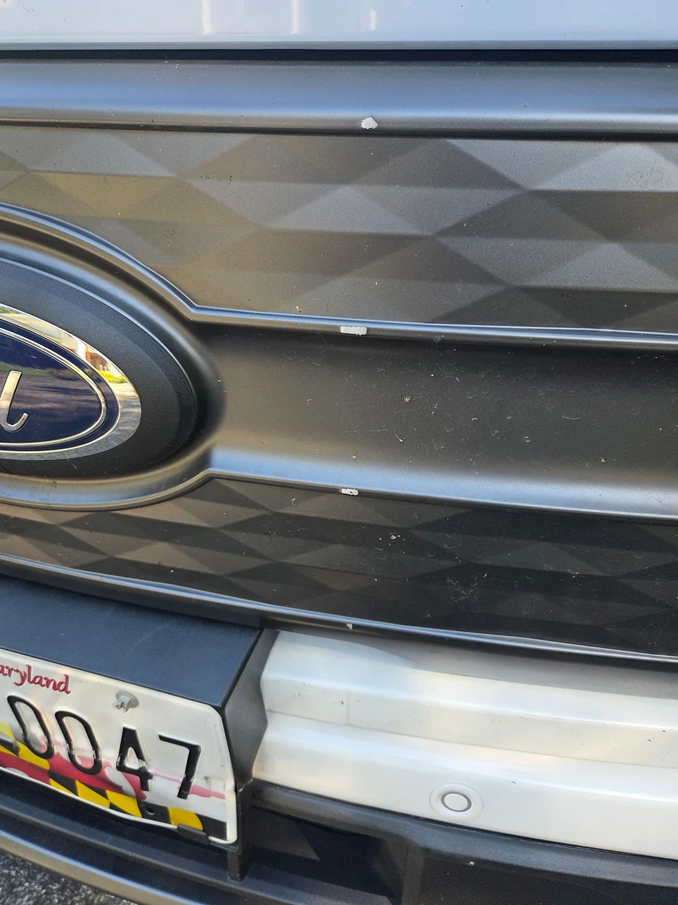

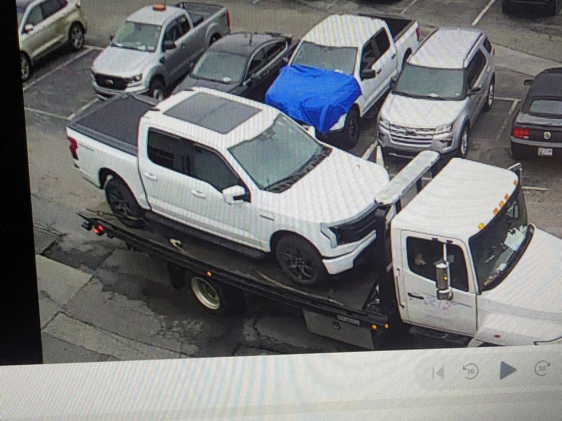

Taxman expressed an interest. So here it goes.
Ford Roadside Assistance sent a tow operator to pick up my Lightning that bricked due to a Ford OTA. This was August 19th.
It was taken to the dealership for repair. I was called on August 26th that the repair had been completed (It wasn't) and when I went to pick it up, it looked like the attached photos. The front bumper is almost ripped off. To be clear, the Ford Customer Relationship Center insisted I contact FRSA. FRSA emailed me a form to complete, also wanted photos and an estimate for the repair. I gave them everything they asked for. This was also on August 26th.
Ford uses a contractor for FRSA. The name of this company is Agero. So a case manager, Dennis Warren, emails back that he got my info and someone will contact me to record a verbal statement. On September 3rd they called me to record my statement. Just missed the call, I immediately called back but all I got was VM's. Called 6 more times and emailed 4 times. They finally called on September 5th and I gave my statement to Jackie Munoz, Dennis Warren's supervisor. She doesn't return VM's either. During that conversation i asked when I would be compensated for the damage. The estimate is $3,500.00. She said that case would be completed on September 10th and I would be contacted. That date came and went so now I'm getting really angry.
All through this i am dealing with the Ford Customer Relationship Center about my Lightning. When I ask (several times) for help with Aegro Ford offered me absolutely no assistance. And insisted that they couldn't help because Aegro was a separate company. Even after I reminded them that we wouldn't be here except for the fact that a Ford OTA bricked my truck and Ford contracted with Aegro to admin FRSA. And FCRC told me to call FRSA. If you don't get the initials all you need to know is the first letter stands for FORD. Sorry for the sarcasm but I can feel my BP going up just typing this stuff.
I finally got some help after Brian at Ford who monitors this forum contacted me. So Ford finally contacted Aegro and Dennis Warren called me and apologized for not returning my calls. What BS.
So he tells me i would receive a check in the mail for $2,700.00. I tell him my estimate was for $3,500.00. He said Aegro contacted Sedgwick Appraisals who did a desk estimate and they determined that the repair could be done for 2700. I asked Mr. Warren to email me the estimate which he did. Their estimate is missing parts that are needed and their parts are aftermarket not OEM. They also deleted the labor for aligning the sensors in the bumper. And their are additional labor deletions that have no explanation.
The shop that did my estimate used the Ford Certified Collision Network to create their estimate. When I talked to my body shop about this they said if Sedgwick used the FCCN to check their estimate it should be much closer than an almost $800.00 difference. They offered to call Dennis Warren but of course he has not returned their call.
So, as I said at the beginning, i have posted this because Taxman expressed an interest. As such, to all those that want to share their version of " what you shoulda done", please don't because I already know that I should have called a tow company that knows how to tow a vehicle without damaging it. And knows how to tell time. FRSA stated that a tow truck would be there in about an hour. 3 hours later the tow operator showed up. And FRSA had given him the wrong address. In January I had the same thing happened. (OTA bricked my truck) waited 4 hours for a tow that never showed. I finally called a local tow operator who said he would be there in 30 minutes. He showed up in 20. Why didn't I do the same this time? Because it bricked in my garage this time instead of on the side of the road. And FRSA instead of sending me a check for the $125.00 all they would do is credit me Ford points. Did you ever try to spend your Ford points in the grocery store?
So, the last useful thing I have to share comes from Jackie Munoz who took my verbal statement. The first thing she asked me was did the tow truck driver ask me to sign anything. She said he was supposed to have had me sign a damage waiver. That said, if you use FRSA don't sign anything.
