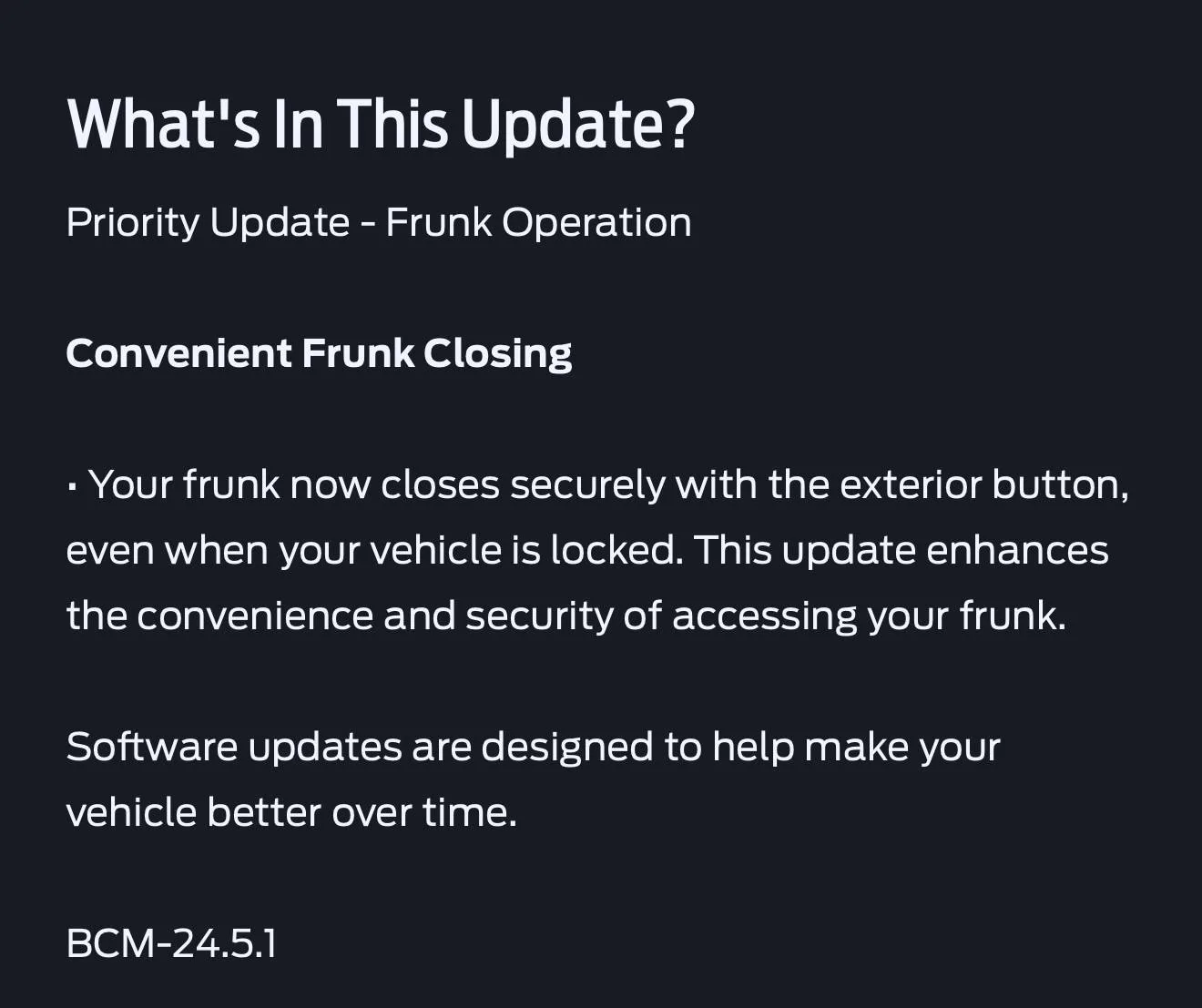

Another one.
My frunk always locked securely before this update. WAL not received, paak, no, blue cruise, no even though I have a Lariat. But I did get this unnecessary update.

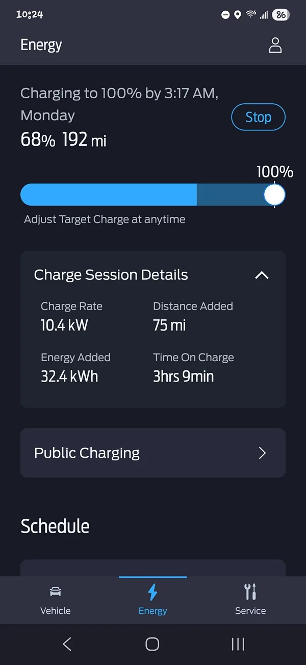

Guess I misread his post. Thought the rate he was giving was for a supercharger (level 3) since he mentioned a tesla station. I can charge at 17kW since I have a 23 ER and fcsp set at 80 amps. Vast majority of 24+ max out at 48 amps, so about 10kW is the max speed you'll see on level 2

I got the update--now the frunk AND tailgate close when the truck is locked...about time. Now for the crazy part. On the first drive I heard a few quiet beeps and saw the passenger side heat go up to max and stayed there. I manually dropped it back down and it stayed. Dunno if it's a byproduct of the update but I hope it was the last time.

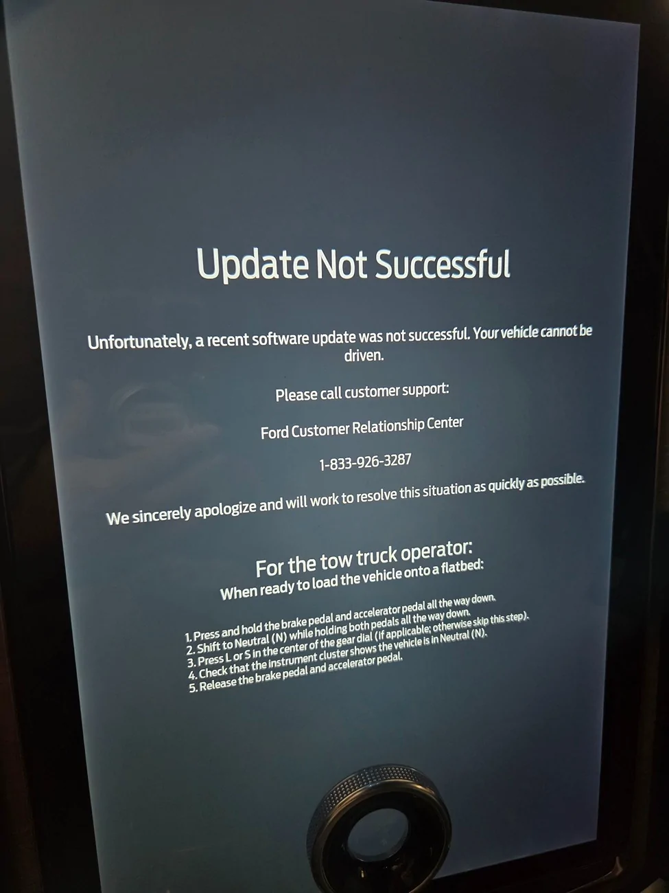

This Frunk OTA bricked my Lightning. It has been at the dealership since August 19th. Getting ready to initiate a buy back.
My suggestion, if you are happy with the way your Lightning is configured, turn off automatic updates.

Yes, when my Lightning bricked it was due to the failed frunk OTA. The attached immediately appeared on the screen. I have been getting the run around ever since I called. Ford just keeps calling the dealership servicedepartment. But my service writer is excellent. We talk every few days. And the conversation is always Ford told us to do this or that or replace this part. When Ford Customer Service calls me with an update, they tell me what i have already heard from my service writer. I don't think Ford Customer Service has ever talked to their technicians that are supposed to be helping the dealership mechanic fix the issues. I get the impression that Ford doesn't know how to fix my Lightning. And it is blatantly obvious that Ford doesn't care.

Wondered about this, I have a 48A charger, so I put the meter on it:
- on the AC side it is pulling 47A at exactly 240V thats 11,280W
- on the DC side it is 10.5kW output meaning I am currently heating my shop with a 780W electric heater - apparently.
Maybe I should check the power factor on the charger...damn got me thinking about this now...

There is quite a bit of heat being generated by the AC/DC on board inverters high power transistors

Yep there's always a power loss via raw heat when converting from one to the other.
