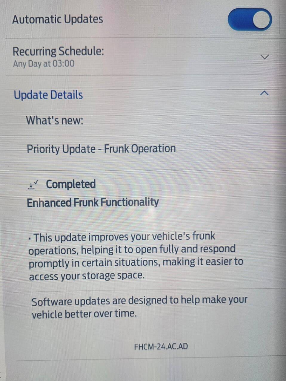

Would love to hear some more detail about what this actually does. Took about 8 minutes and after various noises in both the back and the front, it was all done.
Ford F-150 Lightning Priority Update: FHCM-24.AC.AD - Enhanced Frunk Functionality Screenshot 2025-04-25 150139
240
17,001
19,358
This update has been dormant for some time, might see more trucks get it the coming days.

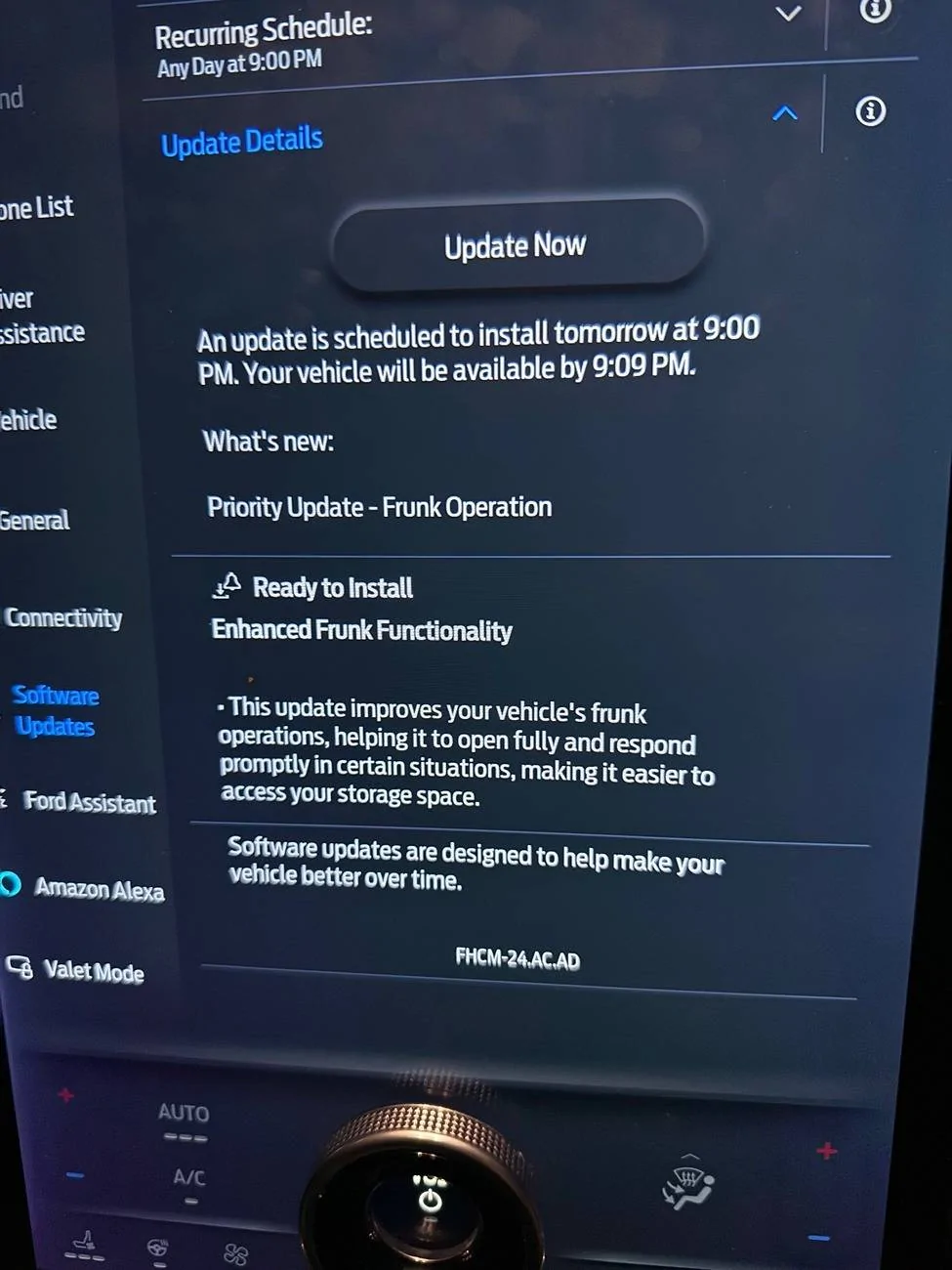

Seeing the excitement in the BC-1.4 thread I go out to the Garage and push the Start button to tell the Mother Ship we're ready for deployment!
Start, check software update screen, recap of prior update, stop, open/close door
Start, check software update screen new update is pending.
