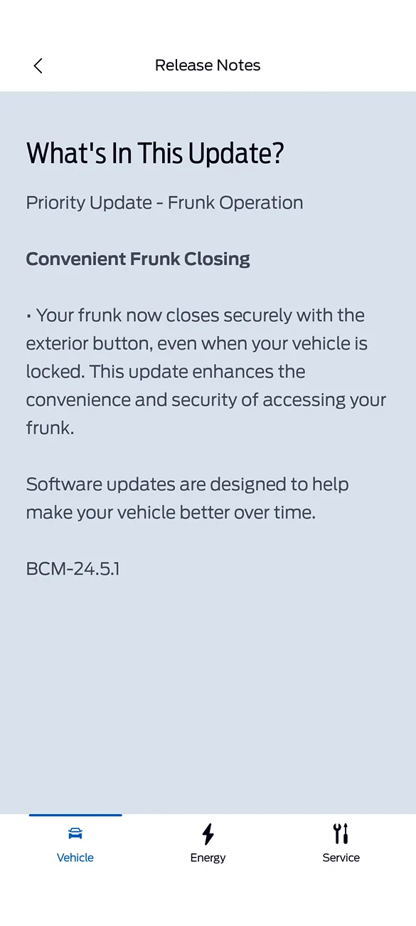

Priority Update - BCM-24.5.1 - Convenient Frunk Closing

I just recieved this update yesterday. Forgive the stupid sounding question but I don't quite understand the Convenient Frunk Closing meaning. It says it closes now when truck is locked. I think my truck did that anyway. Am I overlooking something,?

It would not close with the button on the frunk itself, on XLT at least. You would have to use the fob or the keypad instead. Obviously that's what you would want for *opening*, for security reasons, but closing? Makes no sense.
Honestly that was one of the main "WTF were they thinking" complaints I had about the software, so it's really nice if it's fixed.
