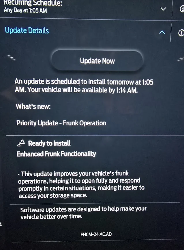

Seeing the excitement in the BC-1.4 thread I go out to the Garage and push the Start button to tell the Mother Ship we're ready for deployment!
Start, check software update screen, recap of prior update, stop, open/close door
Start, check software update screen new update is pending.
Ford F-150 Lightning Priority Update: FHCM-24.AC.AD - Enhanced Frunk Functionality 1755261220833-3f

This morning I talked with my service advisor (whose very into EV’s) and she said the FHCM-24.AC.AD (frunk operation) OTA download took care of the CSP 24P24.
queuewho
Oct 27, 2022
582
638
Western PA
22 F150 Lightning Lariat SR
I had 3 CSPs in my app and they are all gone this morning after the frunk update. No idea if the update fixed them or if they expired.
The one in there was definitely the front sensor issue. I thought that was not fixable by OTA?
Anyhow, frunk opens a bit quicker now, so that's great.

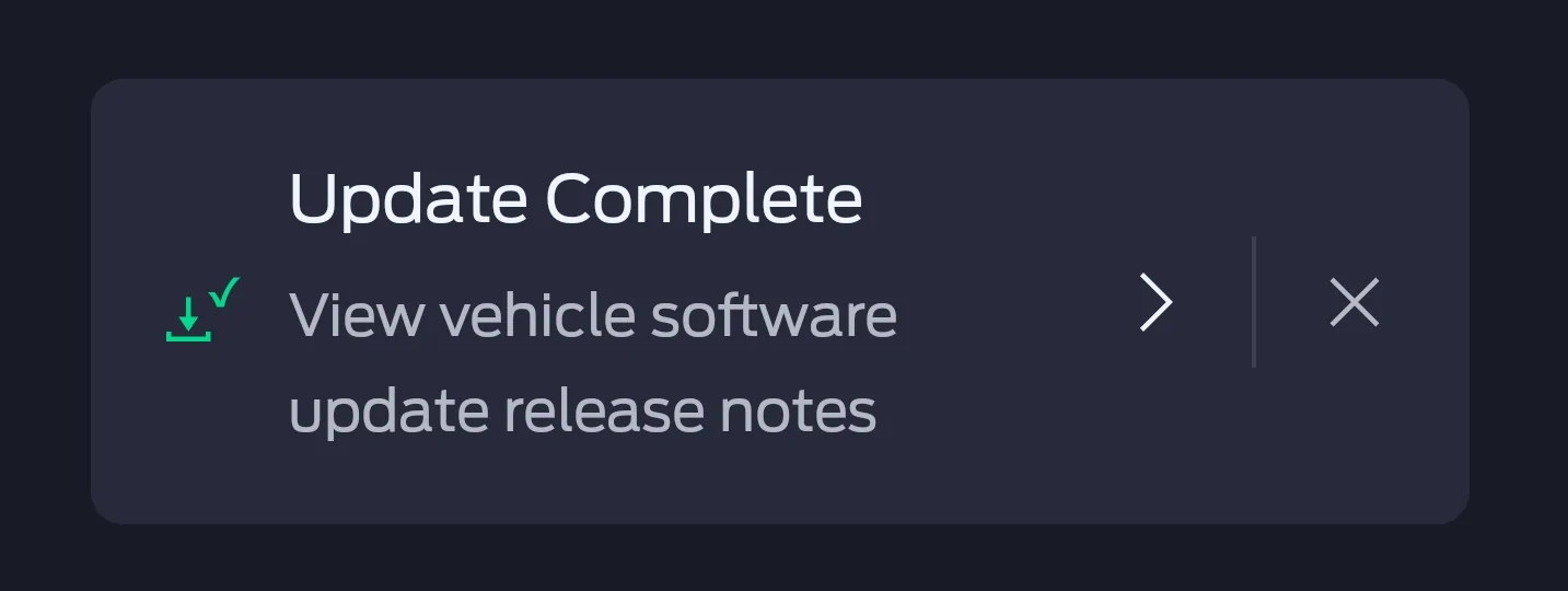

This rolled in today (probably was meant for update Thursday, but the truck has been parked since then)
'23 xlt er 312A
