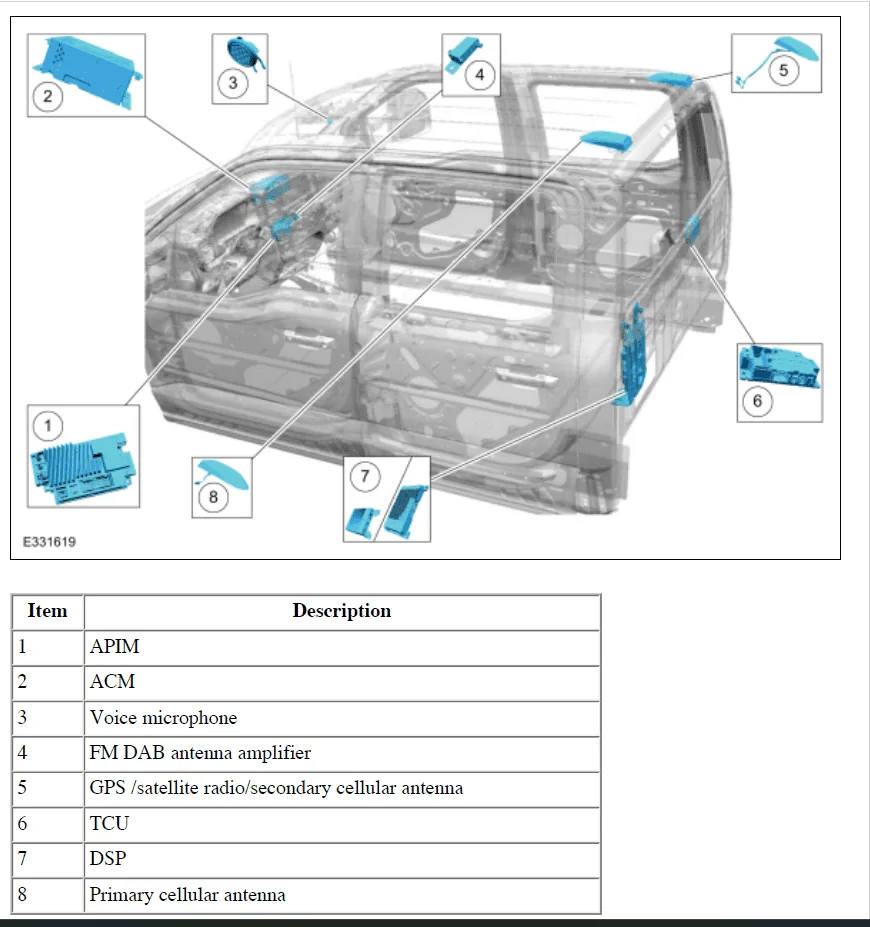

#5 ??

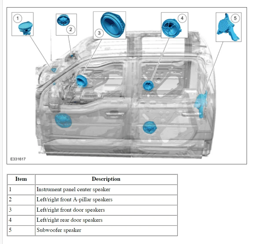

Thanks for the diagram. It’s definitely #7. DSP? ?‍♂
Part of the B&O audio system. There are dozens of modules hidden in your truck. All in plastic cases with lots of wires. You just saw one of them. Your issue is with one you can't see.

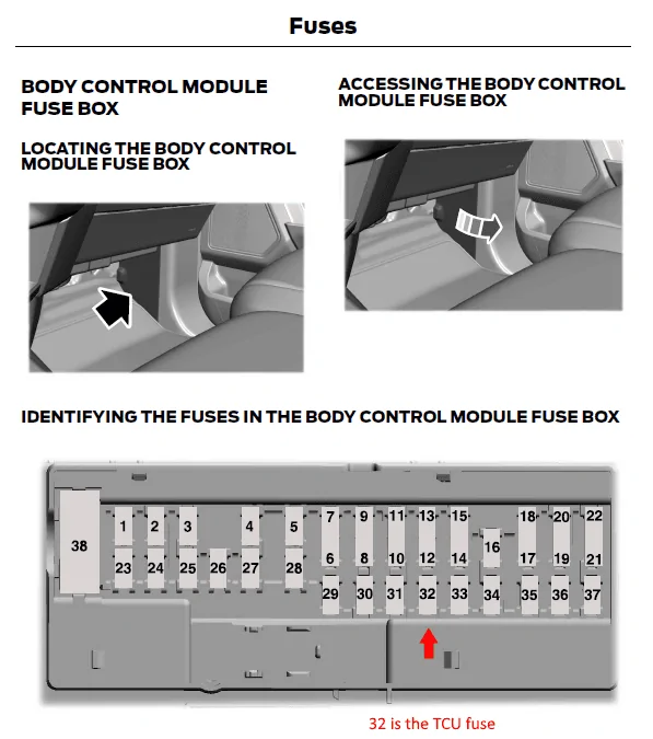

Its a lot easier to just pull the fuse for the TCU for 5 minutes to reset it than figuring out what to unplug behind the back seat.
Ford F-150 Lightning What is the white plastic gadget on the rear wall behind back seat? Lightning_TCU_Fus

Its a 3 section fuse and it is for the TCU and the inclinometer. The 5 amp fuse next to it is a spare and that can into the inclinometer position
