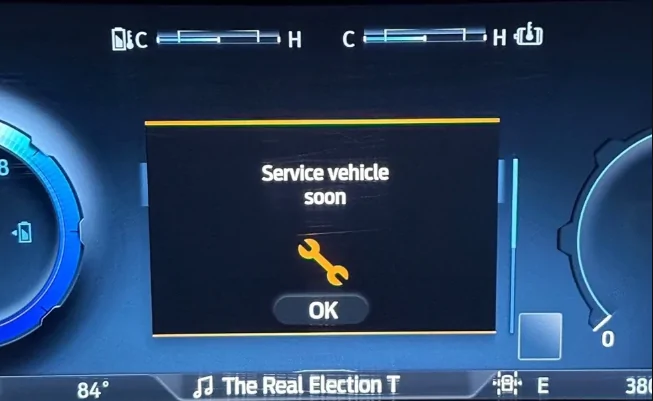

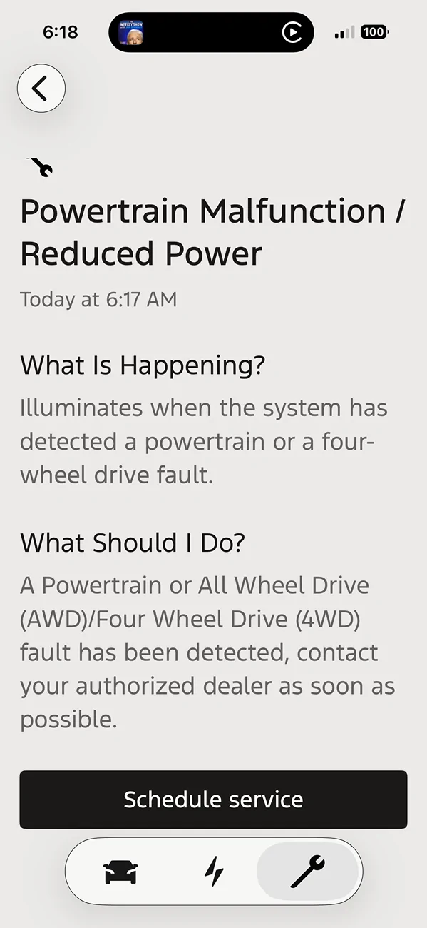

I got in my truck this morning after having it parked all weekend plugged in to find this message. I'm gonna call Ford and "hope" they have someone who knows anything about the Lightning but I figured I'd check here first to see if anyone else has gotten this message and what it might be. I have a '23 ER Lariat, interestingly, this popped up right at the 38,000 mile mark. Could be coincidence?

My guess, based on your location, is that this is the motorized assembly in the shifter failing.
You might notice that the shifter is attempting to automatically return to park even though it’s already in park.
For me whenever I get this error, there’s a slight, repetitive mechanical/gear movement of the shifter as if it can’t determine that it’s in Park and is still trying to shift farther up. These errors started when I was in Los Angeles and went away when I go to a cooler location. And then earlier this week I was in Phoenix and it immediately started throwing these errors. I just replaced the shifter with a rotary dial about 20 minutes ago. I’ll be heading to Phoenix this evening and expect not to see this error again.
After you’ve had the dealer fail to fix it multiple times by replacing the shifter with the same part, there’s a thread on here in which people have discussed how to replace the shifter with a rotary dial.

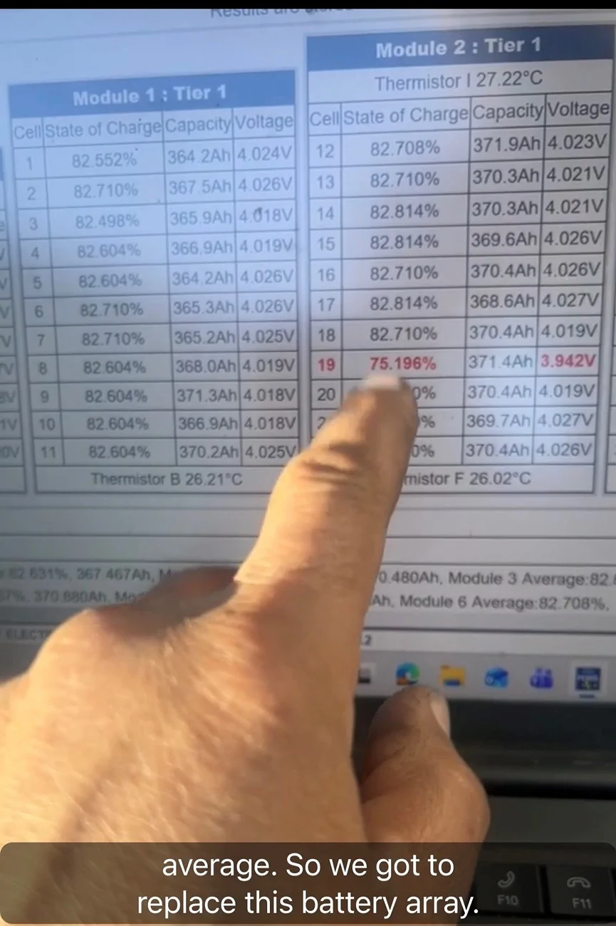

I got a video message from the Ford dealer saying i have a battery module that needs to be replaced. The truck battery percentage is at 79% now on the Ford Pass app. I'm not sure if the 82% showing as state of charge is the battery health or just what the actual "current" state of charge is. I'd like to see a test showing what my HV battery health is.

The cell level SOC's are always higher than your visible SOC on the dash and Ford App.

Yeah, I figured that would be the case but I'm trying to see if the dealer can/will run a test to show me the actual state of health for the high voltage battery since it's already in the shop. Looks like they are gonna replace the one cell that is showing less charge than the others.

Those numbers, the cell voltages, are the SOC of the cells, not the state of health.
To know the state of health (SOH), the present energy capacity vs that when new (100%), you could use CarScanner for example.
