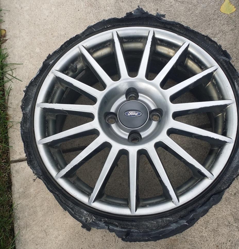

Not a Lightning tire, but here is a picture of a defective tire I had on my Focus. Tires had less than a thousand miles on them. I know the pressure was good because I constantly check it, and my TPMS light wasn't on.
I found the tread section. It rolled past me as I slowed down on the interstate. There were no punctures or deformities I could find.
