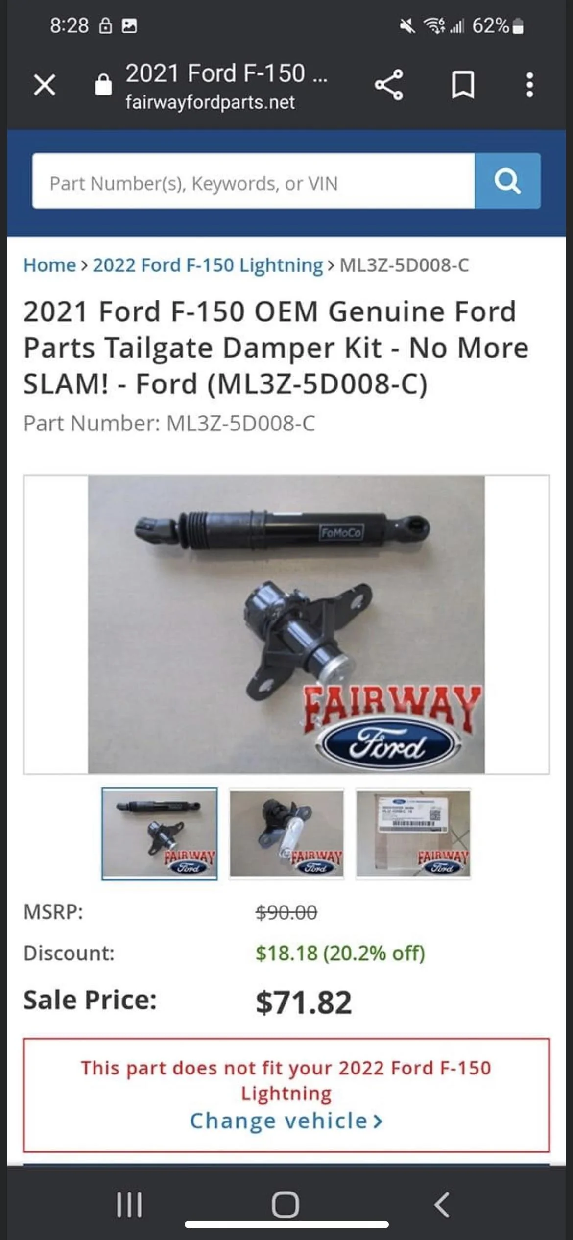

This is what I ordered. Reviews are good with people who have installed it. It’s hidden behind tail light.
have you confirmed this fits the lightning? this sounds like a good use of the $210 ford credits

The damper from the ICE truck will work. After all, the PRO and XLT use the same tailgate as the ICE trucks.
I ordered the part number confirmed to fit by another member who installed it on A Pro. So here’s hoping!
