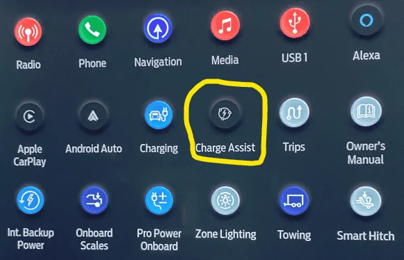

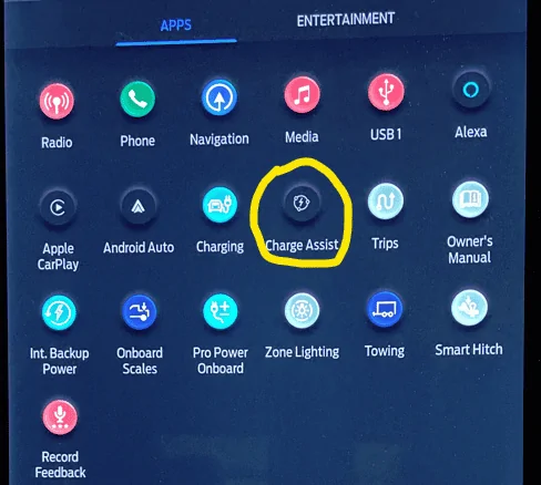

My vehicle does not appear to have a “Charge Assist” app. How does one get this?
Make sure your enrolled in plug & charge, have an active CC on file, possibly this triggers a database to que a software update to your truck, if all this has been done and still no "Charge Assist" see what your dealer service adviser can do to help.

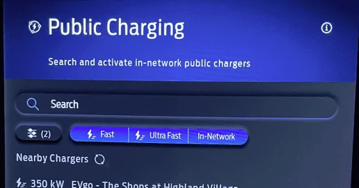

And when it first appeared, it was labeled “Public Charging”, I think.
It was called "Charge Assist". Then, almost immediately, it was renamed "Public Charging". Really well though out...
2,643
3,735
On my Apps screen, it is still called Charge Assist. When I open it up, it is called Public Charging. Is anyone seeing it called Public Charging on the App screen?
I see exactly what you see on the Sync screens......

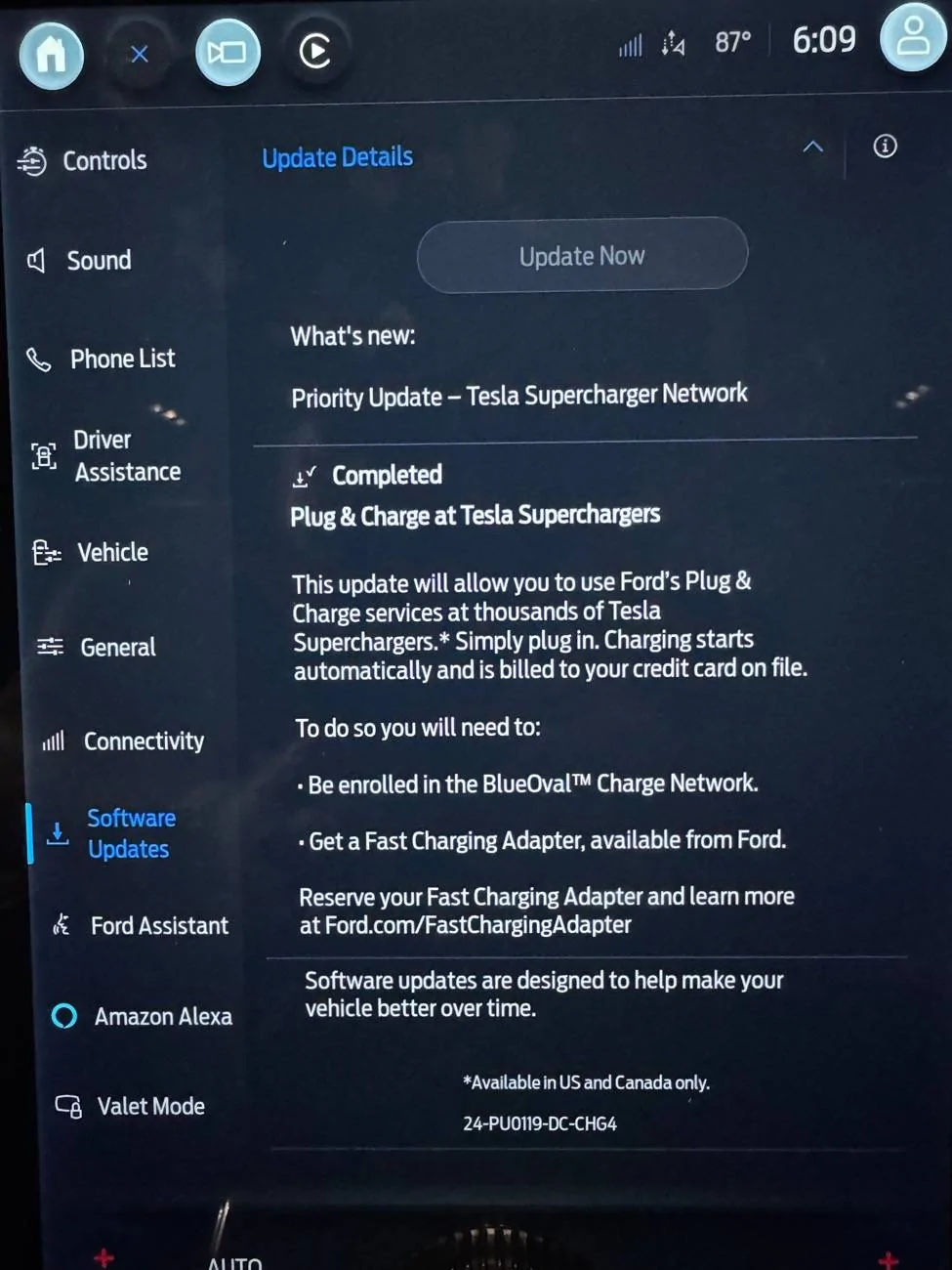

Just received tonight, 24-PU0119-DC-CHG4
Guess will see what it brings and what comes next.
Yesterday I received 6.4.0 before this today….
