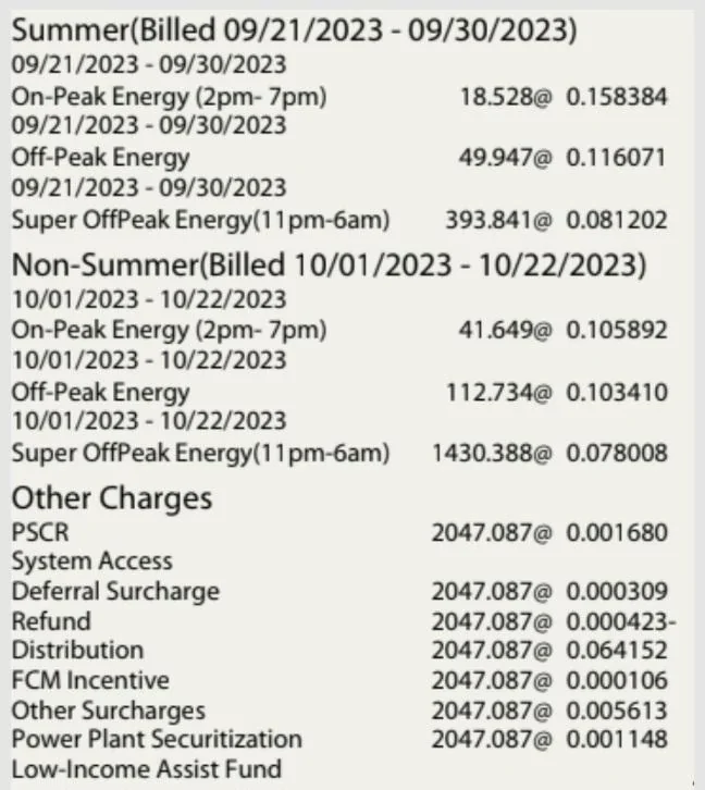

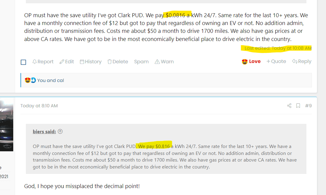

17% of 131kWh is 22.27 kWh added x $.0816/kWh = $1.82 cost to drive 56 miles Is this correct?

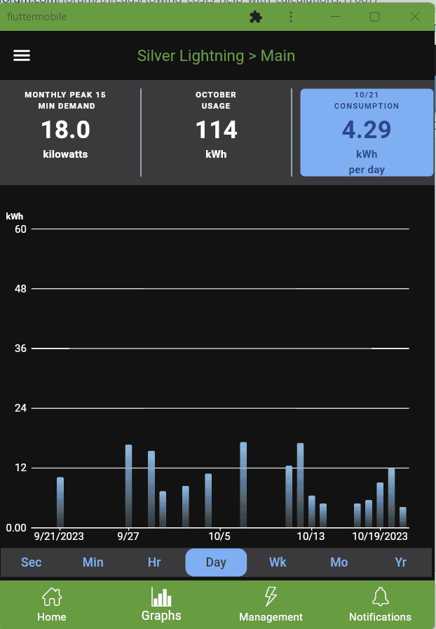

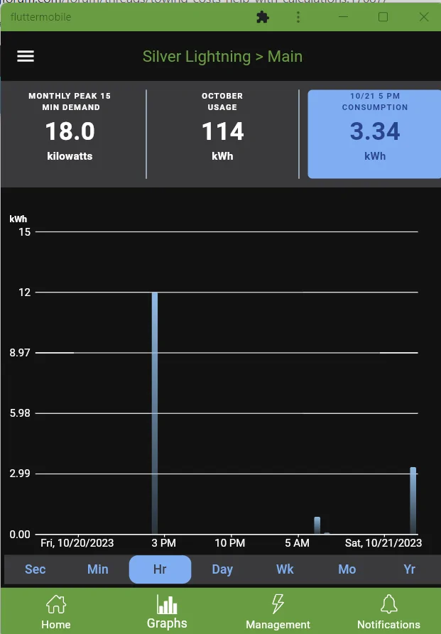

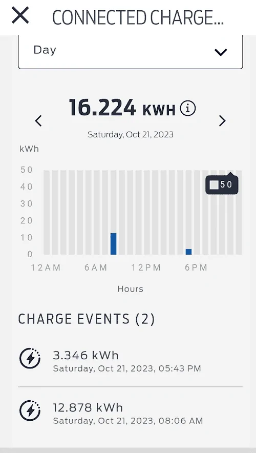

Here's where things get confusing I have two different charge records. One at 10% and another at 16% (can’t find this one anymore)
16% added x 131 kWh =20.96 kWh x $.0816 = $1.71 cost
10% added x 131 kWh = 13.1 kWh x $.0816 = $1.07 cost
This seems really cheap considering the load was two adults and a weight of 1900 lbs plus the weight of the trailer 3000 lbs (total 4900 lbs trip 1 and another 3900 lbs for trip 2
I did not charge over night in between trips. Recharged to 80% Mon Oct 23. I did transport the tractor twice but only about 3 miles total.
At $1.71 or $1 this seems really cheap considering the load I was hauling. Am I doing these calculations wrong?
